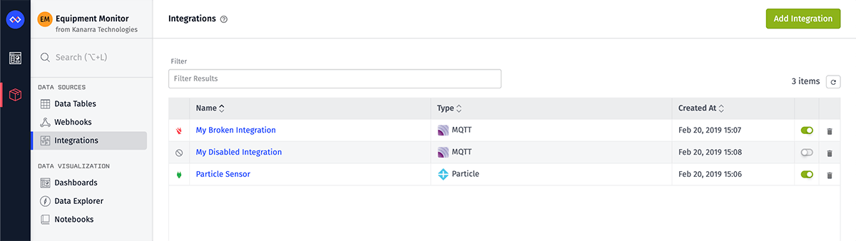

Viewing Integrations​
Integrations List
View your application's integrations under Integrations in the Application menu bar. Icons next to each integration indicate its last known connection status.
Click an integration's name in the list to view its configuration, make edits or view workflows associated with the integration.

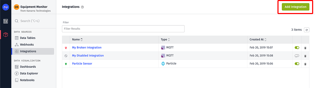

Creating an Integration​
Add Integration
From the Integrations list page, click "Add Integration" in the top right corner. This will take you to a page where you will be able to choose which type of integration to create.

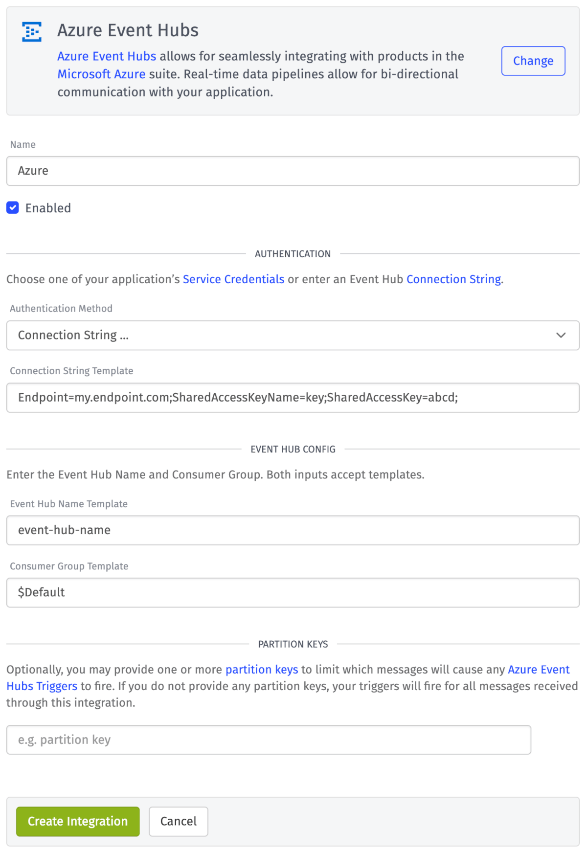

Azure Event Hubs​
An Azure Event Hub integration allows you to trigger workflows by consuming events published to an Azure Event Hub.
Integration Event Hub Config
Azure Event Hubs Authentication​
Choose a method for authenticating the Azure Event Hub integration using the Credential Method dropdown:
  • Service Credential: If selected, these fields are required:
    • Credential Name: A dropdown list of your Azure Service Credentials.
    • Host Name Template: The fully qualified domain name (FQDN) of the namespace that your Event Hub resides in.
  • Connection String: If selected, this field is required:
    • Connection String Template: This is a connection string scoped to either an event hub namespace, or to a specific event hub. You can create an event hub connection string through the Azure Portal. In order to properly connect with Losant, the access policy associated with the connection string must have Send and Listen permissions.
Event Hub Config​
  • Event Hub Name Template: This is the name of the event hub to consume from and send to.
  • Consumer Group Template: This is the name of the consumer group used to consume and send events.
Partition Keys (Optional)​
  • Partition Keys: This allows you to filter the events that this integration receives. Only events with a specified partition key will fire an Azure Event Hub Trigger. If no partition keys are configured, the integration will receive all events consumed from the event hub.
Note: It is not always recommended to use partition keys for your event hub implementation. Read more about partition keys and their recommended usage from Azure.

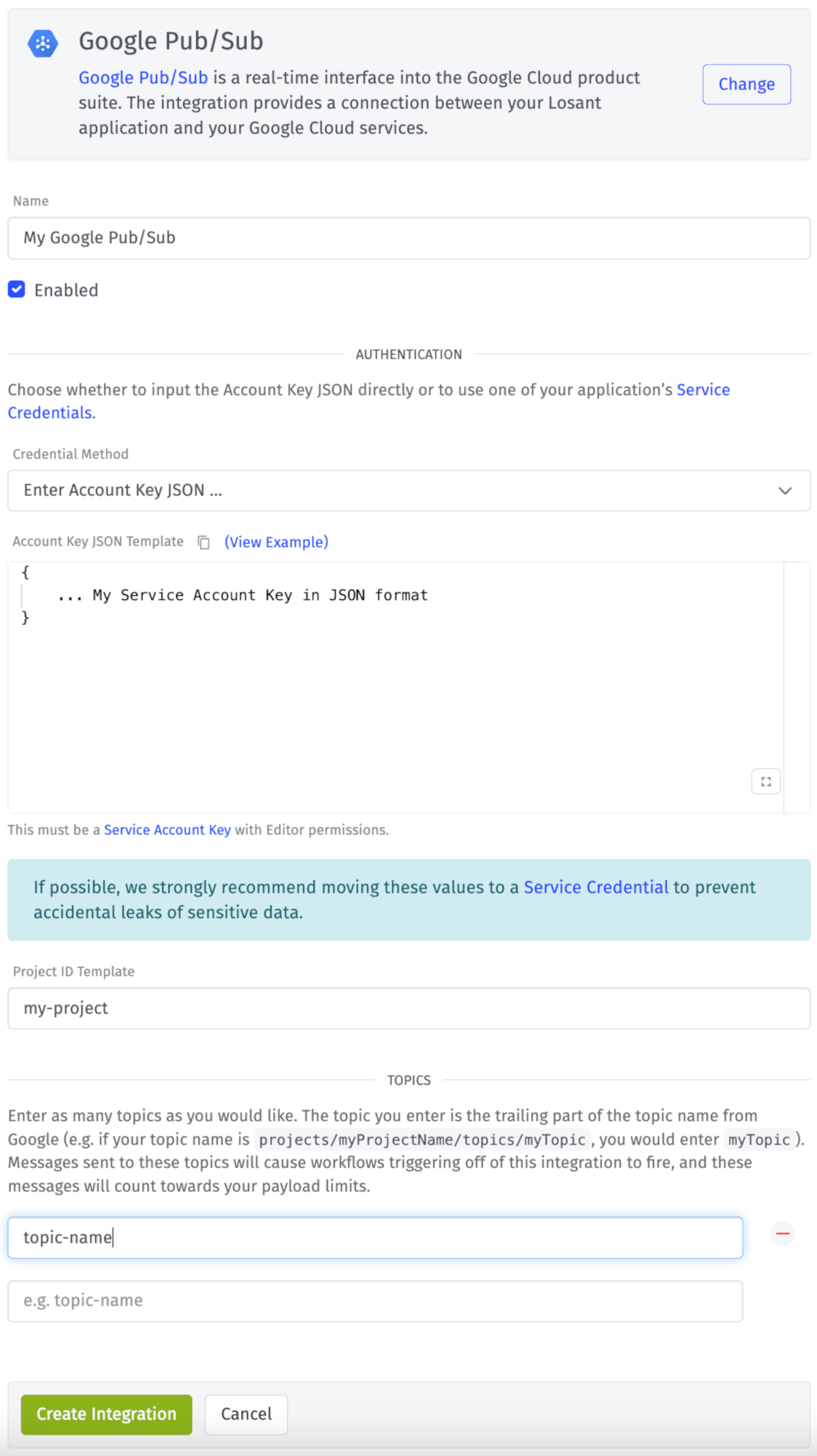

Google Pub/Sub​
A Google Cloud Pub/Sub integration allows you to trigger workflows off of messages going through your messaging middleware. It also allows you to publish to the service via a workflow.
Integration Google Pub/Sub Config
Google Pub/Sub Authentication​
Choose a method for authenticating the Google Pub/Sub integration using the Credential Method dropdown:
  • Service Credential: If selected, this field is required:
  • Account Key JSON: If selected, these fields are required:
    • Account Key JSON Template: A JSON object in the format of a Service Account Key. There are a few validation rules on the object's properties; it is recommended you copy the key directly from your Google Cloud account and paste it here. Note: This is only required if Account Key JSON is selected as a Credential Method. The key should have the Pub/Sub Editor role - roles/pubsub.editor - because it needs to be able to create subscriptions.
Project ID (Optional)​
  • Project ID Template: This represents the ID of your Google Cloud Platform project. If left blank, the integration will use the default Project ID associated with your provided service account key.
Topics​
  • Topics: Enter one or more topics to subscribe to. Any workflows triggering off of this integration will fire anytime a message is received on one of these topics. The topic you enter is the trailing part of the topic name from Google. For example, if your topic name is projects/myProjectName/topics/myTopic, you would enter myTopic. Note: It is not necessary to subscribe to a topic in order to publish to it in a Google Pub/Sub Output Node.

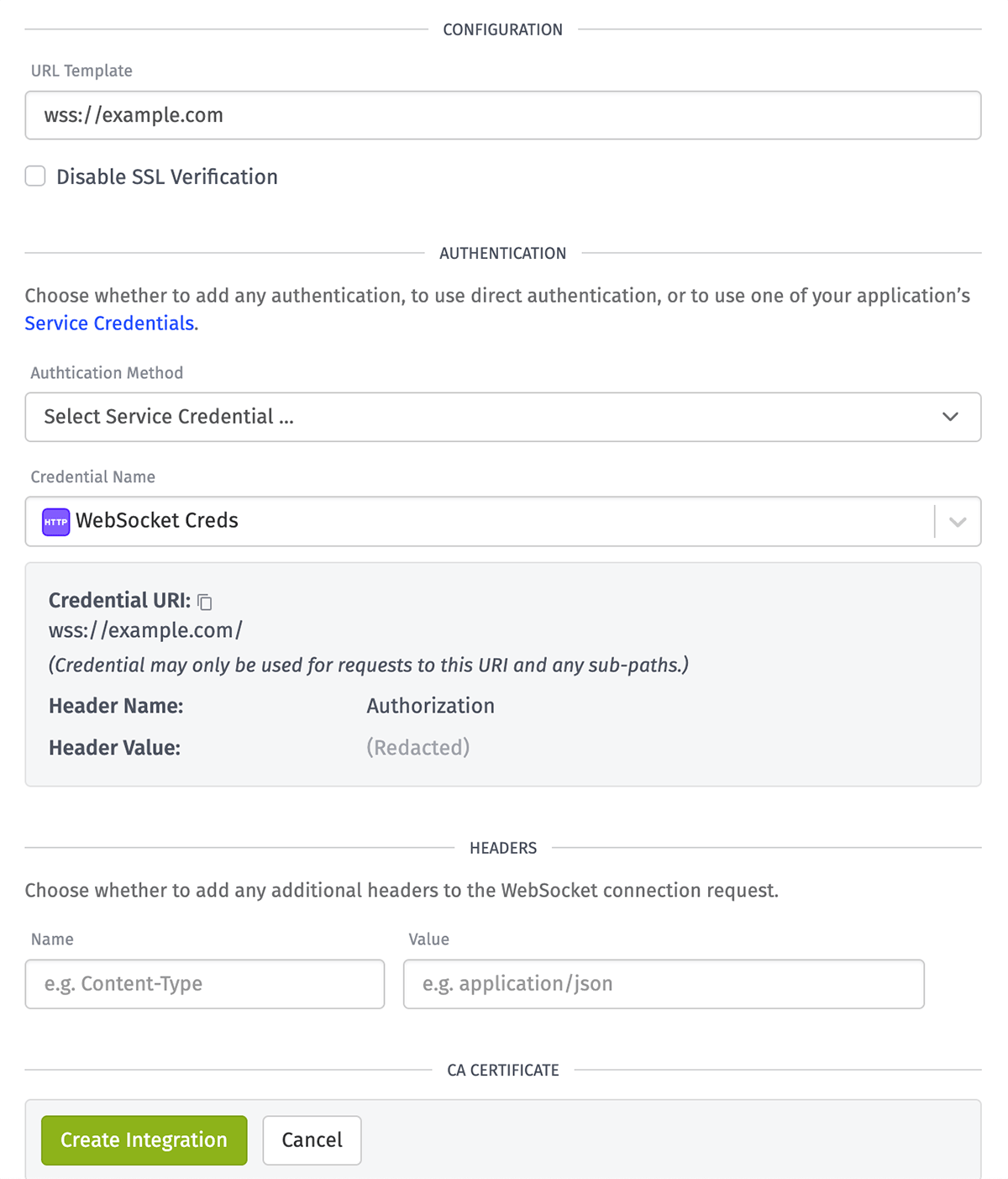

WebSocket​
A WebSocket integration allows you to establish a client connection to any server that supports WebSockets. You can then trigger workflows on messages received from the server and send messages to the server over the open connection.
Integration WebSocket Config
  • URL Template: Provide the full URL to the WebSocket server you wish to connect to, including the full resource path and any query parameters. This must start with either ws:// or wss://, and it must be a valid URL.
  • Disable SSL Verification: If checked, the WebSocket server's SSL certificate will not be verified against known certificate authorities, and you will not be able to provide a custom CA certificate for verification.
Authentication​
Choose a method for authenticating the WebSocket request, if necessary.
  • None: Select this option if the WebSocket client connection does not require authentication.
  • Select Service Credential ...: If authentication is necessary, Losant strongly recommends storing the information in an HTTP Service Credential. Select this option to use a credential, and then select the Credential Name to use for authentication. (Note: Only HTTP credentials whose URIs begin with ws:// or wss:// can be selected.)
  • Username and password: If the WebSocket server uses basic authentication, select this option and then enter the Username Template (optional) and Password Template (required) to connect to the server.
  • Private Key and Certificate: Select this option if the server authenticates using a client certificate. When selected, you must enter your client's Private Key Template and Certificate Template.
If authentication is accomplished through an HTTP header - such as with a Bearer Token - then select the "None" option here and provide the appropriate header in the Headers section. (However, Losant recommends storing that information in an HTTP Service Credential for security.)
Headers​
Optionally, provide additional HTTP headers to include in the WebSocket integration request as Name / Value pairs. Note that you may not include headers that conflict with your chosen authentication method; for example, you may not provide an "Authorization" header when selecting the "Username and password" authentication option, as that method already makes use of the "Authorization" header.
CA Certificate​
If the WebSocket server uses a self-signed certificate or a certificate from a non-standard certificate authority, you must provide a CA Certificate Template so that Losant can authenticate the request.
Note: This section will not display if the Disable SSL Verification checkbox is checked.

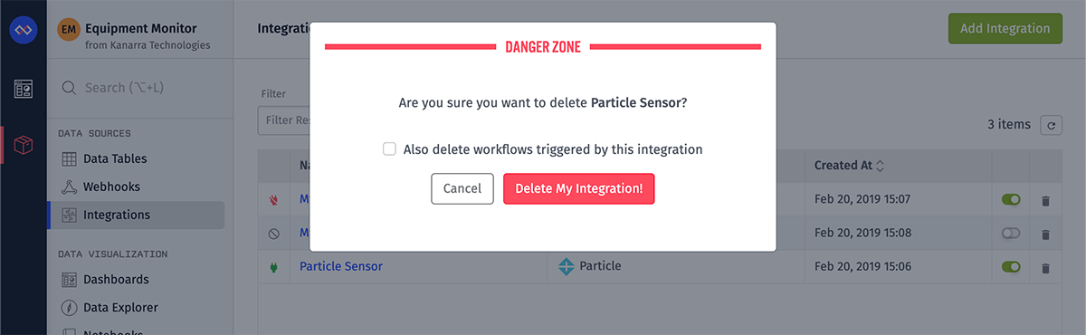

Deleting an Integration​
An integration can be deleted by clicking the "Delete" icon next to any item on the list page, or by clicking the "Delete" button in the footer of an integration's edit page.
Delete Integration
When deleting an integration, you also have the option of deleting any workflows triggered by that integration. Note that this action deletes any workflow with a trigger matching this integration. If you wish to save your workflows and change out their triggers, or if the workflows are triggered by multiple conditions and you wish to retain them, you should leave this option unchecked.
