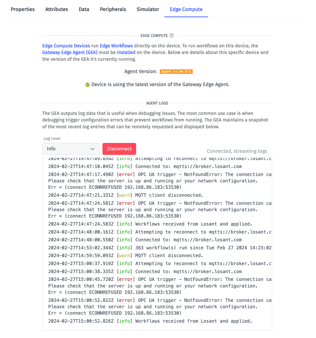

$ tail -f /var/lib/losant-edge-agent/data/losant-edge-agent-log.log
0000-00-00T00:00:00.000Z [info] Agent Starting...
0000-00-00T00:00:00.000Z [info] Connecting to: mqtts://broker.losant.com...
0000-00-00T00:00:00.000Z [info] Webserver started on port: 8080
0000-00-00T00:00:00.000Z [info] Workflows initialized and running...
0000-00-00T00:00:00.000Z [info] Connected to mqtts://broker.losant.com

You can optionally add an out
destination, which allows you to choose where the log output is sent as seen in GEA Configuration Options. (Note: If your out
destination is a file path, you may fill up your device’s disk space with log files.) Without an out
destination, the log output is recognized by Docker and allows you to view the Gateway Edge Agent’s logs with docker logs <container-name>
command.
Then restart the Gateway Edge Agent to have the GEA pick up our new configuration changes.
docker restart docs-agent
