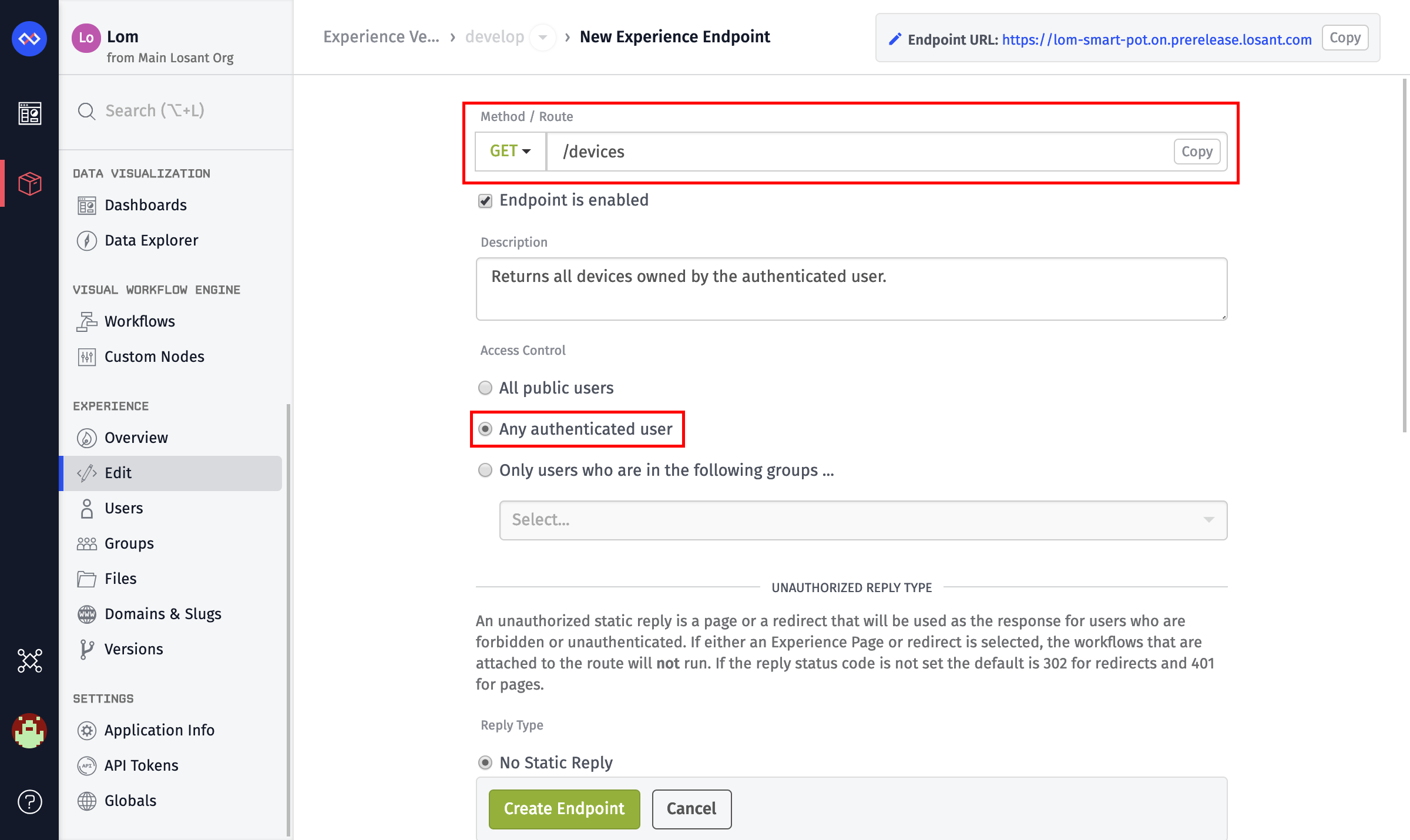

Step One: Create First Endpoint
The first endpoint you’ll create is GET /devices
, which returns a list of all devices owned by the currently authenticated user:
- Set the
Method
toGET
. - Set the
Route
to/devices
. - Add a
Description
. - Set the
Access Control
toAny authenticated user

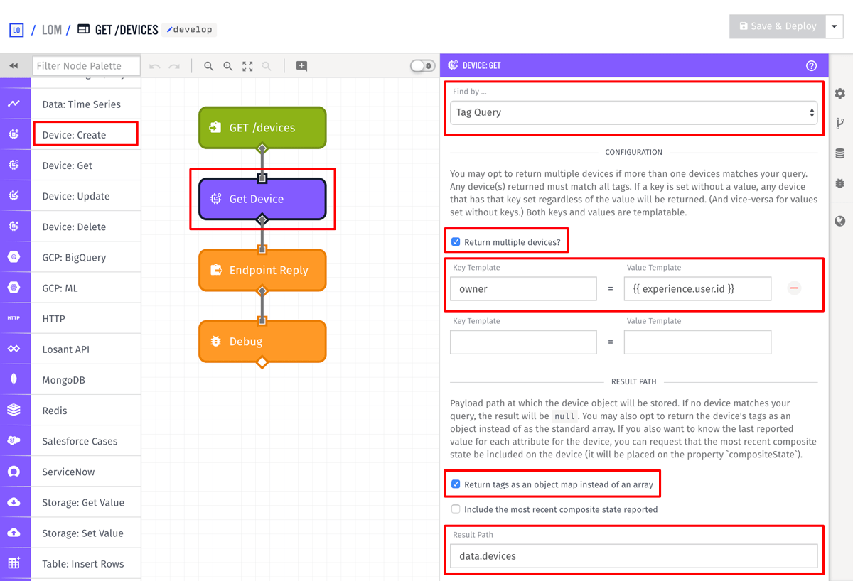

Like all endpoints you’ve created, this one also needs a workflow with a matching endpoint trigger. Next, add a Get Device node that you’ll use to look up the user’s devices:
- Set
Find by...
toTag Query
. This allows you to query devices by their tags. - Check the
Return multiple devices?
checkbox. - Add a tag query and set the
Key Template
to “owner” and set the value template to{{ experience.user.id }}
. - Check the
Return tags as an object map instead of an array
checkbox. This changes how tags to an object map. - Set the
todata.devices

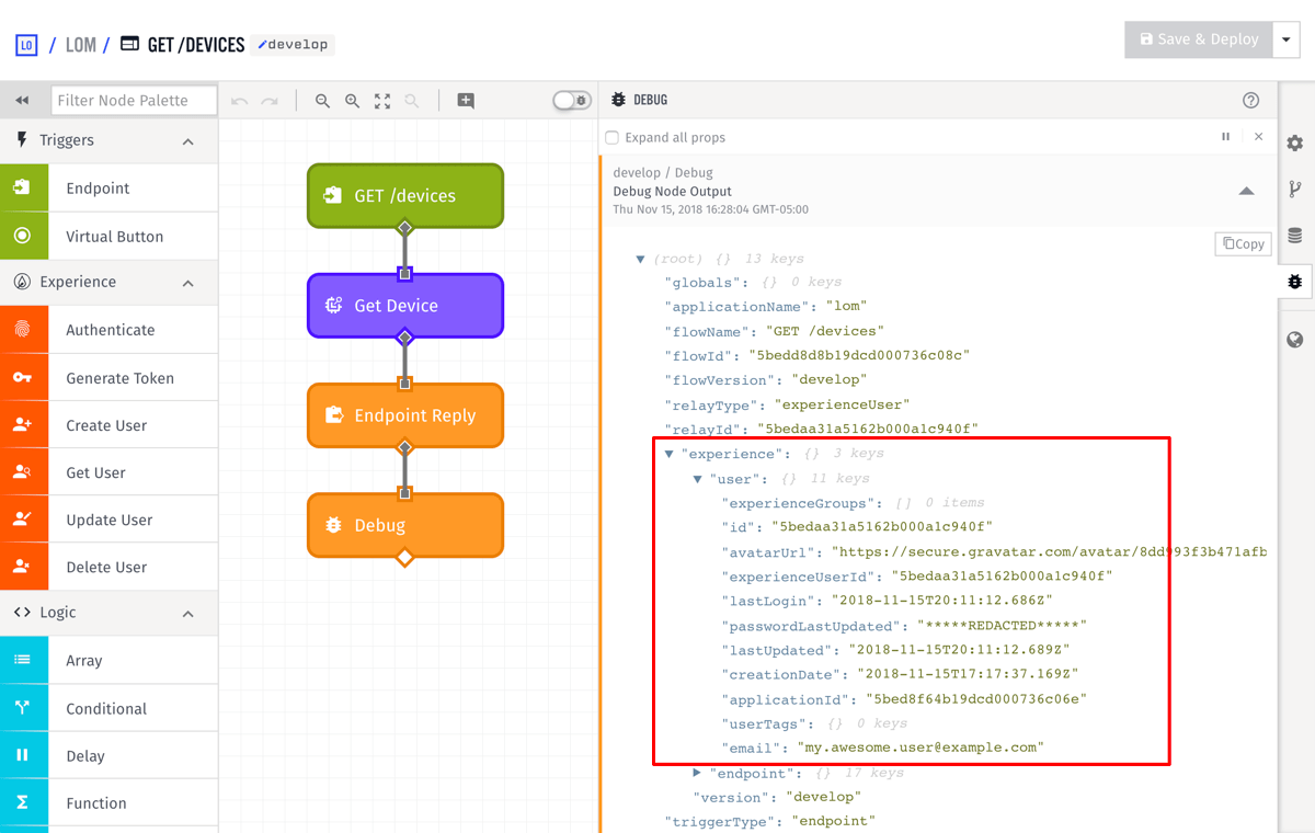

In Part 3 of this walkthrough, you learned how devices were tagged with the owner when they were created. You can now use this tag to find all devices owned by the user that requested this endpoint. Losant automatically adds the Experience User to the payload whenever an authenticated route is requested, so you can get the user ID at experience.user.id

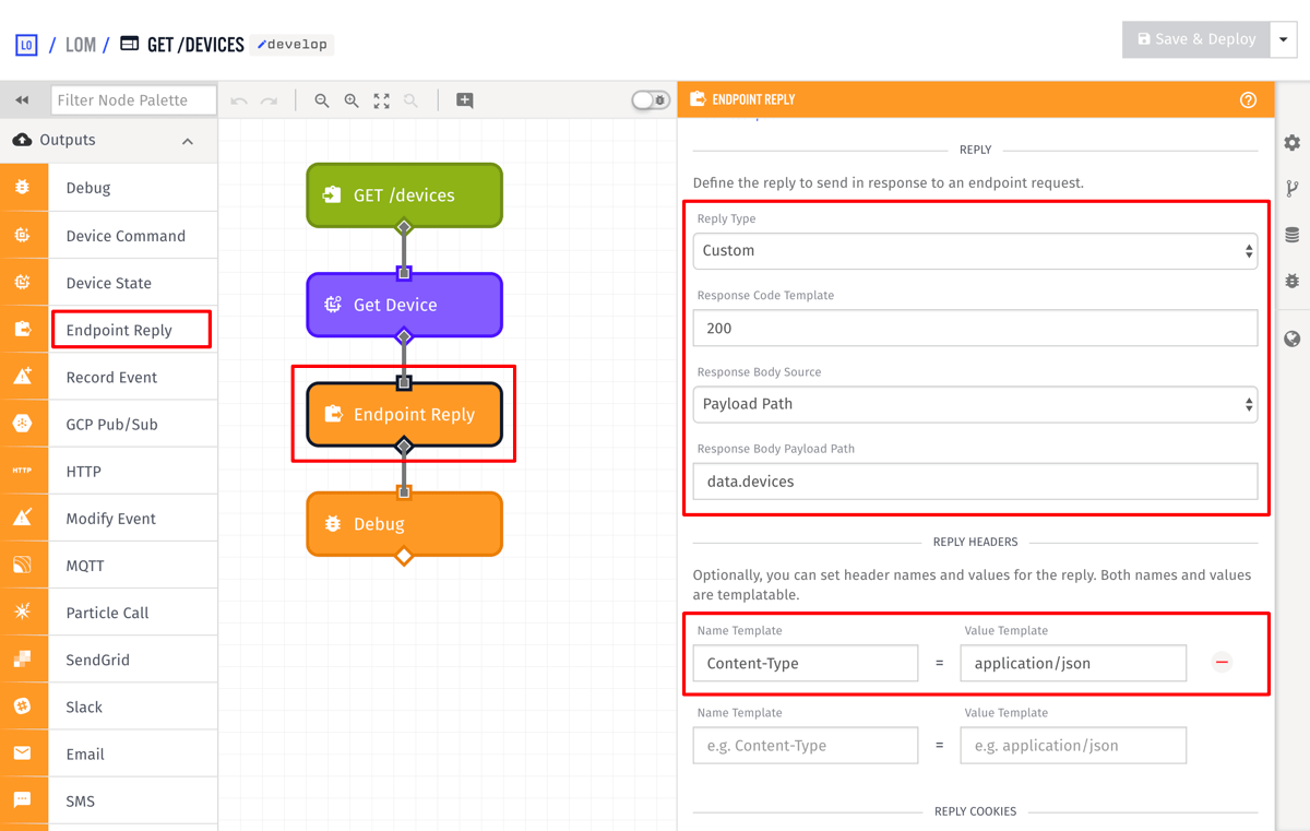

All that’s left to do for this endpoint is to reply with the devices you just looked up.
- Set the
Response Code Template
to200
, which is the HTTP status code for OK. - Change the
Response Body Source
radio toPayload Path
. - Change the
Response Body Payload Path
todata.devices
. This is the location on the payload where the Get Device node put its result. You’re going to reply with the same value. - Add a
Content-Type
header with the valueapplication/json
At this point, the lōm mobile app can now request all of the devices owned by the currently logged-in user. You can test this route by requesting the devices created in Part 3 of this walkthrough.

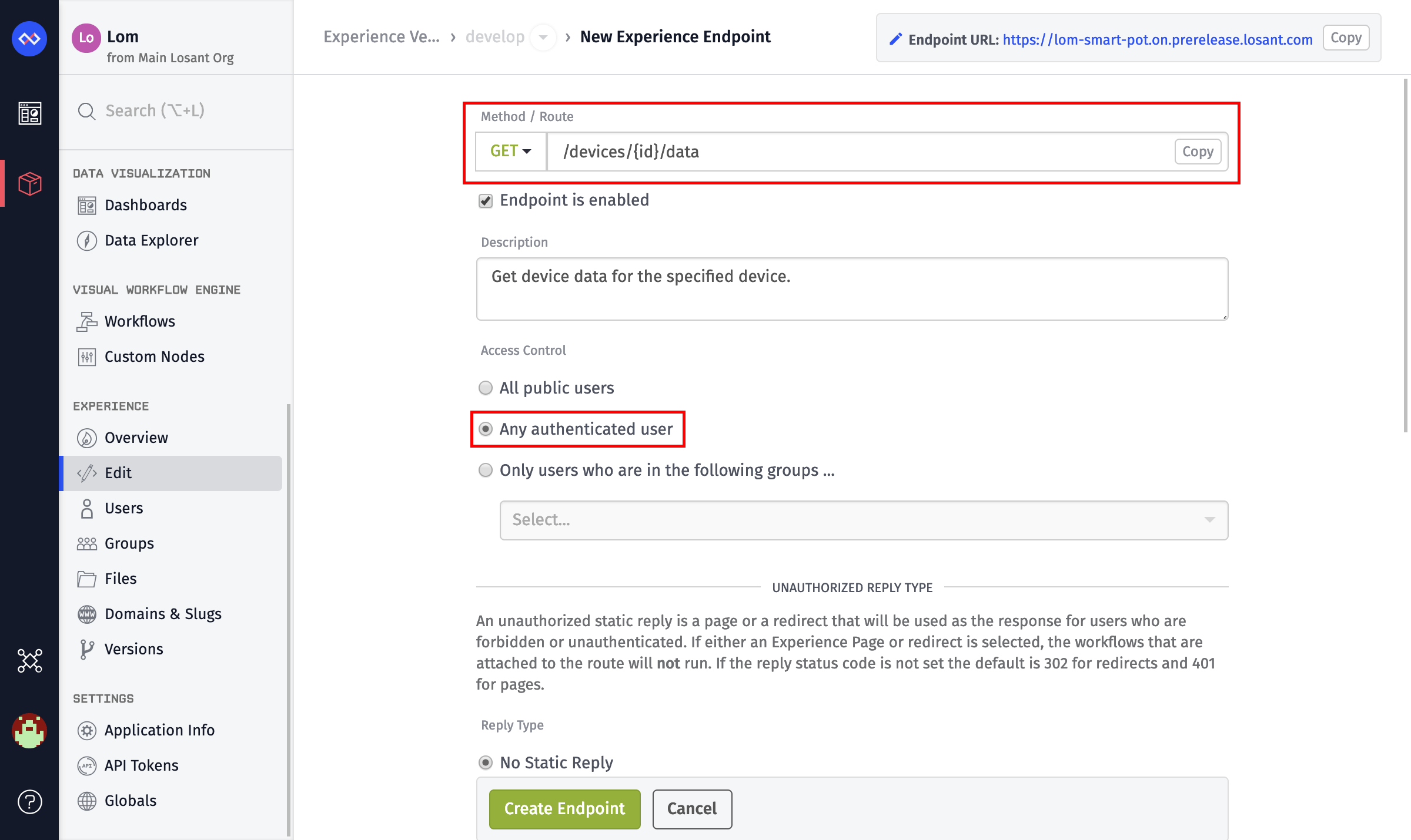

The lōm mobile app now allows the user to select a device from the list to show historical moisture data collected by that device. To support this, you need to create a new endpoint to get this data. You can call it GET /devices/{id}/data
. To create the endpoint:
- Set the
Method
toGET
. - Set the
Route
to/devices/{id}/data
. This route makes use of route parameters, which provide a way to pass variables to the endpoint. In this case, you’ll be passing the Losant device ID. - Set the
Access Control

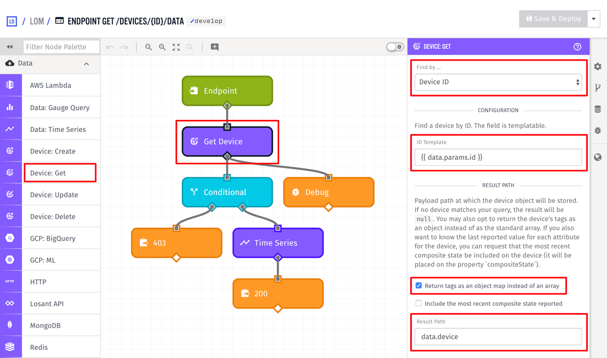

First, add a “get device” node to the canvas:
- Set the
ID Template
to{{ data.params.id }}
. - Check the
checkbox. - Set the
todata.device

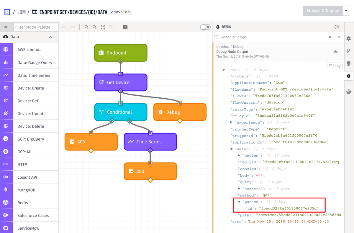

Losant automatically parses the route parameters and puts them on the payload. In this case, our device ID parameter id
can be found at data.params.id

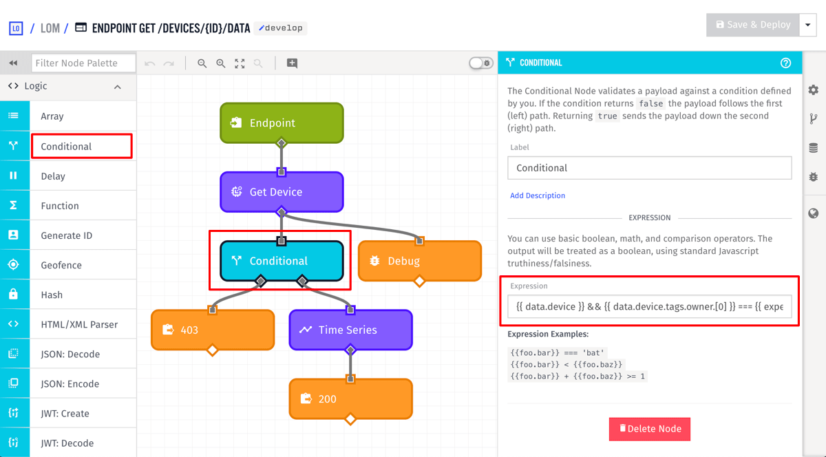

The next step is to add a Conditional node to check that this device has an owner tag that matches the current user.
Set the Expression
to the following:
{{ data.device }} && {{ data.device.tags.owner.[0] }} === {{ experience.user.id }}
This expression first checks if any device was returned at all. Since this route could be requested with any value as the ID, for example /devices/not-a-real-value/data
, the result of the Get Device node could be null
. It then checks that the value of the owner tag matches the current Experience User. Since Losant devices can have duplicate values for the same tag, the values are always returned as an array, which is why the syntax is data.device.tags.owner.[0]
If the device can’t be found, or the owner tag doesn’t match, use an Endpoint Reply node to respond with a 403 (Forbidden).

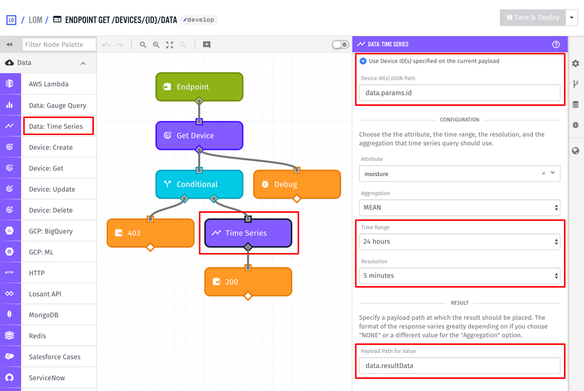

If you did get a valid device ID, you can now use the Time Series node to request historical data for the device:
- Select the
Use Device ID(s) specified on the current payload
radio. - Set the
Device ID(s) JSON Path
todata.params.id
. This performs a time series query against the device that was passed in through the route parameters. - Set the
Time Range
to a range that makes sense for the application. In this example, it is showing the last 24 hours of data. - Set the
Resolution
to a value that makes sense for the application. In this example, it returns 24 hours of data with a data point for each 5 minute interval. - Set the
Payload Path for Value
todata.resultData

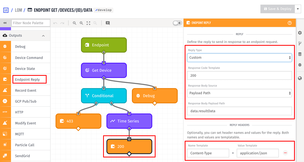

The Time Series node provides powerful aggregation support for data that has been reported by your devices. The duration, resolution, and aggregation can all be changed to match your desired result. The last step is to reply with this data using an Endpoint Reply node:
- Set the
to200
, which is the HTTP status code forOK
. - Change the
. - Set the
todata.resultData
. This where the Time Series node put its result, so this reply sends the result back to the client. - Add a
Content-Type
You can now test this endpoint to see data that has been reported by your application’s devices.
