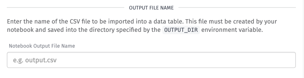

Selecting A Data Table Output
First, configure which CSV file to save to your Application Files by entering the name of the file as it is saved to your designated OUTPUT_DIR.
Notebook Outputs Data Table File Name

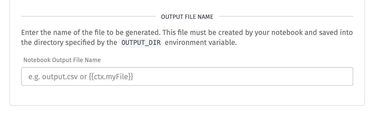

Custom File
Custom File outputs allow you to save any custom file created by your notebook into your Application Files. This file must be created by your notebook and saved into the directory specified by the OUTPUT_DIR environment variable in order to be saved.
The inputs for configuring location directories and file names support templates.
Notebook Outputs Custom File

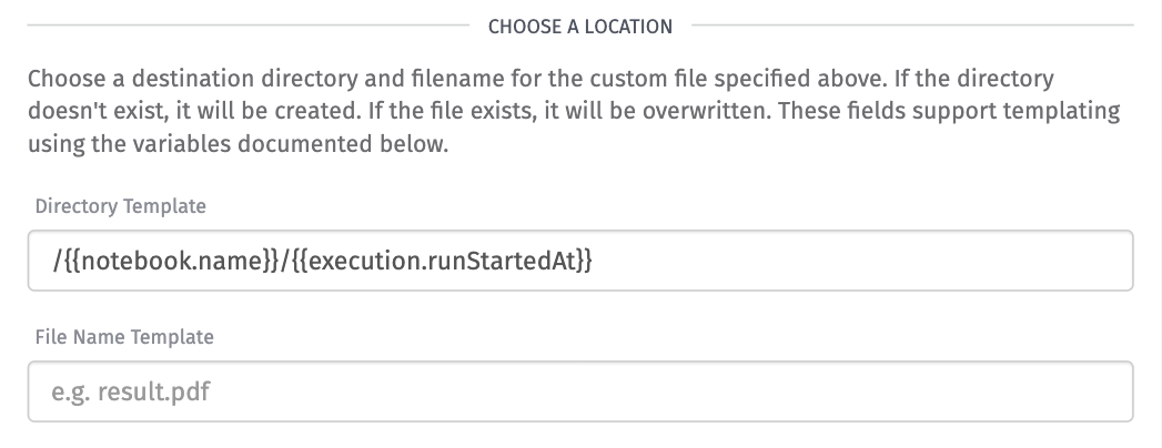

Configuring File Locations
In order for a custom file to be saved to your Application Files, you must also designate a directory inside of your application for the output to be saved too as well as the file name that the output will be saved as.
Notebook Outputs File Location Inputs

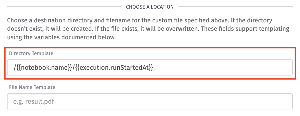

Configuring File Directory Templates
This is the directory pathname where your output will be saved in your Application Files. If the directory that you enter doesn’t already exist, a new directory will be created. The default value of the template will place your file inside a directory with the name of your notebook and then inside of a sub-directory of the time when the execution started.
Notebook Outputs File Location Inputs Directory Template

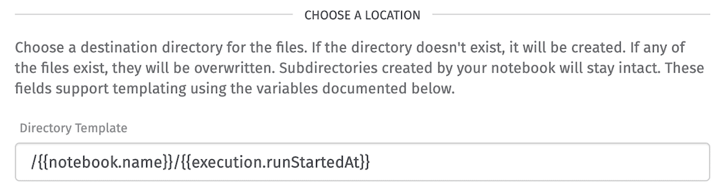

Directory outputs allow you to save multiple files from a directory created by your notebook into your Application’s Files. This directory must be created by your notebook and saved into the directory specified by the OUTPUT_DIR environment variable.
The input for configuring location directories supports templating.
Notebook Outputs Directory Name

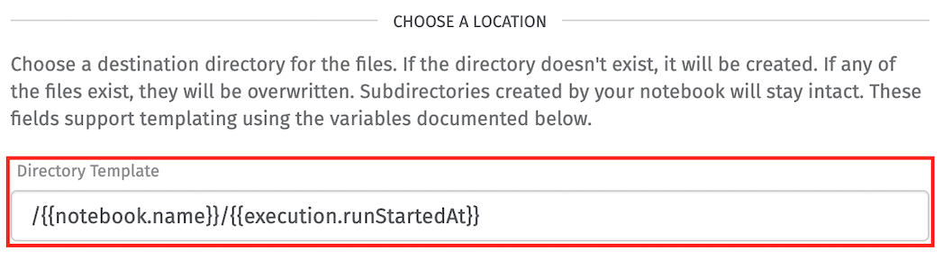

Configuring Directory Templates
Note: If the directory contains subdirectories they will also be created at this location along with the files contained within the subdirectories.
Notebook Outputs Directory Location Inputs Directory Template
