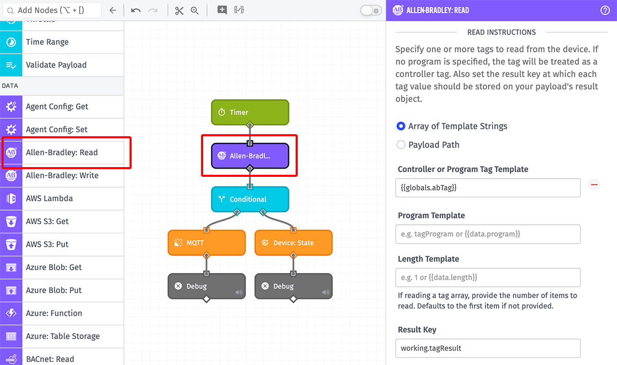

Read Instructions
You may define multiple read instructions for the Allen-Bradley: Read Node, and you must define at least one. Instructions may be defined individually as string templates, or as a payload path pointing to an array of instruction objects.
When defining instructions individually, each instruction has the following fields:
- Controller or Program Tag Template: (Required) A string template defining the tag to read.
- Program Template: (Optional) A string template for the program which your program tag is a member of. In case of a controller tag (above) leave this blank.
- Data Type: Atomic (SINT, INT, DINT, REAL, BOOL) or STRING. When giving read instructions via a payload path the only valid data types are 'atomic' or 'string'.
- Note: This option is removed and has no effect in GEA version 1.54.0 or higher.
- Length Template: If reading a tag array, provide the number of items to read. Defaults to the first item if not provided. If a value greater than 1 is provided and the tag being read is not an array, the read instruction will fail.
- Note: This option is only available in GEA version 1.54.0 or higher. In prior versions, the operation will only return the first item when reading an array.
- Result Key: (Required) The key at which to store the result of this read operation. This key will exist on the Destination Path defined below the instructions. This can be any string except
errorsorplcProperties, since these keys are reserved additional output.
When defining instructions as a payload path, the path should point to an array of objects on your payload, with each object having the following keys (corresponding to the fields described above) ...
tagprogramtypelengthkey
Note: The option to define instructions as a payload path is only available in GEA version 1.19.2 or higher.
