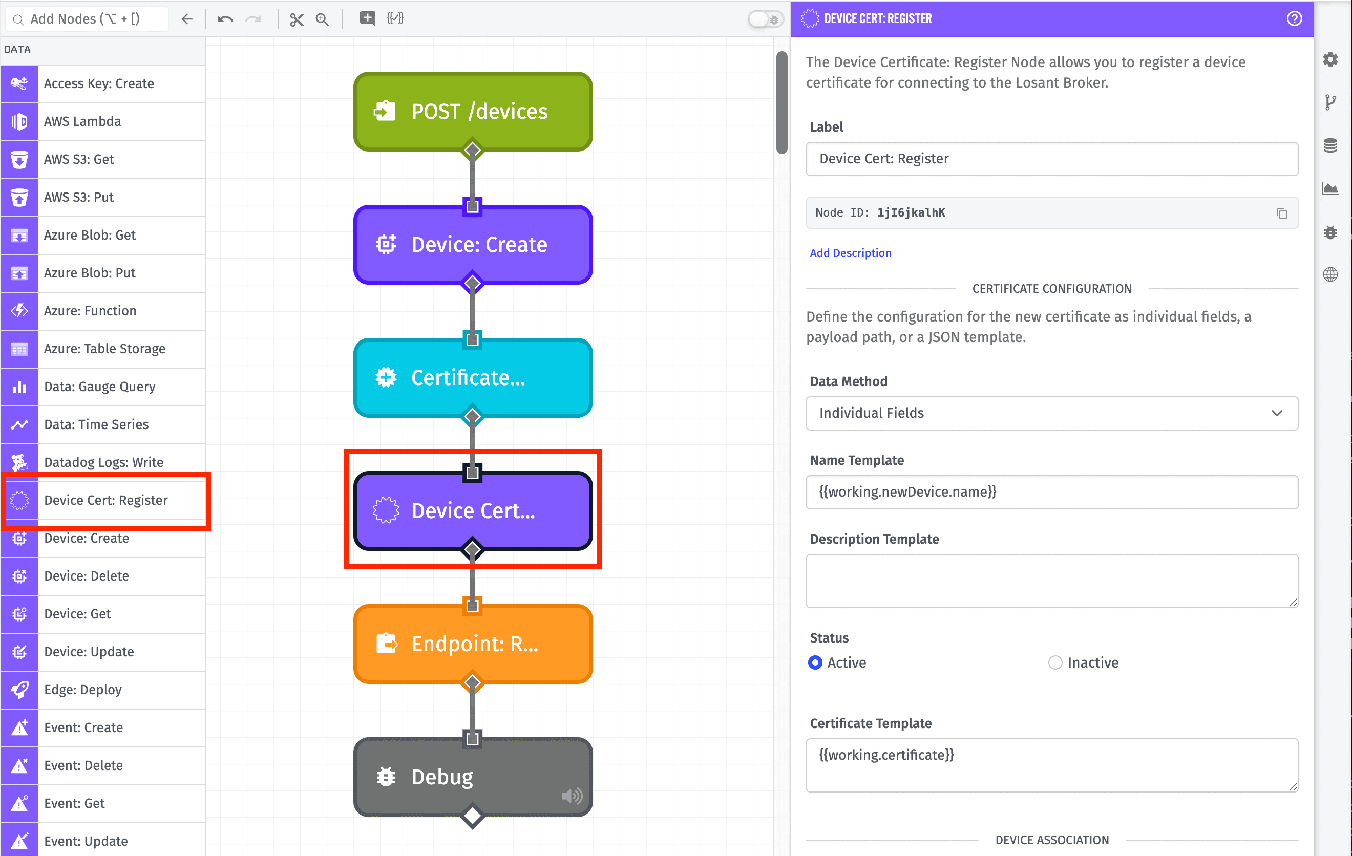

Start by choosing how you wish to configure your new device certificate. Choose one of the following options in the "Data Method" dropdown:
When choosing the "Individual Fields" option, there are a few fields that must be configured.
Certificate Configuration​
You may optionally provide a Name Template and Description Template for the new certificate. Both fields support string templates for dynamic values. Neither field is required, and the values do not affect the certificate's functionality. If no name is provided, the certificate's name will be automatically set from the common name on the certificate itself (or the serial number if no common name is present).
You may also optionally set the certificate's Status to either active (default) or inactive. An inactive certificate will not be accepted for authentication against the MQTT broker.
The Certificate Template is required and must resolve to a valid PEM-encoded certificate that meets all device certificate requirements:
  • Must be signed by a certificate authority configured in the application
  • Must include the ExtendedKeyUsage.clientAuth extension
  • Must not be a CA certificate
  • Must not be expired
The field supports string templates. The Certificate: Create Node can be used to generate this certificate within the same workflow.

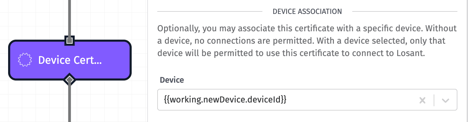

Device Association​
Optionally, specify a Device to associate with the certificate. Associating a device allows MQTT clients using that device ID to authenticate against the broker using this certificate; without associating a device, the certificate may not be used to authenticate against the broker.
Device Certificate: Register Node Device Association
Note: Certificates are valid for at most a single device. If a device is not associated at the time of registration, it may be assigned one time after creation. Once a certificate is assigned to a device, it cannot be reassigned to a different device.

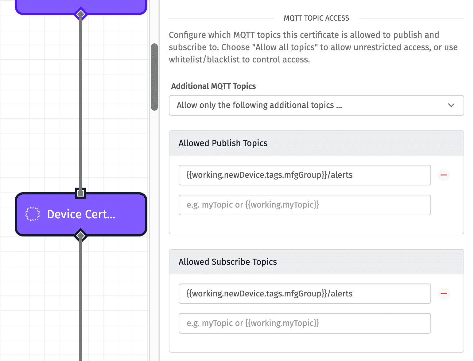

Additional MQTT Topic Access​
You may also grant publish/subscribe permissions to additional custom topics for devices connecting to the MQTT broker using the new certificate.
Device Certificate: Register Node Additional Topics
From the "Additional MQTT Topics" dropdown, select one of the following options:
  • Allow all additional topics: Devices using this certificate may publish or subscribe to all custom topics within the application.
  • Do not allow any additional topics: (default) Devices using this certificate may only publish or subscribe to their own topics.
  • Allow only the following additional topics ...: When selecting this option, you must define at least one topic that devices using the certificate may publish or subscribe to. You may define multiple topics for each operation, and the topic definitions support string templates.
  • Allow all except the following topics ...: Selecting this option is similar to "Allow only the following additional topics ...", except the listed topics are the only ones the certificate does not provide access to.

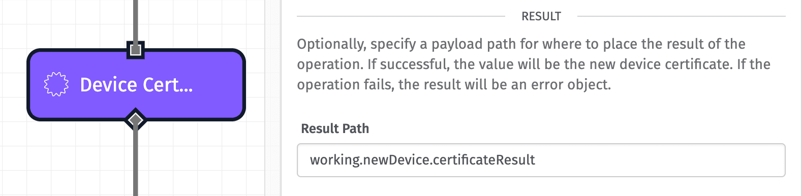

Result​
Finally, define a path on your payload where the new device certificate should be placed. If registration of the certificate fails, the object placed at the specified payload path will instead be an object describing the error.
For example, when allowing Experience Users to dynamically register new devices, it is common practice to first create a device using the Device: Create Node, and immediately register a certificate associated with that new device. The Endpoint Reply Node responding to the request should include at least the new device's ID along with the new certificate's details.
Device Certificate: Register Node Result
Given the node configuration in the screenshots above, and an input device with an ID of "aaaabbbbccccddddeeeeffff" and an mfgGroup tag value of "ABC123", successful device certificate registration placed on the path working.newDevice.certificateResult will result in the following object placed at that path:
