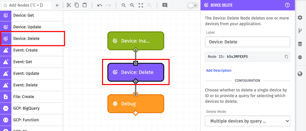

Device: Delete Node
The Device: Delete Node allows a Workflow to remove one or more Devices from your Application.
Device: Delete Overview

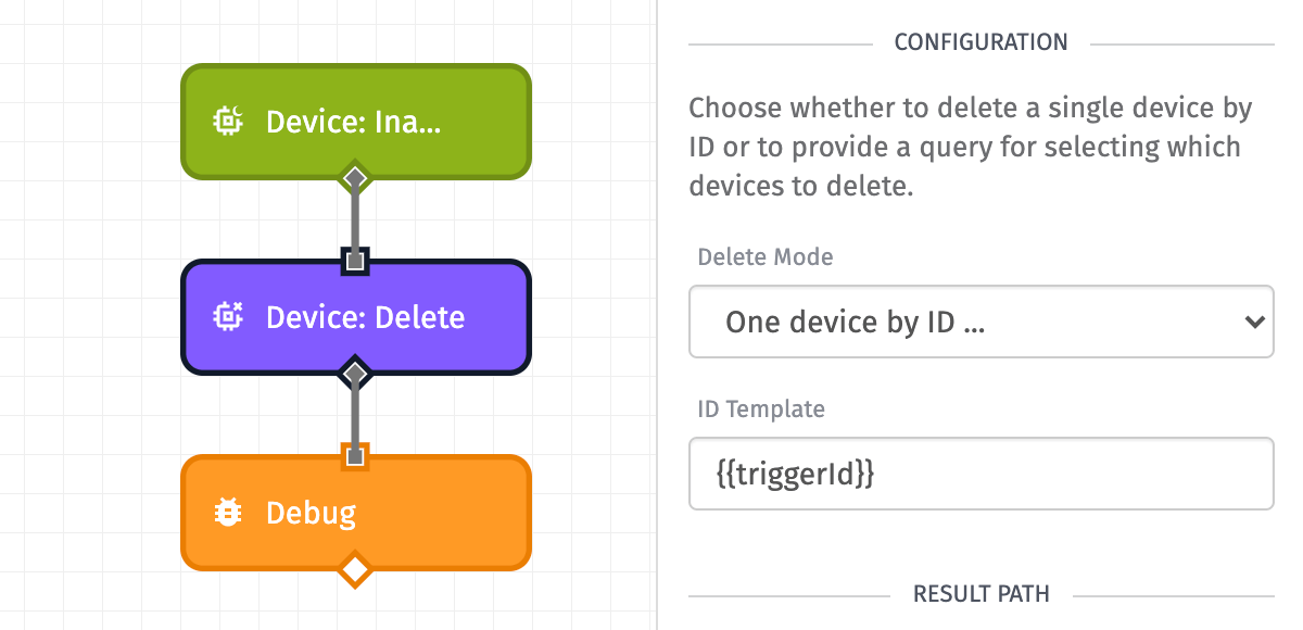

Inactive Device Pruning​
One use case for the Device: Delete Node is to delete a Device from your Application if it has failed to report state for a significant length of time. Depending on your Application, this can mean that the Device is no longer in use, and deleting any such Devices can help keep your organization's Device count below its resource limit.
Device: Delete Example - Inactive
In this example, a Device: Inactive Trigger fires if any Device matching a tag query fails to report state for 180 days. The triggerId is the ID of the Device that caused the trigger to fire, and we are using that value to know which Device to delete in this Workflow.

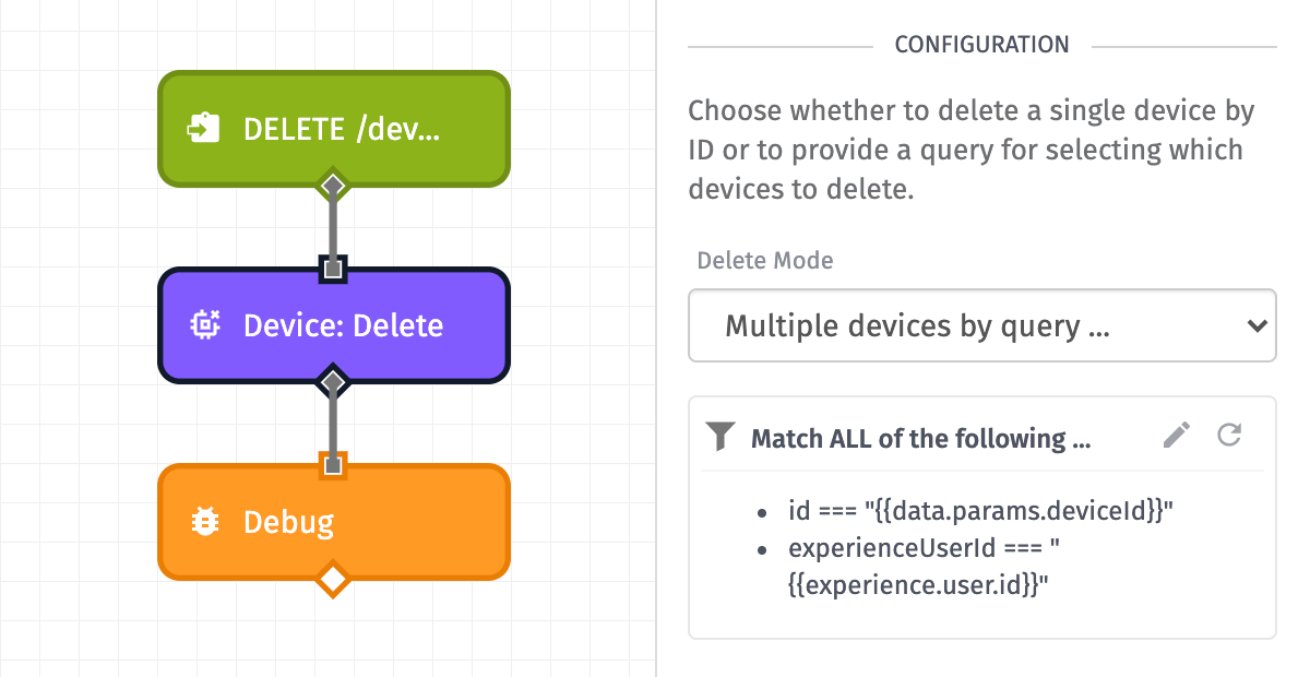

Experience User Device Deletion​
Another common use for the Device: Delete Node - as well as its related Device manipulation nodes - is to allow Experience Users a method for manipulating the Devices in your Application. They can do so by making an Endpoint request that in turn fires a Workflow.
Device: Delete Example - Experience
In this example, we imagine that an Experience User makes a request to delete a Device in the Application. Though the user is only attempting to delete one Device, we choose to delete multiple Devices by query because we do not want to allow the user to delete a Device not associated with his/her account.
Therefore, it will only delete Devices that match ALL of the following criteria:
Given that Device IDs are unique across your Application, and that we are performing a "Match All" query, this operation will delete a maximum of one Device from your Application per Workflow run.
