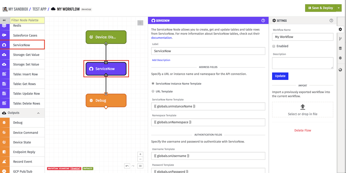

ServiceNow Node
The ServiceNow Node allows you to create, update and get records from tables in the ServiceNow platform.
ServiceNow Node
There are three main parts of the configuration for this node ...
ServiceNow Node Configuration
Address Fields​
Either ServiceNow Name Template or URL Template is required.
  • ServiceNow Name Template: A string template for your ServiceNow instance that will be used to create the ServiceNow URL. For example, if your instance name is "Acme", the ServiceNow URL would end up being https://acme.service-now.com.
  • URL Template: A string template for the URL address to access your ServiceNow API.
Authentication Fields​
  • Username Template: (Required) A string template for your username for Basic Authentication to ServiceNow.
  • Password Template: (Required) A string template for your password for Basic Authentication to ServiceNow.
Table Fields​
  • Table Name: (Required) The name of the table to make an API call at. The following are valid table names: Incident, Facilities Request Task, or Customer Service Case.
  • Action: (Required) The type of action to perform on the given table. The following are valid table actions: Get table records, Insert a new record, Get a table record, and Update a table record.
  • ID Template: A string template for the record ID to access on the API call. This field is only required if one of the following actions are chosen: Get table record or Update a table record.
  • Body Data Method: The type of data method to use when building a body for the API call. The following are valid body data methods: Individual Fields, JSON Template, Payload Path. This is only applicable to actions that can handle a body, such as: Insert a new record, Update a table record.
  • Body Data: This is where you can build the body of the request. If you choose Individual Fields as your Body Data Method, then you can use template strings for your key and value pairs to build your body object. If you choose JSON Template as your Body Data Method, you can use a JSON template to build the body object. If you choose Payload Path as your Body Data Method, enter a payload path to an object to use for the body.
