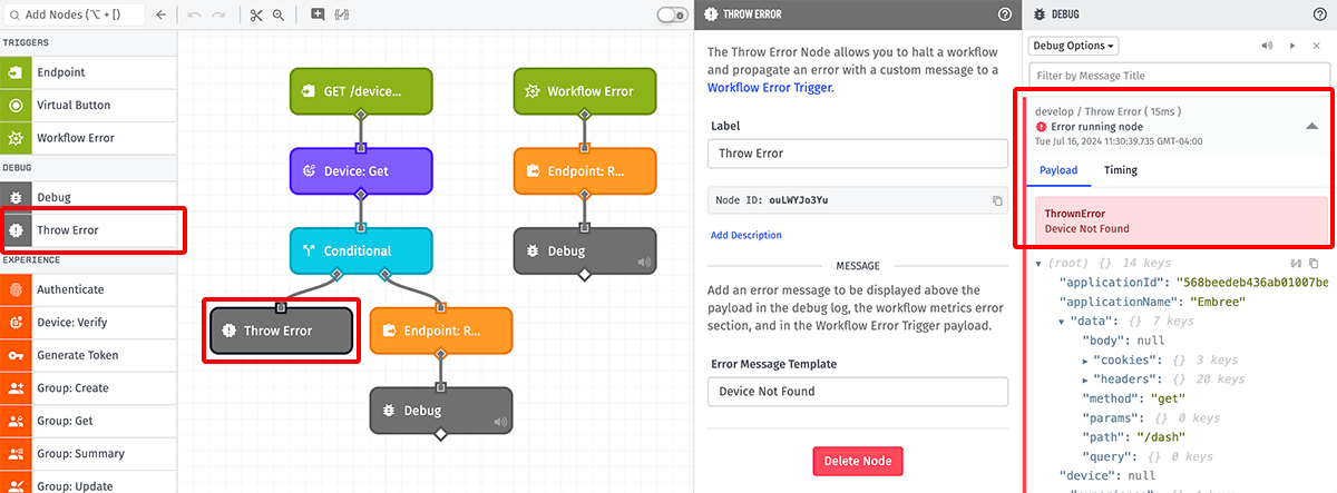

The Throw Error Node halts a workflow execution, logs an error to the debug panel and to workflow metrics, and fires any associated Workflow Error Triggers.
Throw Error Node
The Throw Error Node takes a single configuration property: a required Error Message Template, which is the message associated with the thrown error. The value is a string template that supports dynamic values rendered from the workflow payload. This value will appear in several places ...
Unlike most workflow nodes, you may not connect other nodes after a Throw Error Node. This is because invoking the node causes the workflow execution to halt, and any nodes following the Throw Error Node would never run.
