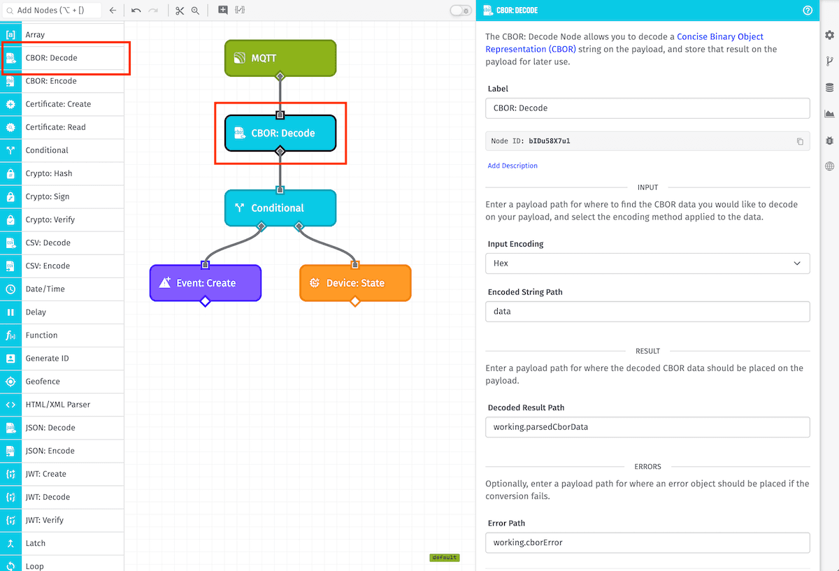

Input
  • Input Encoding: The encoding method applied to the CBOR data you wish to decode. Options are:
    • Base64
    • Binary
    • Hex (default)
  • CBOR Input Path: (Required) A payload path to where the encoded data can be found on the payload.
Result
  • JSON Result Path: (Required) A payload path to where the decoded CBOR data, in JSON format, should be placed on the payload.
Errors
  • Error Result Path: (Optional) A payload path for where to place info about any errors that occur while attempting to decode the value at CBOR Input Path.
Read more about handling errors from this node below.

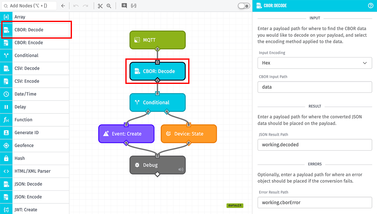

Given the following payload ...
"data": "a26568656c6c6f65776f726c6466706c65617365a366656e636f6465626d656261738461436142614f61526574696d657301"
... and a CBOR: Decode Node with the following configuration ...
  • Input Encoding: Hex
  • CBOR Input Path: data
  • JSON Result Path: working.cborDecoded
The payload after execution of the CBOR: Decode Node would look like:
"data": "a26568656c6c6f65776f726c6466706c65617365a366656e636f6465626d656261738461436142614f61526574696d657301",
"cborDecoded": {
"hello": "world",
"please": {
"encode": "me",
"as": ["C","B","O","R"],
"times": 1
