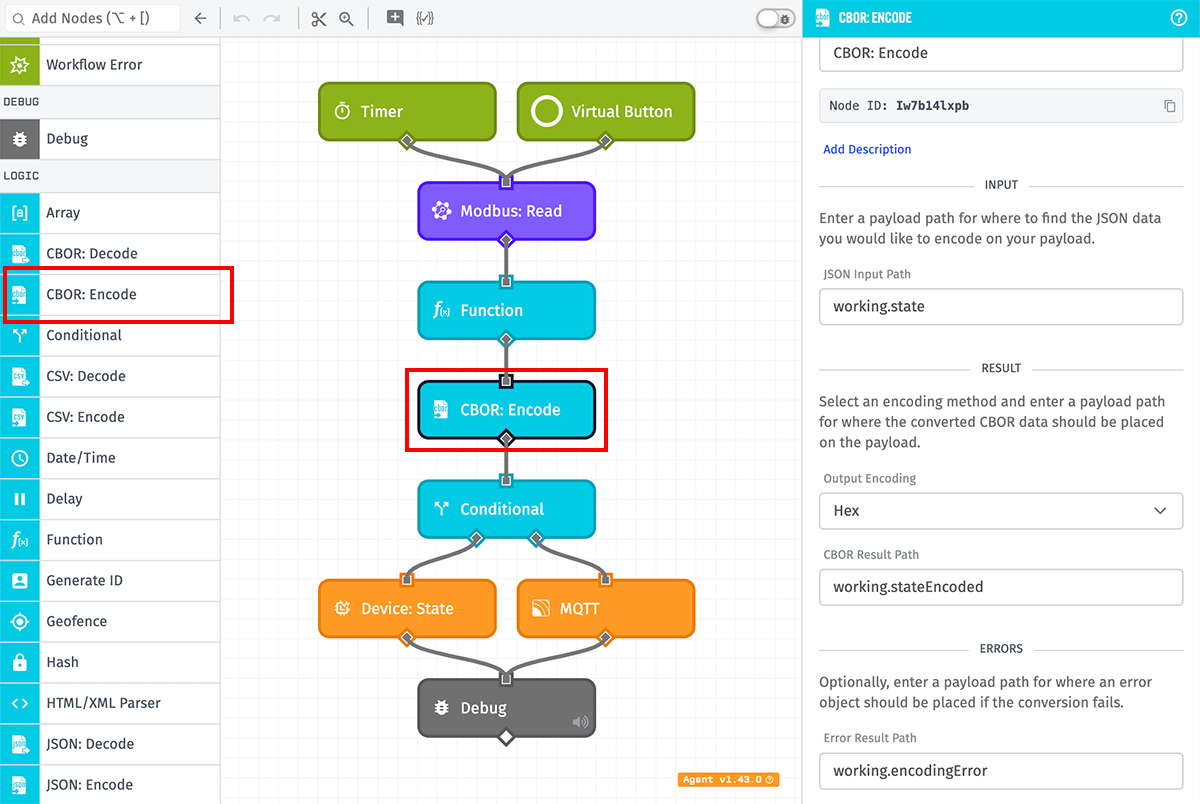

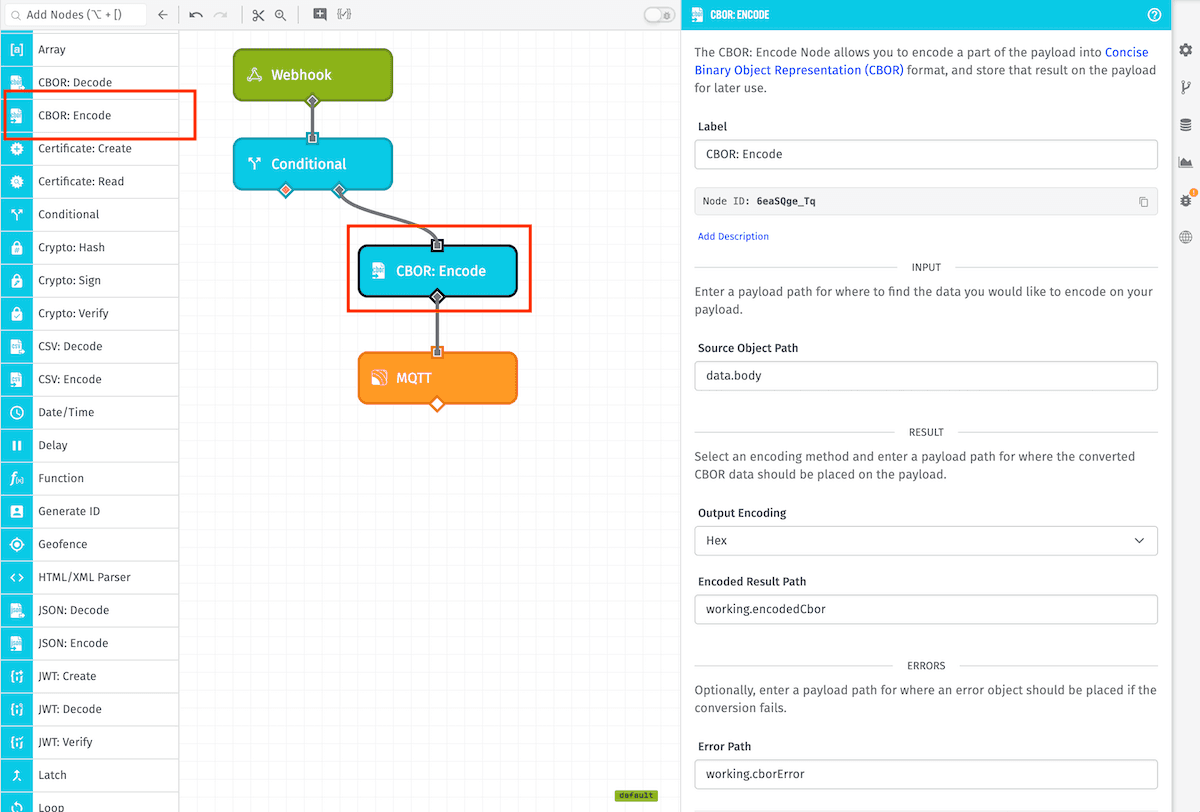

CBOR: Encode Node
The CBOR: Encode Node allows you to encode a part of the payload into CBOR (Concise Binary Object Representation) format, and store that result on the payload for later use.
CBOR: Encode Node
The CBOR: Encode Node's configuration is broken up into three sections ...
Input​
  • Source Object Path: The payload path to the object to encode.
Result​
  • Output Encoding: The encoding method to apply to the data. Options are:
    • Base64
    • Binary
    • Hex (default)
  • Encoded Result Path: The payload path at which to store the result.
Errors​
Read more about handling errors from this node below.
