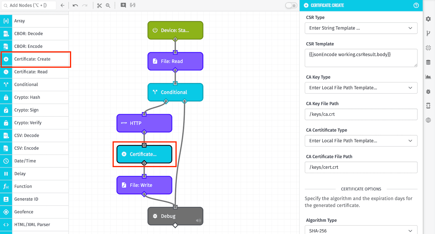

The Certificate: Create Node signs a Certificate Signing Request with the requester's public key and identity information using the provided CA key and certificate and issues a new certificate.
The Certificate: Create Node's configuration is broken up into the following sections ...
First, choose how to provide the Certificate Signing Request (CSR) for the new certificate. Options are:
  • Enter Local File Path Template: In Edge Workflows only, you may provide a file path to where the CSR is stored in a volume mounted within the agent's container.
  • Enter String Template: If selected, provide a string template resolving to the PEM encoded CSR on the payload.
  • Enter Payload Path: If selected, provide a payload path pointing to the PEM encoded CSR on the workflow payload.
In addition to a CSR, this field will also accept a PEM-encoded public key or unencrypted private key. When a key is provided in place of a CSR, the certificate's subject must be supplied via the Subject Overrides and / or Subject Alternative Names sections below — at least one of Common Name or one Subject Alternative Name entry is required. Note that only the CSR's Subject Alternative Name extension is preserved on the issued certificate; other extensions on the CSR (such as Key Usage, Extended Key Usage, Basic Constraints, or custom OIDs) are dropped. Use the Certificate Extensions section below to set Key Usage and Extended Key Usage on the issued certificate.
Note: For Edge Workflows, providing a key in place of a CSR is only available in GEA version 2.4.0 or higher.
Providing the CA Key and CA Certificate for signing the new certificate varies depending on the type of workflow where the Certificate: Create Node is being used.
Application & Experience Workflows​
In Application Workflows and Experience Workflows, you must provide a Credential Name Template that resolves to one of your application's Certificate / Key Pair Service Credentials to sign the new certificate.
Edge Workflows​
In Edge Workflows, the CA Key and CA Certificate are each provided by first choosing an input type:
  • Enter Local File Path Template: If selected, provide a file path to where the CA Key or CA Certificate is stored in a volume mounted within the agent's container.
  • Enter String Template: If selected, provide a string template resolving to the value.
  • Enter Payload Path: If selected, provide a payload path pointing to the value on the workflow payload.
The CA Key must be a PEM-encoded, unencrypted private key. Encrypted (password-protected) private keys are not supported. Accepted formats are:
  • PKCS#8 (-----BEGIN PRIVATE KEY-----)
  • PKCS#1 RSA (-----BEGIN RSA PRIVATE KEY-----)
  • SEC1 EC (-----BEGIN EC PRIVATE KEY-----)
The CA Certificate must be a PEM-encoded X.509 certificate (-----BEGIN CERTIFICATE-----) whose public key matches the provided CA Key.
