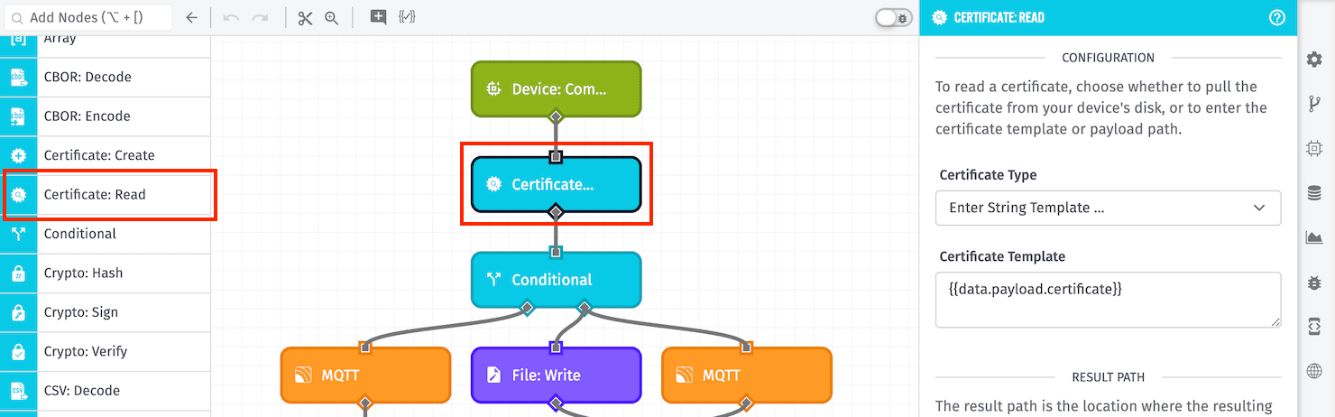

Certificate: Read Node
The Certificate: Read Node returns a given certificate's public key and metadata information.
The Certificate: Read Node's configuration is split into two sections ...
First, choose a Certificate Type, which determines from where to read the certificate. Options are:
  • Enter Local File Path Template: In Edge Workflows only, you may provide a file path to where the certificate is stored in a volume mounted within the agent's container.
  • Enter String Template: If selected, provide a string template resolving to a certificate.
  • Enter Payload Path: If selected, provide a payload path pointing to the certificate on the workflow payload.
In all cases, the input must be one or more PEM-encoded X.509 certificates (-----BEGIN CERTIFICATE----- blocks). A single block is treated as a single certificate; multiple blocks are treated as a bundle.
