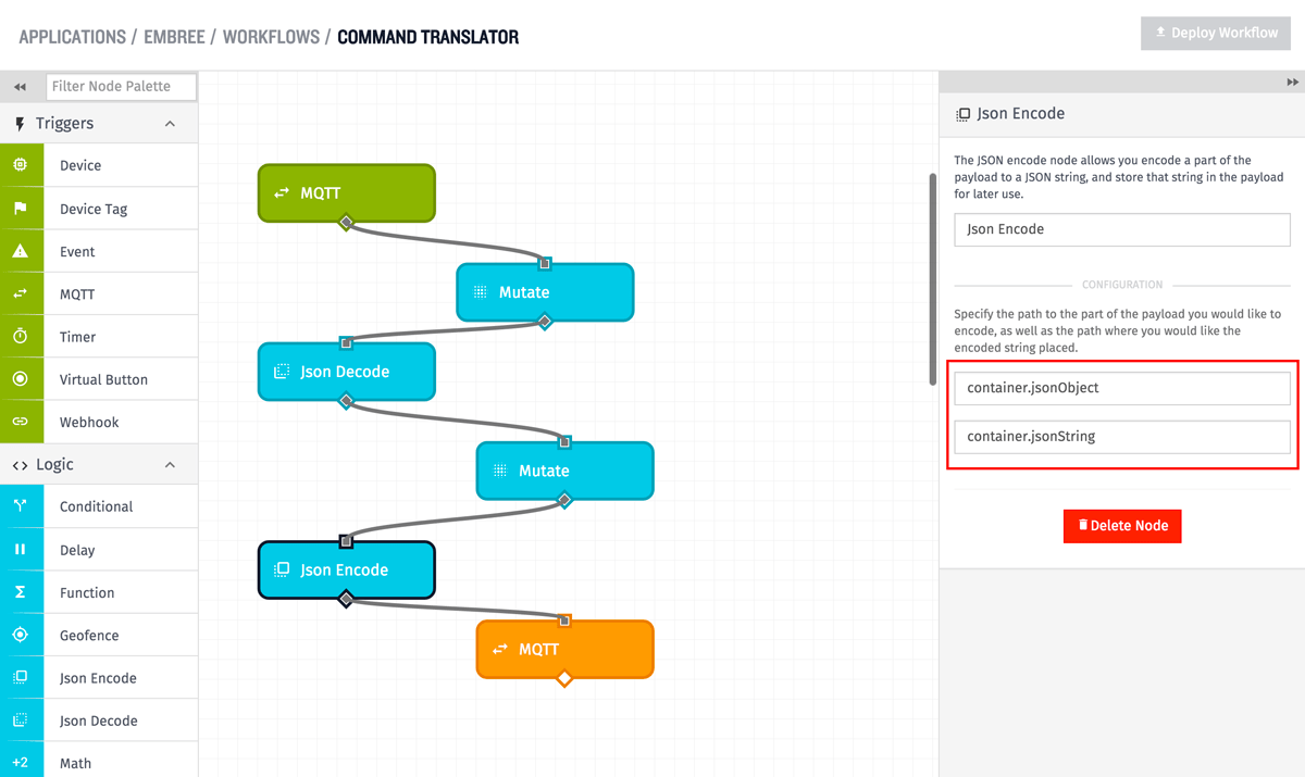

There are two configuration properties for the JSON Encode Node - the payload path to the JSON object to encode, and the path for where to store the resulting JSON-encoded string. Both paths are allowed to be the same, in which case the object will be replaced by the JSON string.
JSON Encode Node Config
In the above example, the workflow will encode the value at the container.jsonObject path and place the resulting string at the container.jsonString path. So, for example, given the following payload:
