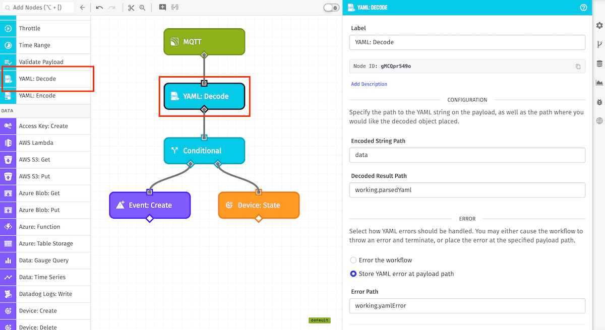

The YAML: Decode Node's configuration is broken up into two sections ...
First, define the YAML string data source and the destination for the result:
  • Encoded String Path: The payload path to the string to decode.
  • Decoded Result Path: The payload path at which to store the result.
Note: It is possible for both paths to be the same, in which case the YAML string will be replaced by the decoded result.
Error​
Next, define the error handling behavior. In the case that the provided YAML string fails to parse, there are two possible options for how to handle the error.
  • Error the workflow: Halt the workflow at this node, preventing further execution.
  • Store YAML error at payload path: Configure a payload path at which to store the error.
Read more about handling errors from this node below.
In the above example, the workflow will decode the string at the data path and place the resulting object at the working.parsedYaml path. So, for example, given the following payload:
"data": "messageBody:\n - 12\n - 24\nname: Trigger52\n",
The payload after execution of the YAML: Decode Node would look like:
"parsedYaml": {
"messageBody": [
12,
24
"name": "Trigger52"
