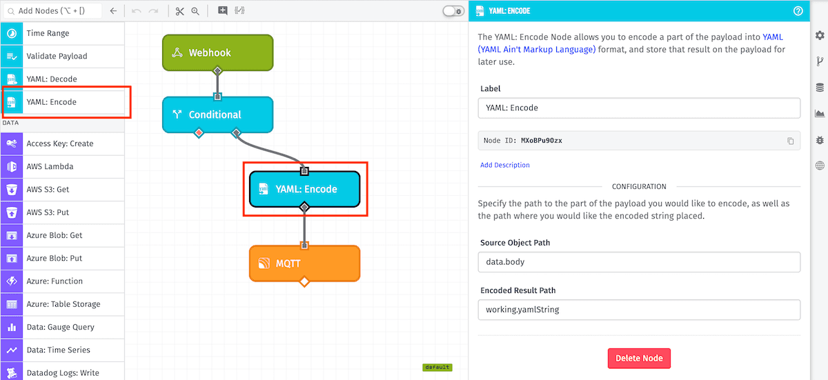

Define the data source and the destination for the result:
  • Source Object Path: The payload path to the object to encode.
  • Encoded Result Path: The payload path at which to store the result.
Note: It is possible for both paths to be the same, in which case the source will be replaced by the encoded YAML string.
In the above example, the workflow will encode the value at the data.body path and place the resulting string at the working.yamlString path. So, for example, given the following payload:
