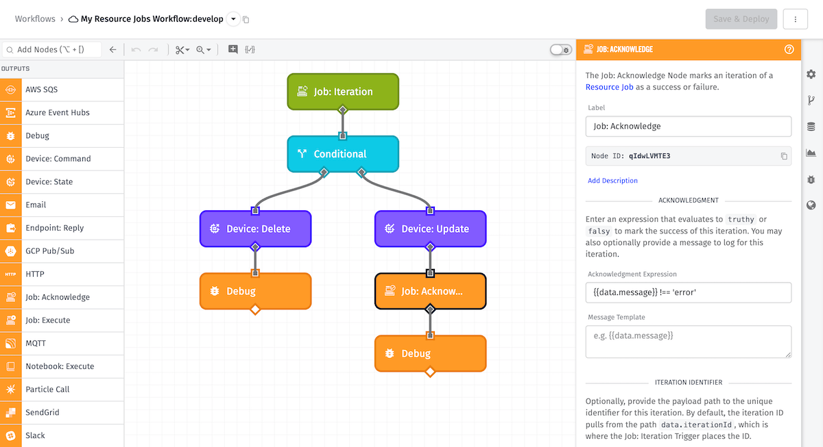

The Job: Acknowledge Node marks an iteration of a Resource Job as a success or failure.
The Job: Acknowledge Node has one piece of required configuration: an Acknowledgment Expression. This is an expression that evaluates to true
or false
, determining the success of this iteration.
Following the Acknowledgment Expression is an optional Message Template field. This is where you may define a message to be logged for each iteration as a template.
An Iteration ID Path can also be optionally defined. This is a unique identifier for each iteration defined as a payload path. If none is defined, by default, the iteration ID pulls from the path data.iterationId
, which is where the Job: Iteration Trigger places the ID.
One last piece of optional configuration is the Result Path. Here, a payload path can be defined for where to store the result of the acknowledgment request. The value will be an object with a success
property or, if applicable, an error
object with type
and message
properties.
