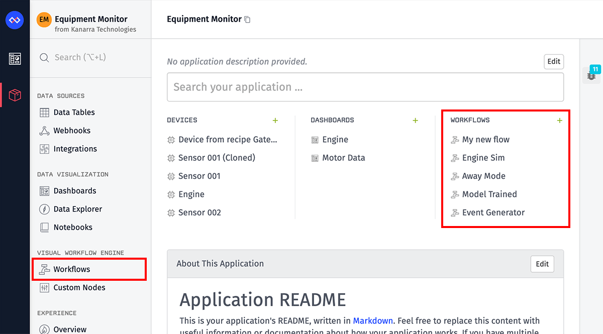

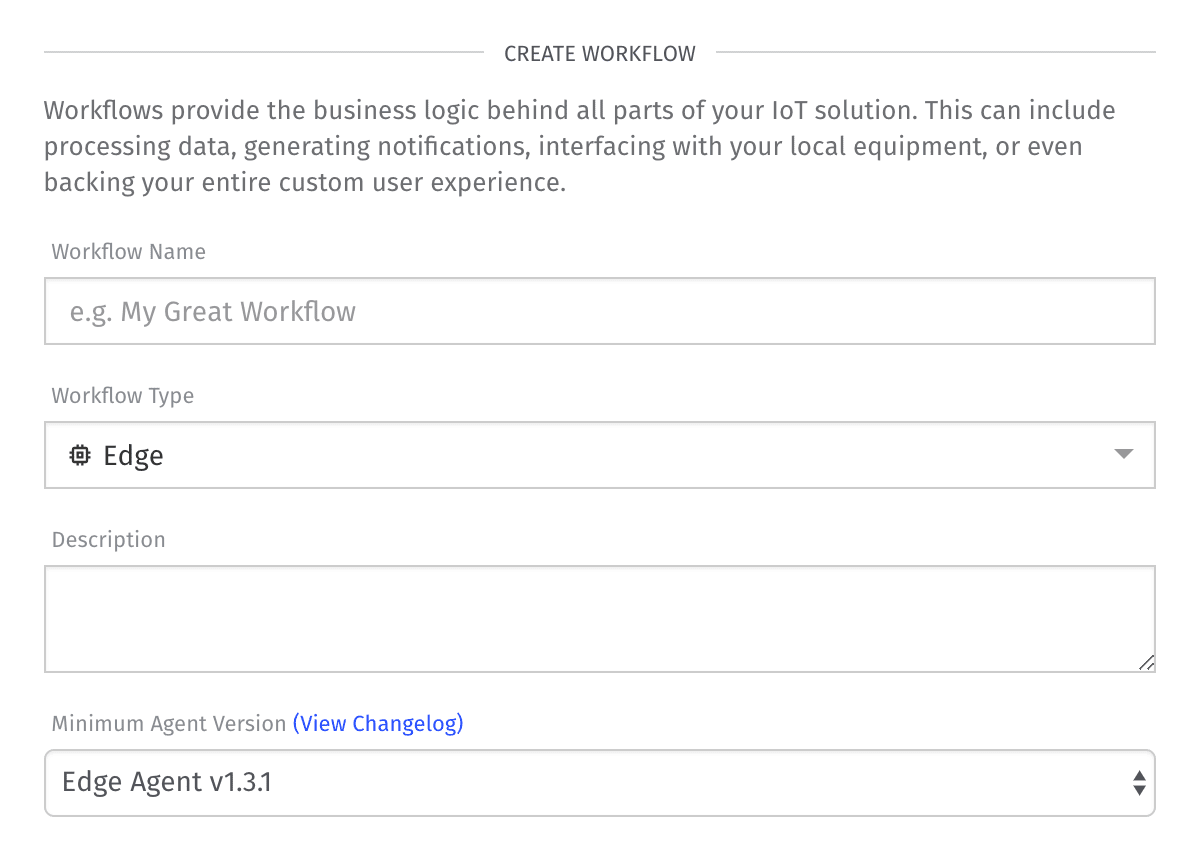

Creating a Workflow
Workflows can be created by clicking the "Add Workflow" button at the top of the Workflows page, or by clicking the "Add" link atop any of the lists of workflows broken down by type.
Add Workflow Buttons

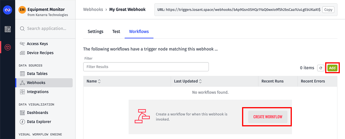

It is also possible to create workflows that are triggered by other Losant resources from the edit screens of those resources. For example, within the edit interface for a webhook is a list of application workflows that are triggered by requests to that webhook.
Webhooks Workflow List
When creating a new workflow, you must choose one of the workflow types outlined above. The type cannot be changed after workflow creation. You must then give your workflow a name and optionally a description. If you are creating an edge workflow, you must also choose the minimum GEA version to target with your workflow. This can be upgraded (but not downgraded) at a later time.
Create Workflow Settings

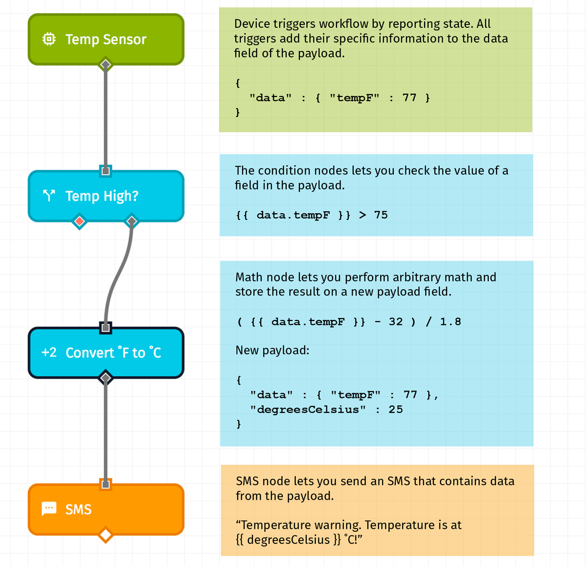

Example Workflow
Below is an example of how a payload flows through a workflow. This example uses an application workflow.
Workflow Overview
Let's break down this workflow and explain the individual nodes and how they work with the payload. For this example, our use case is ...
  1. A device is reporting temperature readings and we are using those state reports to kick off a workflow.
  2. The user would like to take an action if that temperature exceeds a certain threshold.
  3. This device reports temperature in degrees Fahrenheit; however, our user would prefer to receive reports in degrees Celsius.
  4. When the temperature does exceed the threshold, the user should receive an SMS alert.

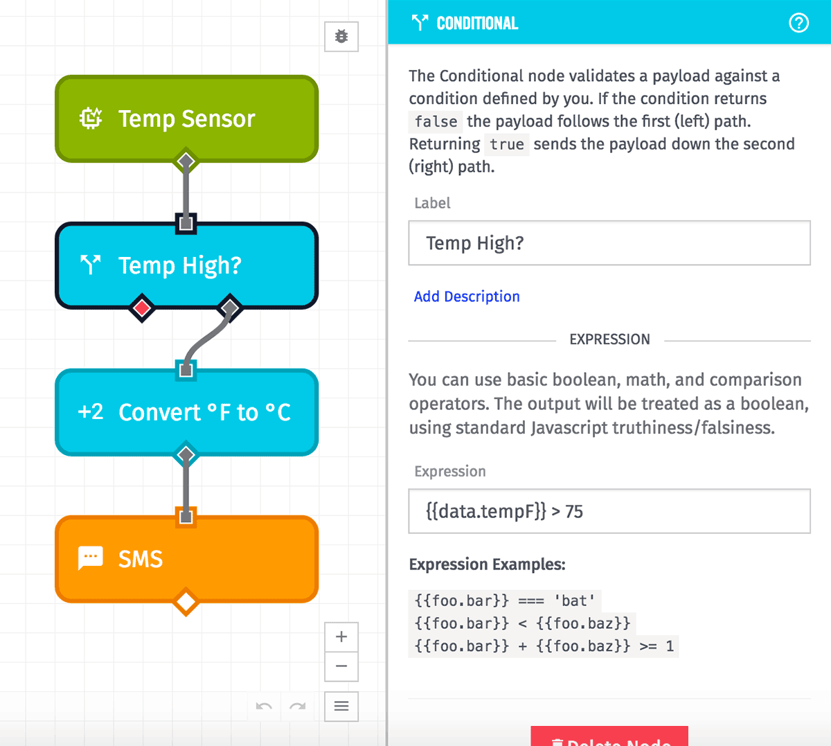

Temp High - Conditional Node
Conditional Nodes allow you to branch the workflow based on an expression that evaluates to true or false. If the expression is true, the workflow branches right. If the expression is false, the workflow branches left.
Workflow Overview Conditional
This node doesn't modify the payload, but it is using a value in the payload to make a decision. In short, the expression in the Conditional Node allows for testing the truthiness of a condition against a payload property. In this example, the expression is:
{{ data.tempF }} > 75
Whenever this node is executed it will grab the data.tempF value in the payload and check to see whether it's greater than 75. Since we saw that the tempF value in our payload is currently 77, this workflow will branch to the right. The Conditional Node doesn't modify the payload, so the same payload that was passed to it will flow as-is to the next node in the workflow.

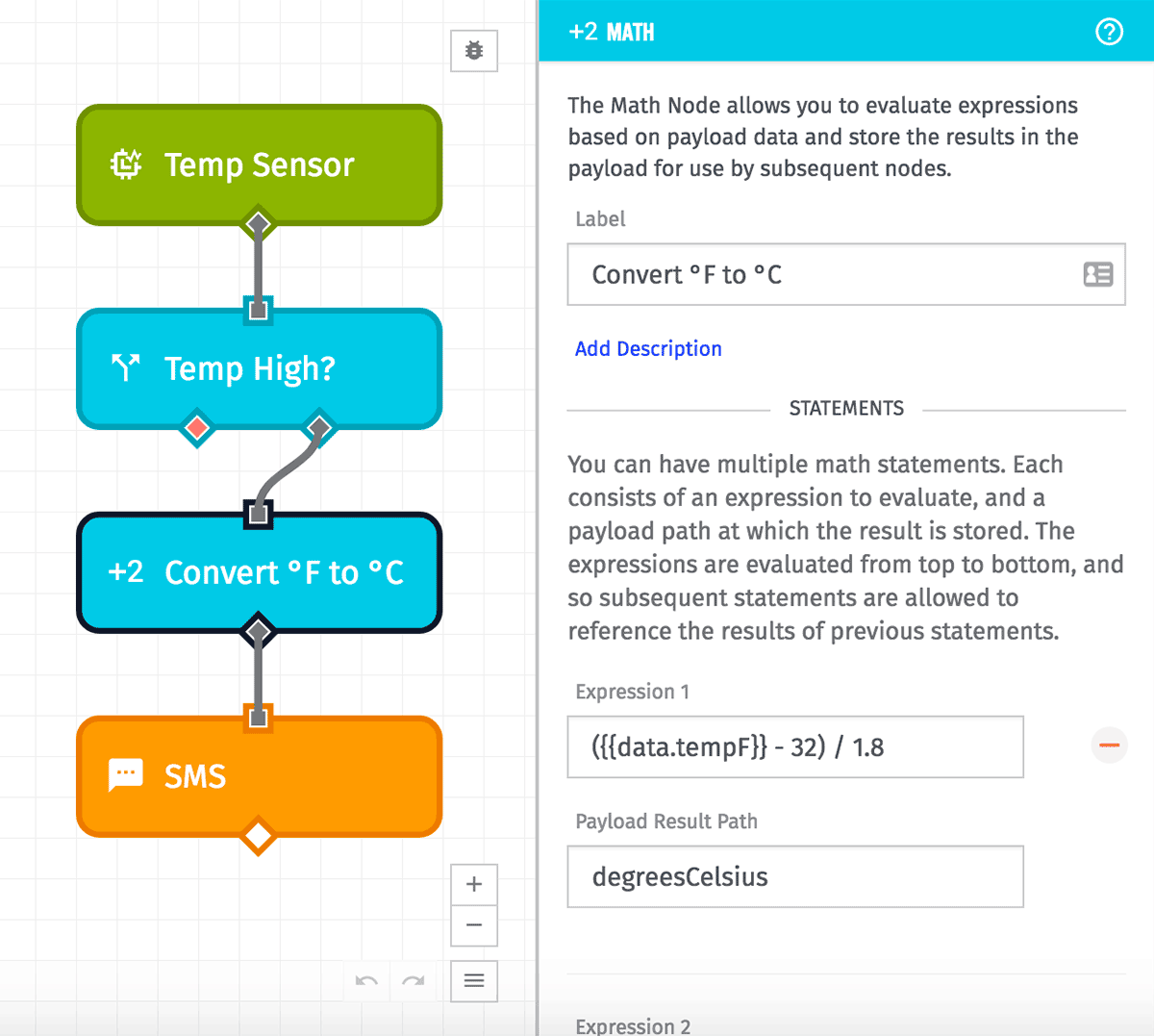

Convert ˚F to ˚C - Math Node
A Math Node allows you to write mathematical expressions and store the result on the payload.
Workflow Overview Math
Each Math Node supports multiple statements, but this example is only using one. Each statement includes the actual expression and a payload path for where to store the result. For this example, the expression is:
( {{ data.tempF }} - 32 ) / 1.8
Just like with the Conditional Node, you can reference values from the payload in these expressions. This is simply converting degrees Fahrenheit to degrees Celsius.
The second part of each math expression is a payload path for where to store the result. In this example the payload path is degreesCelsius; therefore, the result of the math expression will be placed on the root of the payload at the degreesCelsius property. The new payload now looks like:
"data": { "tempF": 77 },
"degreesCelsius": 25

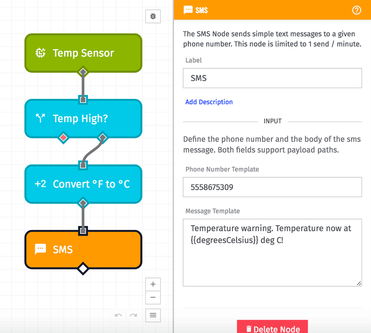

SMS Node
The SMS Node allows you to send an SMS message to one or more phone numbers. This example demonstrates how to use the newly modified payload in a useful way.
Workflow Overview SMS
The SMS Node supports string templates for its configuration values – but unlike evaluating to a boolean as it does for the Conditional Node, or a number for the Math Node, the SMS Node uses that value to create a custom message containing a value from the payload.
Temperature warning. Temperature now at {{ degreesCelsius }} deg C!

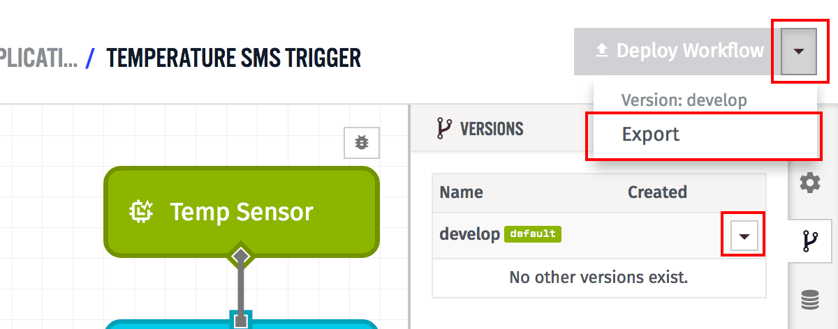

Import / Export
Workflows and their versions can be exported by clicking the dropdown alongside the Deploy Workflow button, or by clicking the dropdown in the version row. Clicking the Export option opens a modal that exposes some options for the export.
Export Workflow

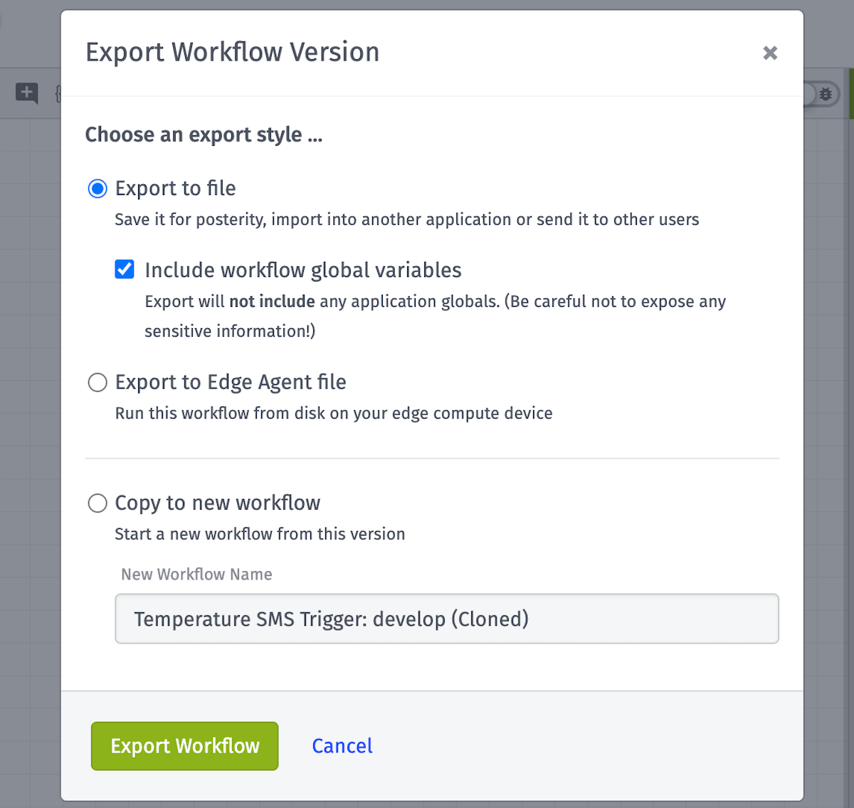

Exporting as a File
When exporting the workflow as a file, you must also choose whether to include the values of your workflow globals in the export bundle. (Application globals are never included.) If you intend to share this workflow with other users outside your organization, and the workflow utilizes globals to store sensitive information, then the file should be exported without global values included.
Note: When excluding workflow global values, the export file will still include the workflow global keys, so that the user importing the workflow file knows which values are required to successfully execute the workflow.

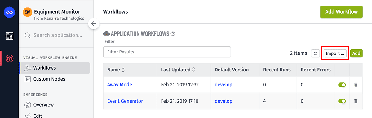

Import Workflow
Given an export file, you can import a workflow from your application's workflows list, by either dragging the exported file onto the appropriate list, or clicking the Import button (which will allow you to browse for an exported workflow file).
Note: Imported application workflows are disabled by default to give you the chance to make any needed modifications before the workflow starts running.

Exporting for On-Disk Use
This option is only available for edge workflows, and it allows your workflow version to be exported in a format that can then be loaded directly onto your hardware and run from disk.
There are a few considerations when exporting an edge workflow in this format:
  • Global values are always included in the export file. Therefore, if your workflow utilizes globals to store sensitive information (such as third-party API credentials), this file should never be shared with users outside of your organization.
  • On-disk exports cannot be imported into Losant as new workflows due to formatting changes in the export file that allow it to be run from disk.

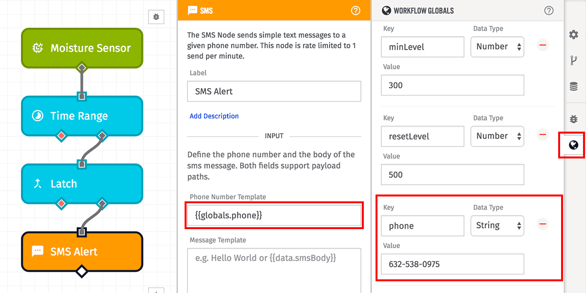

Workflow Globals
Workflows can have a set of global config keys, which are essentially keys/value pairs added to the payload under the globals key whenever the workflow runs. This is a great place to store configuration values or API keys, especially if they are needed for use in multiple different nodes. Globals can be accessed through the "Globals" tab in the right dock.
Workflow Globals
Application Globals configured in the application will also be accessible here. Application globals can be overridden at the workflow version level by creating a workflow global with the same key name.
Experience Globals configured in an Experience Version will also be accessible only in Experience Workflows. Application globals with the same key as an Experience Version Global key will be overridden, while any Workflow Global with the same key will override an Experience Global.
In the above example, there are three global keys set — minLevel (with a numeric value of 300), resetLevel (with a numeric value of 500), and phone (with a string value of 513-555-1212). Complex objects can be configured by choosing JSON as the data type of the value and adding JSON-formatted data as the value. Whenever the workflow runs, the payload will always include these global values. For the above example, a payload might end up looking like the following:
"moisture": 576
"globals":{
"minLevel": 300,
"resetLevel": 500,
"phone": "513-555-1212"
"applicationId": "56919b1a9d206d0100c54152",
"applicationName": "Light Wall",
"triggerId": "56c794a06895b00100cbe84c",
"triggerType": "deviceId",
"deviceTags": {},
"deviceName": "Moisture Sensor",
"flowId": "56956cd25a6f2f0100dc70d4",
"flowName": "Moisture Alert",
"globals": {}
These values will be accessible in any node configuration that expects payload paths (such as globals.minLevel) or templates (such as {{globals.phone}}).

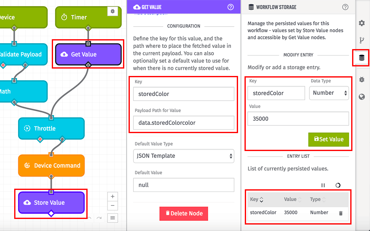

Workflow Storage
The workflow storage interface lets you view and manipulate the persistent workflow storage. This is the storage space used by the Storage: Get Value and Storage: Set Value Nodes. The storage interface is located under the "Storage" tab in the right dock.
Workflow Storage
In the top half of the interface, you can add new storage entries or modify existing ones. Specify the identifier to add (or change), specify the value and the Data Type, and click Set Value. The data type can be String (the value is treated as a string), Number (the value is treated as a number), or JSON (the value is parsed as JSON). The JSON data type can be used to set complex objects or arrays, or even just true/false/null.
NOTE: The act of clicking Set Value has an immediate effect across all workflow versions. This will change or add the value immediately; this is separate from saving/deploying the workflow.
In the bottom half of the interface, you can view the values of existing storage identifiers. In this case, there is one identifier, storedColor, and its value is the number 35000. This identifier was previous set by the Storage: Set Value Node in a previous run of the above workflow. This table of values will automatically refresh every 60 seconds, but you can always click the refresh link on the upper right if you want to see the latest values now.
Workflow Storage Limits
A workflow can have a maximum of 16MB total in storage at one time. A workflow can have a maximum of 16,384 storage keys at one time. Each value is limited to 16,384 KB. If a workflow exceeds any of these limits, adding new a storage key will error.
Storage keys do expire. If a key has not been changed or accessed within the data retention limit of the owning Organization or Sandbox, the storage key will be deleted.
