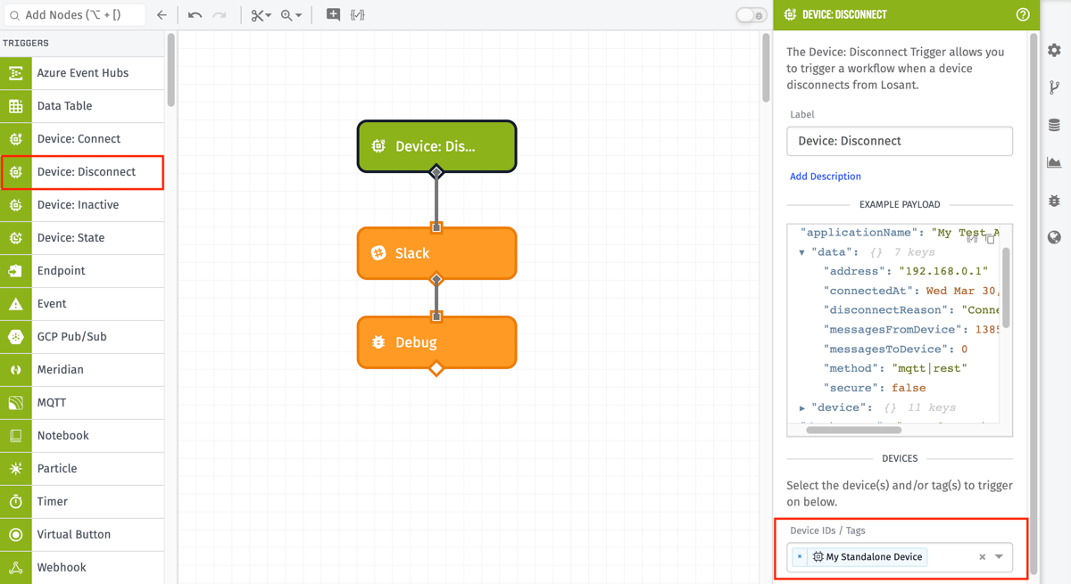

The Device: Disconnect Trigger fires a workflow whenever one or more devices disconnect from the Losant Platform, via the MQTT broker or whenever the connection status is changed to "disconnected" using the REST API.
Device Disconnect Trigger

The Device: Disconnect Trigger can be configured with one or more specific devices, or a selection of tags (or both). When a device that matches anything in the selection disconnects from Losant, the workflow will trigger. See the device query documentation for more info about how ID and tag matching works.
In the above example, the workflow will be triggered whenever any device that has a type=Smoke Detector tag disconnects from Losant.
