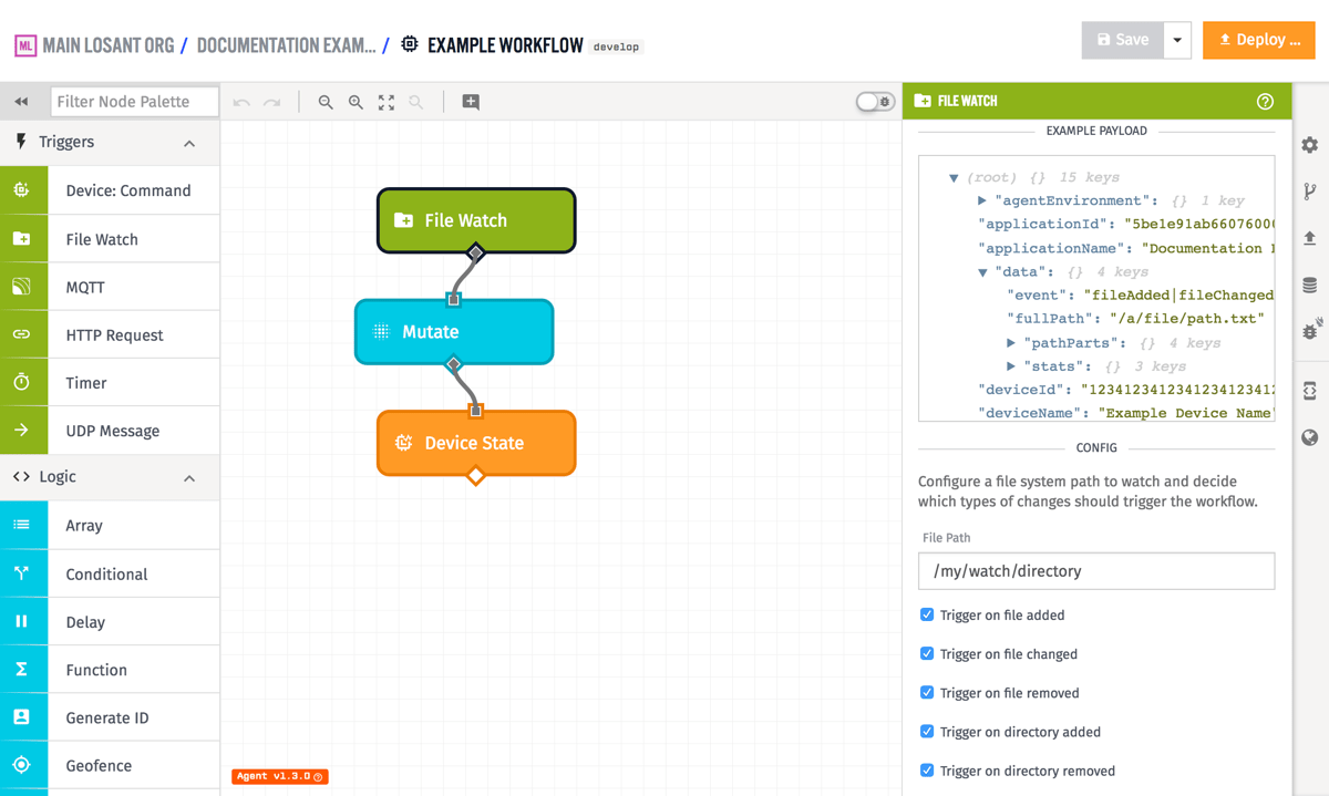

File Watch Trigger
The File Watch Trigger will trigger a workflow whenever the Edge Compute device sees file or directory changes on the configured path.
File Watch Trigger
There are two configurable criteria for a File Watch Trigger...
  • File Path: (Required) The file system path to watch within the agent's Docker container. Usually this path is mounted into the container from the host system.
    • To watch all files under a directory and its subdirectories, enter a path for that directory. For example: /path/to/watch/.
    • To watch a specific file, enter the full path to that file, including the file extension. For example: /path/to/watch/file.txt.
    • To watch all files with a specific extension under a directory or its subdirectories, you can use a [glob pattern](https://en.wikipedia.org/wiki/Glob_(programming). For example, to watch all .txt files in a directory and its subdirectories, you can use /path/to/watch/**/*.txt.
  • Trigger on...: (Required) The types of watch events to trigger on. You can choose to trigger on any combination of adding files, changing files, removing files, adding directories, or removing directories.
