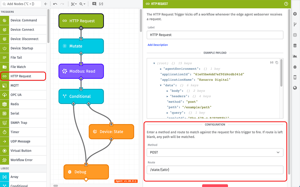

The HTTP Request Trigger fires a workflow whenever the Gateway Edge Agent receives a request on its local web server. The trigger can fire on all requests or those matching a specific method and/or route.
There are two configuration settings for the HTTP Request Trigger: Method and Route.
NOTE: Prior to Gateway Edge Agent v1.24.0, this trigger had no configuration. For those agents, this trigger always matches any incoming request on the local web server.
Method​
This is the HTTP method the request should match. Currently, we support these methods: GET, POST, PUT, PATCH, DELETE, OPTIONS. To have the trigger match any request method, choose Any Method (this is the default behavior).
Route​
The route is the URL path, or the part after your local server's domain. If your local server's domain is http://localhost, the route is everything after that. It always starts with a slash / and may contain a series of static and parameter segments separated by more slashes.
There are a number of rules to consider when specifying a route for the HTTP Request Trigger:
  • Routes can contain string literals, path parameters and wildcards. For example, given the route /devices/{deviceId}/{attribute?} ...
    • devices is a string literal, which is a static route parameter.
    • {deviceId} is a required path parameter. If a request is made to /devices/ without a {deviceId} after the trailing slash, the request will not match this trigger.
    • {attribute?} is an optional path parameter; a request to /devices/123 and /devices/123/temp will both succeed and will both match the trigger, but the latter will include {"attribute": "temp"} as part of the payload passed to your workflow.
  • Routes can contain wildcards. Wildcards must be used with care, as they will match any request. A typical use case for a wildcard is if you want to create a trigger to deal with all OPTIONS requests; in that case, you would configure a route of /{var*}, where var is available on the payload with the value of whatever the user entered after the first slash.
  • Any matching route trigger is fired. If two triggers, with different route configuration, both match a given request, both triggers will fire.
  • A blank route will match any request. When the route is left blank, this is treated as a match anything route (and this is the default behavior).
