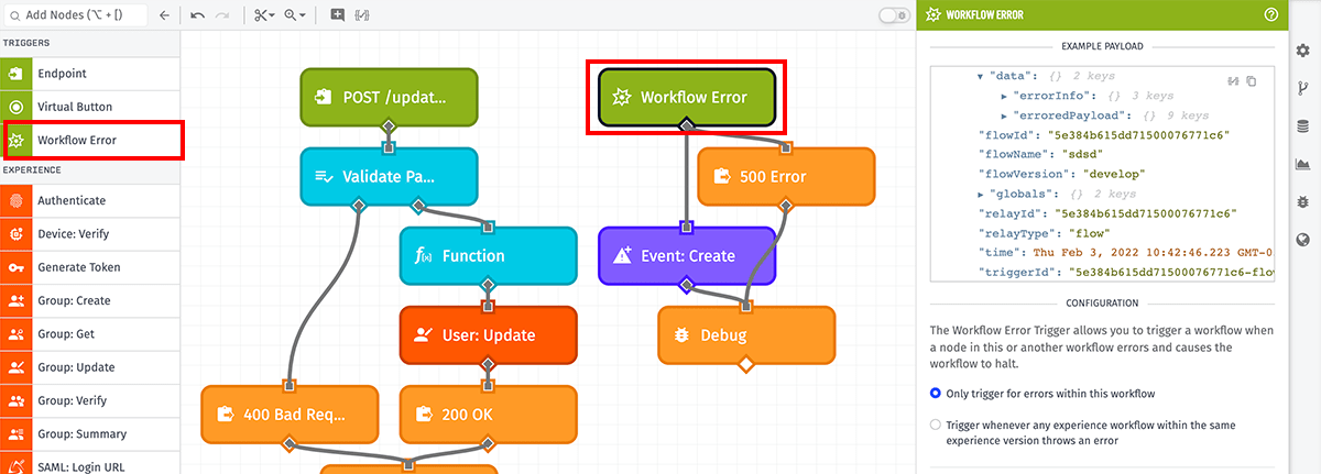

Experience Workflows​
In Experience Workflows, the Workflow Error Trigger may fire in two different scopes ...
  • Only trigger for errors within this workflow: The Workflow Error Trigger will only execute when a halting error occurs in the same workflow and version in which it is placed. This is useful for recovering from an uncaught exception and continuing to deliver an expected result to an Experience Endpoint request.
  • Trigger whenever any experience workflow within the same experience version throws an error: The Workflow Error Trigger can be placed in any Experience Workflow within your Experience Version, and it will fire for a halting error within any Experience Workflow within that same version. This is useful for serving a generic 500 Internal Server Error page to your end users.
