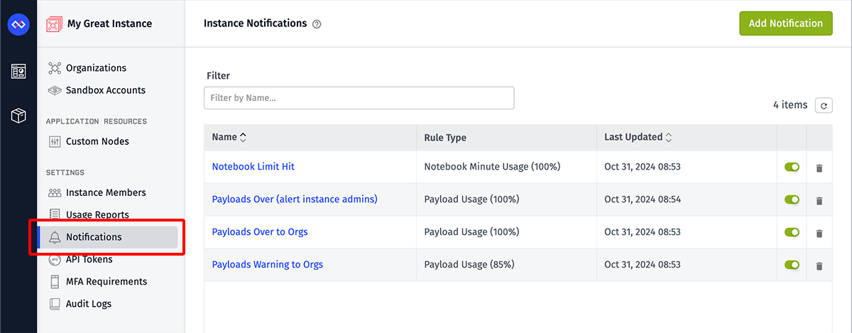

Viewing Notifications
A list of your instance's notification rules can be found under the "Notifications" link in the Instance Manager's subnavigation. Clicking a notification rule's name takes you to a detail page where you can edit the rule (if you have administrator privileges) and also see a log of recent true evaluations of the rule against target organizations.
Adding Notifications
To add a new notification rule, click the "Add Notification" button at the top right corner of the notifications list. The button is only present for instance administrators.

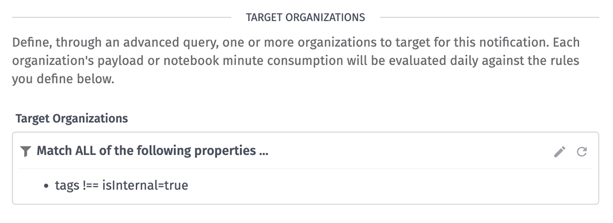

Target Organizations
Provide an advanced query for targeting which instance organizations to evaluate the rule against. Queries that explicitly target no organizations are not allowed.

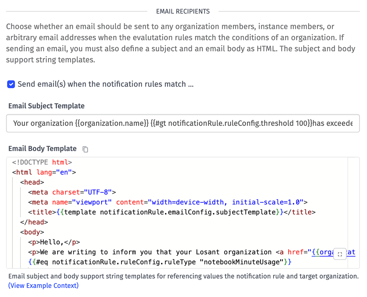

Email Recipients
Choose whether to send an email to one or more recipients when the notification rules evaluate as true for a given target organization. If opting not to send emails, then Callback URL is required.
If choosing to send emails, you must provide the following ...
- Email Subject Template: Enter a string template to serve as the subject line of the email. Templates render against the notification context.
- Body Template: Provide HTML in the form of a string template for the email body. Templates render against the notification context.
- Organization Recipients: Choose whether to send this email to ...
- All organization administrators
- All organization members (except those with "None" permission)
- No organization members
- Instance Recipients: Choose whether to send this email to ...
- All instance administrators
- All instance members
- No instance members
- Arbitrary Recipients: Optionally, enter one or more email addresses (maximum of 10) to send a notification to outside of the options selected above. If both No organization members and No instance members are selected, at least one arbitrary email address must be provided.
For new notifications - or when enabling emails in existing notifications - Losant provides an example Email Subject Template and Body Template to use as a starting point.

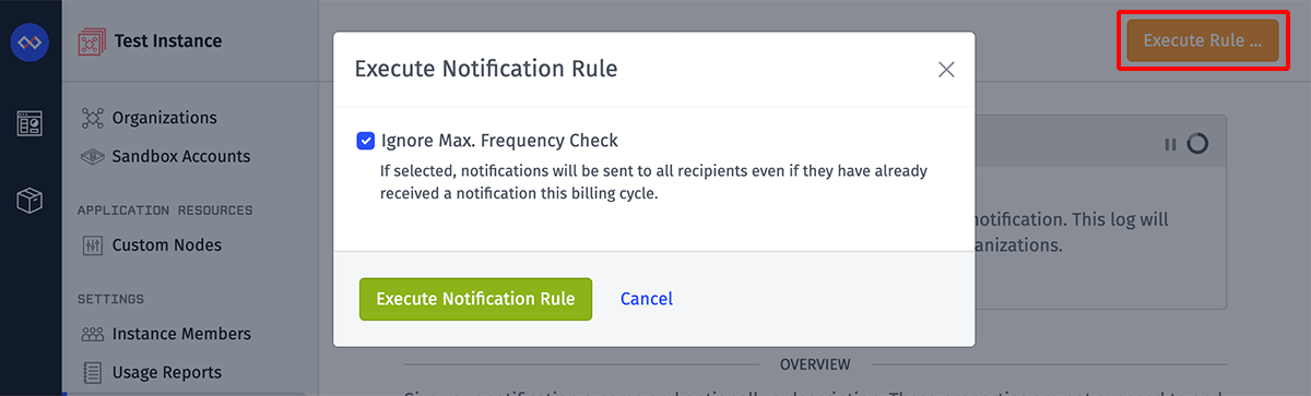

Manual Executions
Instance administrators can manually execute a notification rule with its current settings by clicking the "Execute ..." button in the top right corner of the rule's detail page. When doing so, you may choose to Ignore Max. Frequency Check, which sends notifications to any target organizations evaluating true against the rule configuration regardless of if they have already received a notification this billing cycle or this day (depending on the rule's "Maximum Notification Frequency").
This feature, along with the option to ignore the frequency check, is especially useful when building out the notification email and callback logic; however, care should be taken to limit the target organizations to internal organizations and/or reduce the email recipients to test accounts so as not to spam organization members with unfinished and misleading messages.
Note: If the notification rule is not enabled, you may not invoke a manual execution.

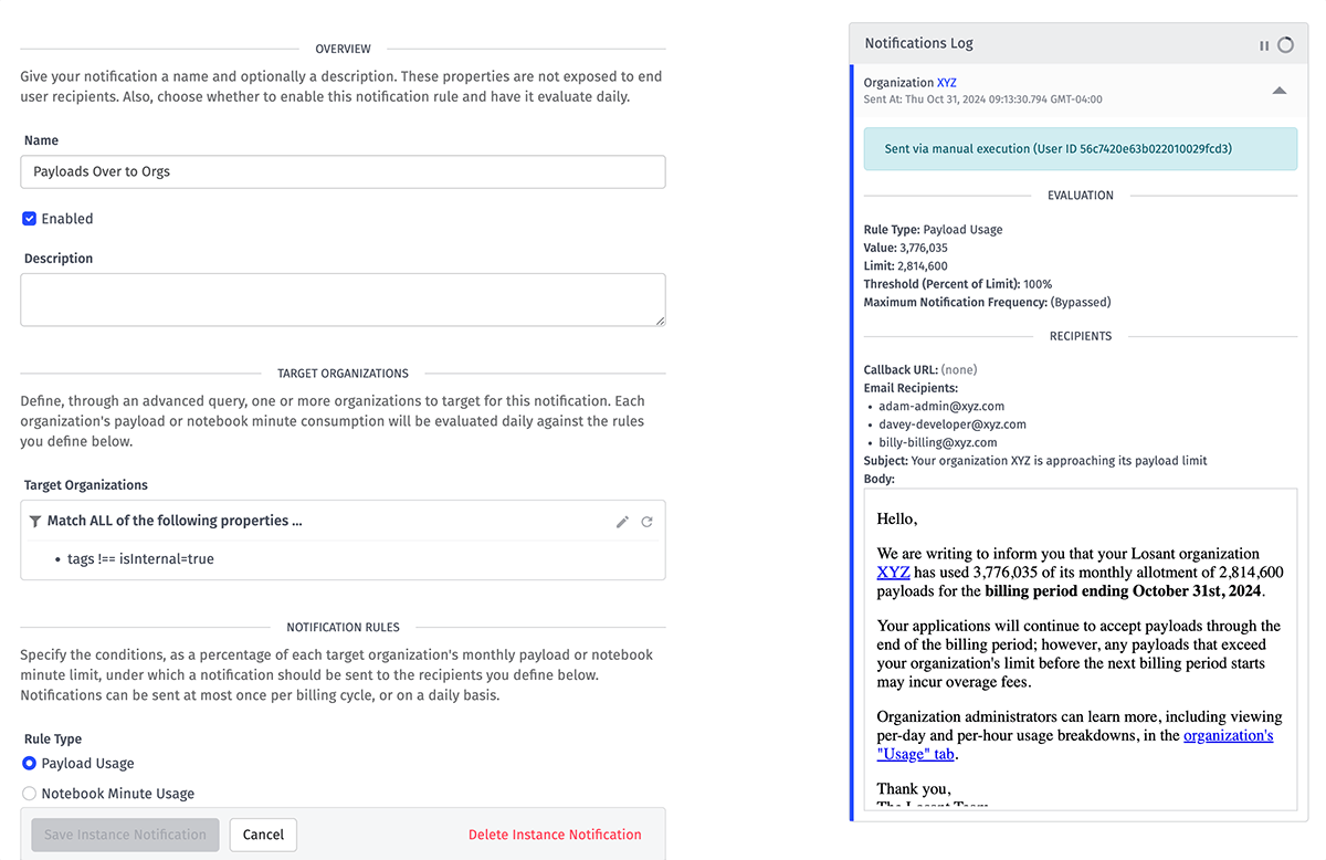

Notification Log
On a notification rule's detail page is a log of recent activity, which includes entries for each email / callback request generated by the rule. For example, if one execution of the rule matches against 10 of your instance's 100 organizations, there will be 10 entries in the log corresponding to that execution (one entry per matching organization).
Each entry provides the following information:
- The instance organization that matched the rule
- Who requested the execution (or if it was system-generated)
- When the notification was sent
- The rules and values that led to the execution ...
- The rule type (payload or notebook minute usage) and threshold (percentage of value versus limit)
- The notification's maximum frequency (or, if this was a manual execution, if the rule's max. frequency was bypassed)
- The organization's usage of the target resource at the time of the notification
- The organization's limit on the target resource at the time of the notification
- Whether an email was sent, and if so ...
- All the email addresses that received the message
- The rendered email subject
- The rendered HTML of the email body
- The callback URL that was invoked, if applicable
