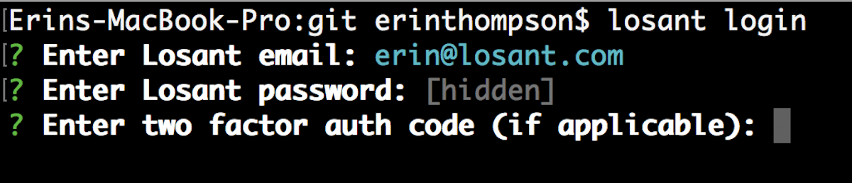

Login​
After installing, one way to set up your user profile is to run the command losant login. This will prompt you to enter your Losant account email address. If your user is not connected to a Single Sign-On Provider, you will be prompted to enter your password, and optionally your multi-factor authentication code. If you do not have multi-factor authentication enabled, just hit enter to skip multi-factor authentication.

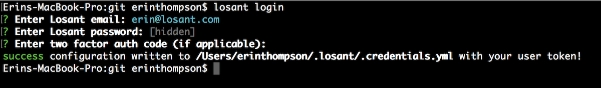

Once you have successfully authenticated with our API, a file will be created at ~/.losant/.credentials.yml containing your authentication token. This token will be used across all of your Losant configured directories.
Losant Success Login

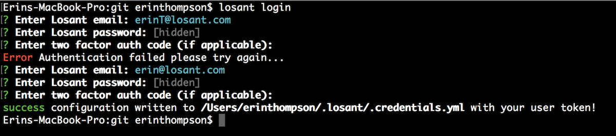

If authentication fails you will be prompted to re-enter your email, password and multi-factor authentication.
Losant Retry Login

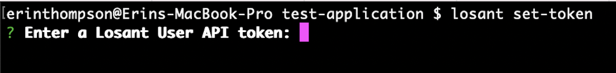

Set-Token​
Losant Set-Token
The second way to set up your user profile is to run the command losant set-token [token]. After installation, running this command will prompt you to enter a User Token or pass in the User Token as the command argument to avoid being prompted. The set-token command is an easy way to give a non-Losant user access to a specific application or all of your applications without having to give them the full credentials to the UI.

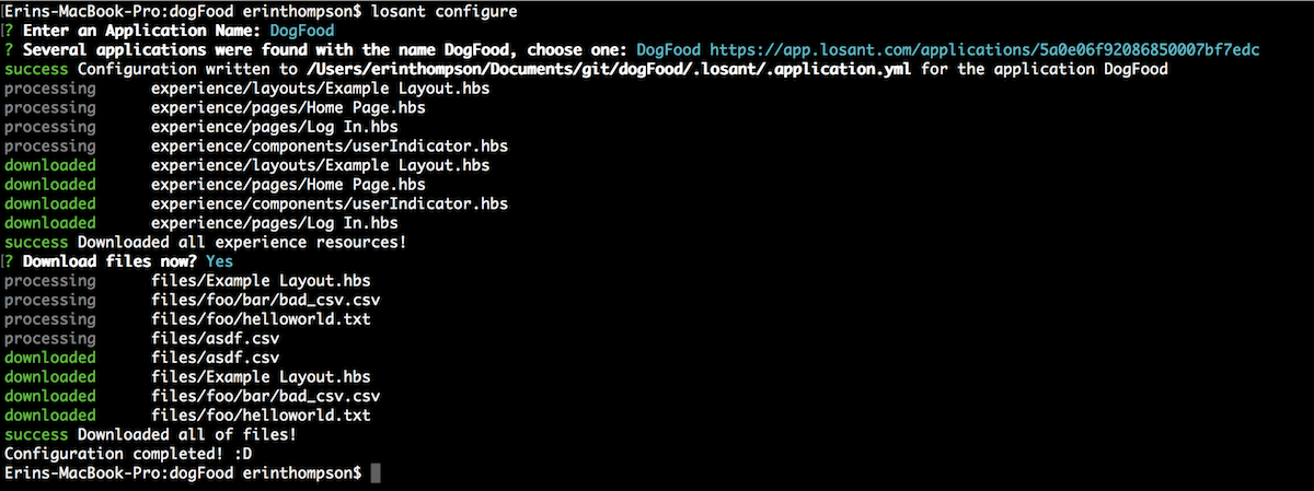

Configure​
After you have successfully set up your user profile, you are now ready to configure a directory.
Create or go to a directory that you want to keep your Losant Application resources, then run losant configure. This will link the current directory to one of your Losant Applications.
Losant Configure

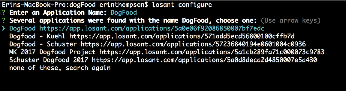

When you run this command, you will be prompted to give a (or part of a) Losant Application name. If multiple Applications come back with similar names we will present you with a list to choose from. If you don't find the application you are looking for, choose none of these, search again, and it will re-prompt you for another Application name.
Once you have picked the Losant Application, it will automatically try to download your Application's Experience Views. It will then prompt you to download your Application's Files followed by your Application's Data Tables.
Losant Configure Success
