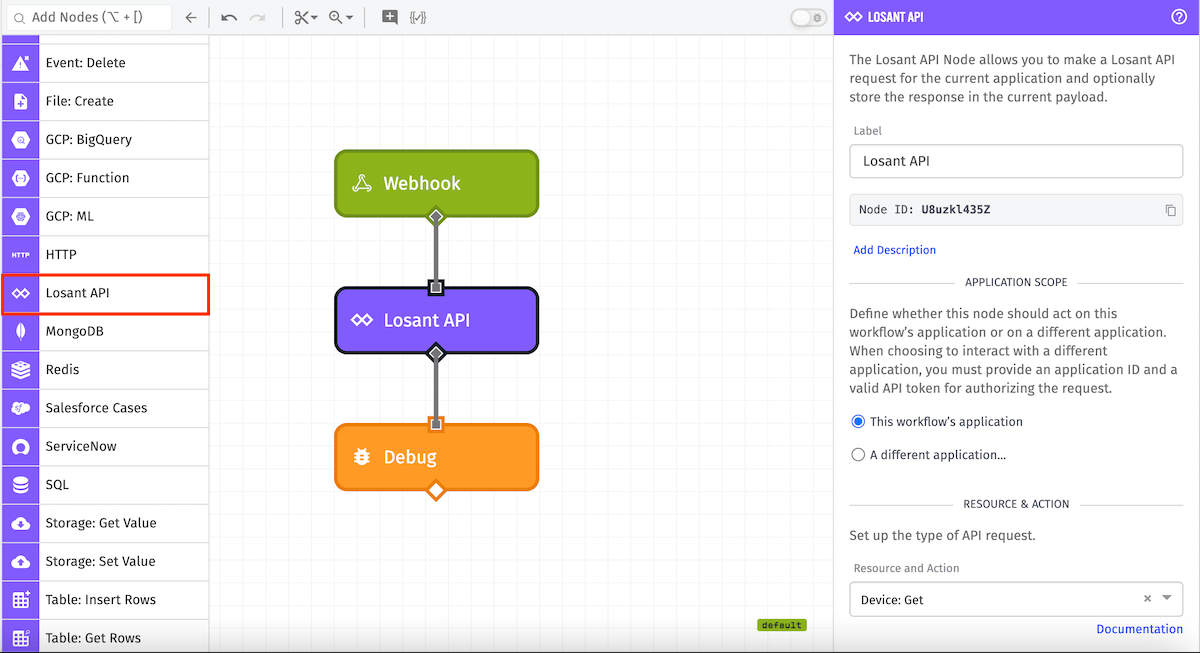

The Losant API Node allows a workflow to make requests (allowing both querying and modification) against the Losant API easily for any resource under the current application.
There are four configuration sections for the Losant API Node: selecting the application, choosing the request to make, configuring the parameters for that request, and determining where to store the result.

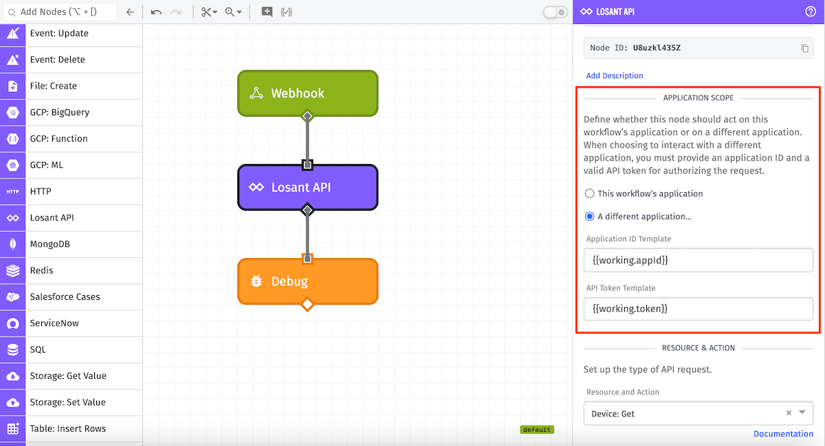

Application Scope
By default the actions performed by this node will take place on the current application. Optionally, you may select A different application...
to perform cross-application actions. This will require an Application ID
and an Application Token. Both fields are templatable.

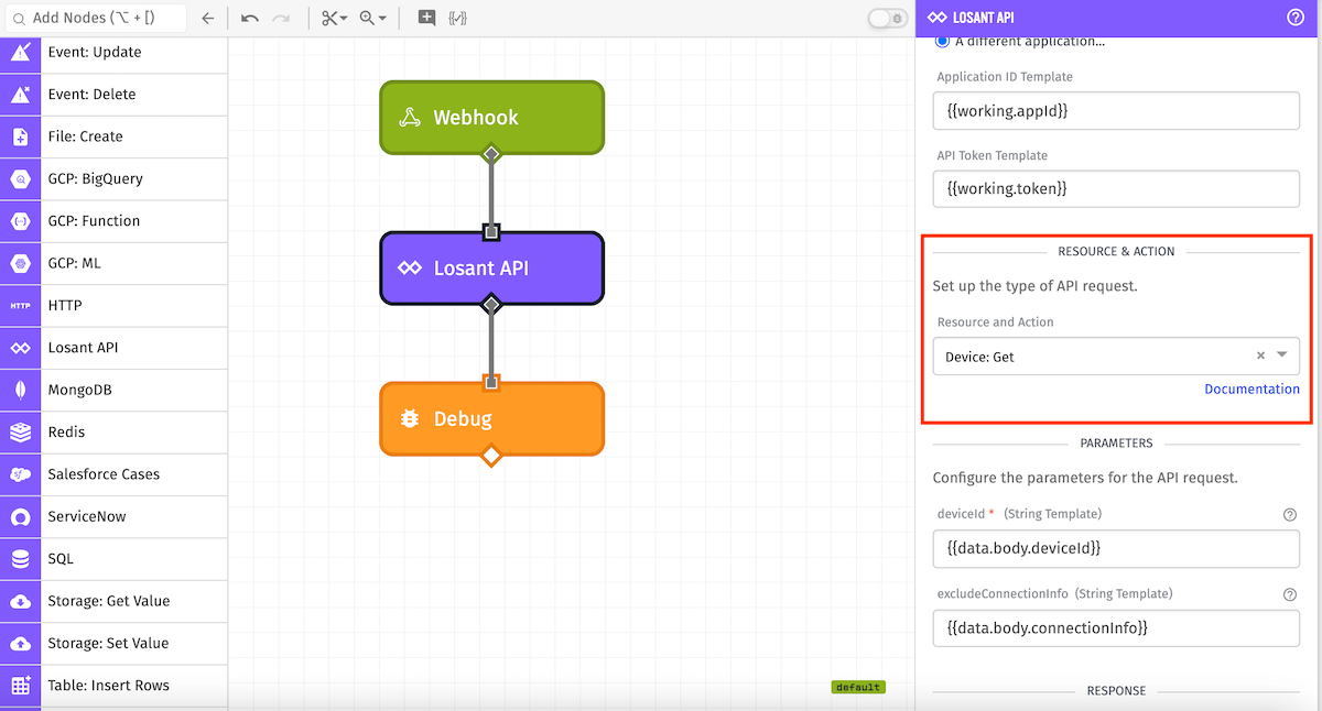

Resource and Action
Once the application is chosen you must select the request to make—specifically the resource and action. Any resource under the current application or under the scope of your Application Token
is available. The dropdown has the list of all resources and their possible actions, as well as short descriptions for each one. In the above case, Device: Get
is selected, which means the Get
action on the Device
resource (i.e. this returns the information about a specific device).

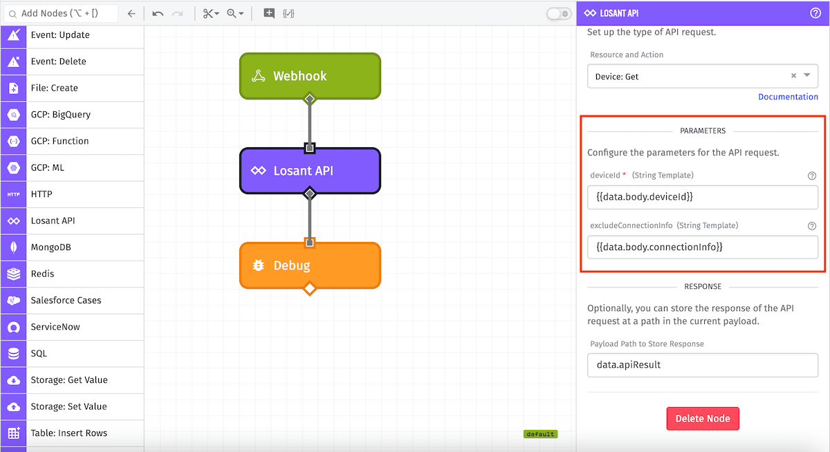

Parameters
Next up is configuring the parameters for the selected resource and action. There are a few requests that have no parameters, and some others that have no required parameters, but most have at least one required parameter. In the above example, the request has one required parameter - the ID of the device that the request should get. There are two types of parameter fields: string templates like the device ID example above, and more complex parameters that are JSON objects. For parameters that are JSON objects, you can either create a JSON template or specify a payload path to pull the desired object off the current payload.

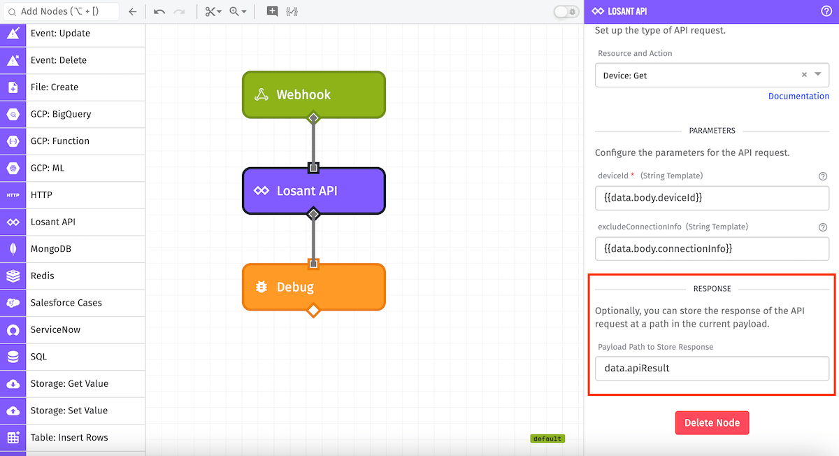

Response
Finally, we can configure a place to put the result of the API request. This is optional, but most of the time you will probably want the result. In the above example, the result will be stored at the payload path data.apiResult
. There are two kinds of results that could be returned - a successful response (with a root key of result
), or an error response (with a root key of error
) if there was something wrong with the request.
