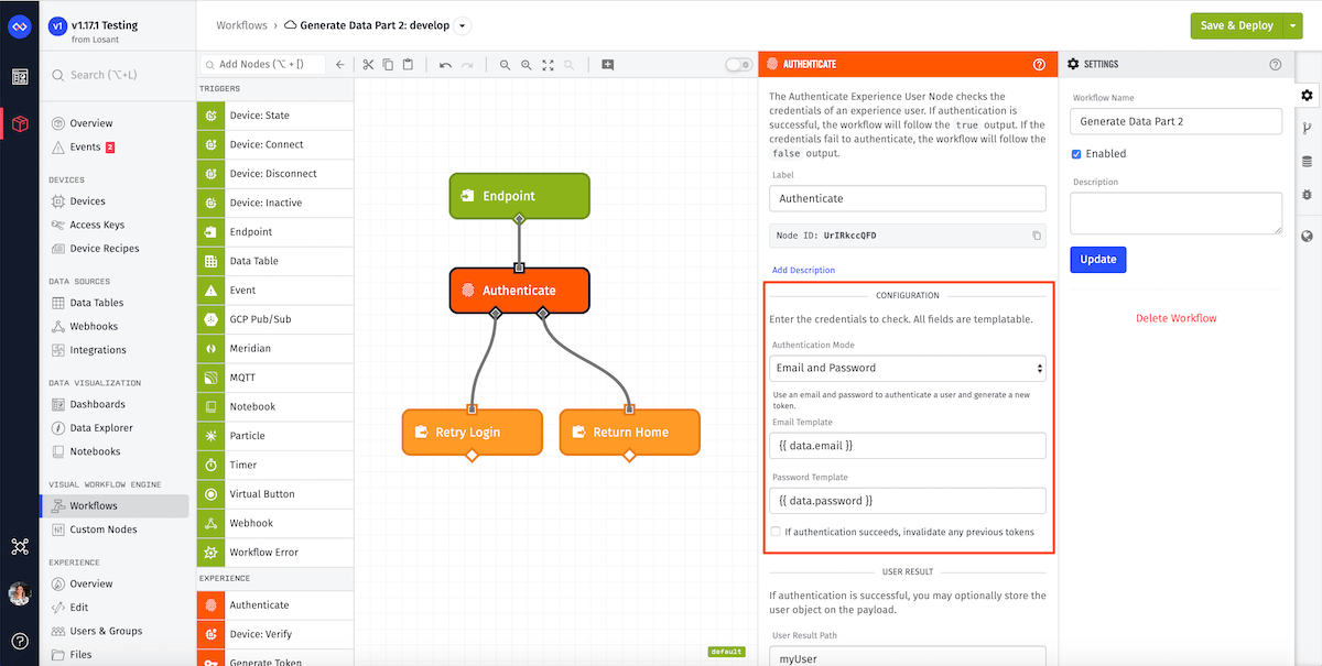

The Authenticate Experience User Node has three sections:
Credentials
Authenticate Experience User Node Config
The Authenticate Experience User Nodes allows you to choose from four combinations of credentials to check. All fields are templatable.
Email and Password
The given email is used to find an existing Experience User in the application, at which point (if one is found), the given password is then hashed and checked against the stored password hash for the found Experience User.
If the password hash matches, this is a successful authentication, and the true (or right) path out of the node is taken. If no user is found or the password does not match, the false (or left) path out of the node is taken.

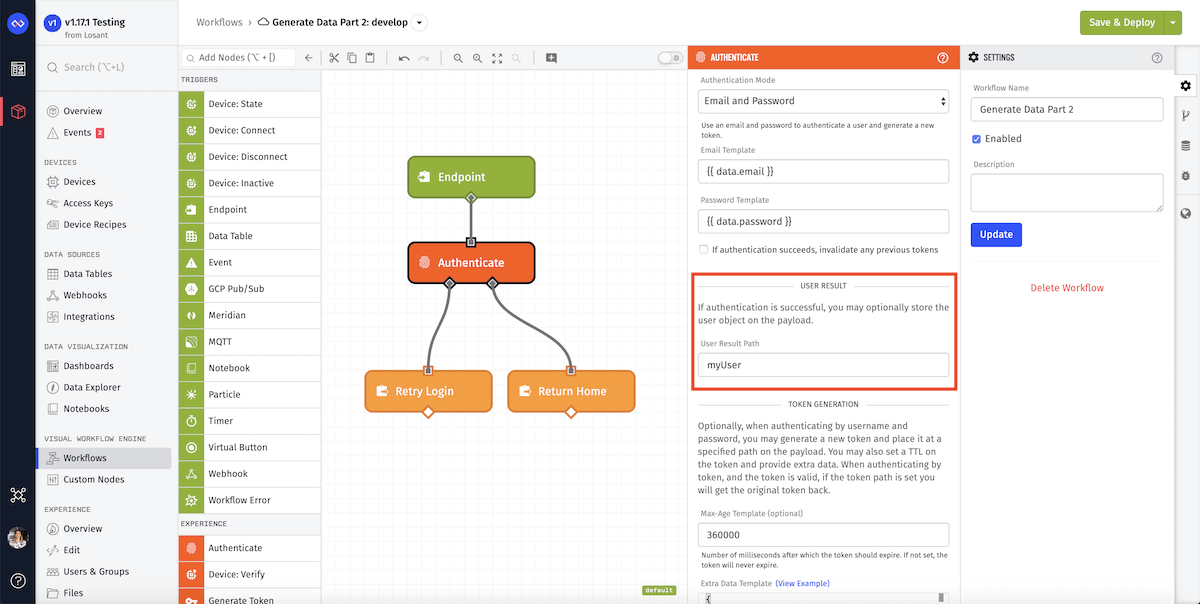

User Result
The User Result Path is a payload path field, and if a path is provided, the successfully authenticated user will be placed on the payload.

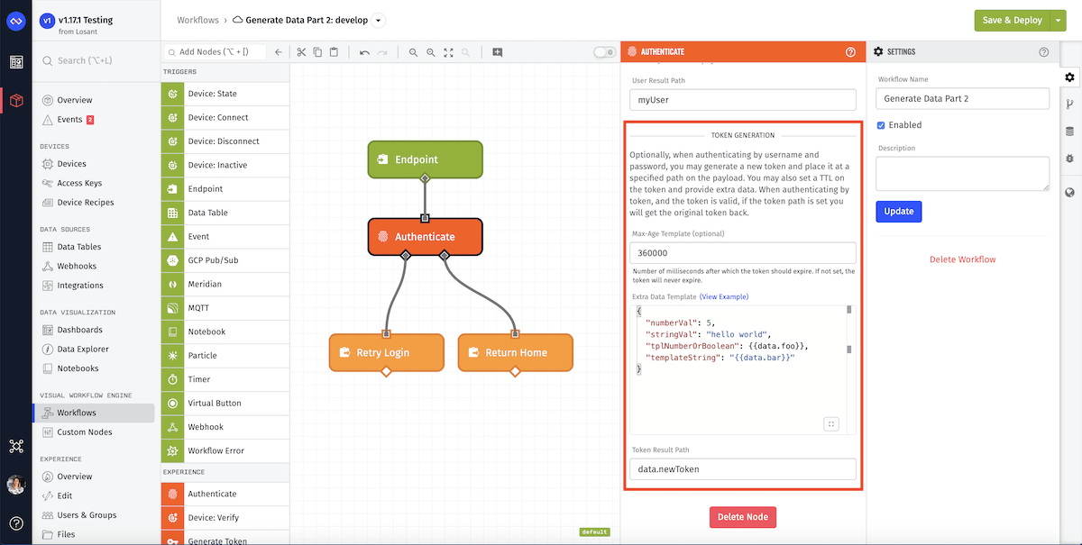

Token Generation
You can generate an authentication token to be stored on the specified payload path. This token can be used to authorize subsequent Experience Endpoints requests.
Experience User Token Generation
Token Result Path
The “Token Result Path” is a payload path field.
When you use any of token authentication methods (Token, Email, and Password, Token and Email, or Token), you will always get the same token except:
When using the “Email and Password”, you’ll always get new token.
Extra Data Template
The “Extra Data Template” is a JSON template field which allows you to add extra data to the token if it is being regenerated.
Extra Data will be carried over to the next token if:
  • No extra data is given.
  • The previous token had extra data.
  • The token is being regenerated.
This extra data is placed on the payload of an Endpoint Trigger.
Max Age Template
If a token is being regenerated and you provide a “Token Result Path,” you may set the Max Age of the token. This number is the number of milliseconds until the generated token expires.
This value is expected to resolve be a positive number. If no number is provided, the generated token will have no expiration date.
