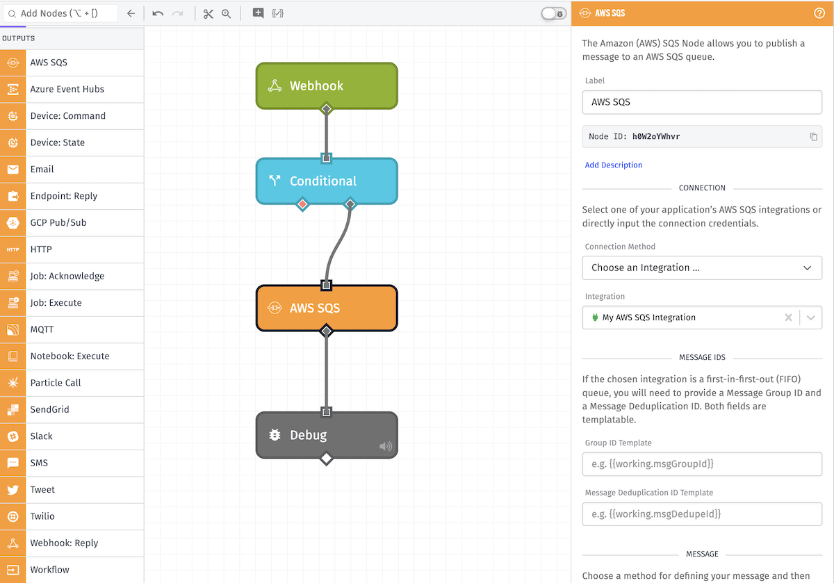

Configuration for the node is broken up into five sections.
Connection
There are three Connection Method options available:
  • Choose an Integration: Retrieves your AWS SQS configuration from the selected Integration.
    • Integration: Choose which of your application's Amazon SQS integrations you would like to publish the message on. The ID is templatable. Note: Integrations are not accessible from Edge Workflows, so only direct configuration is available to them.
  • Choose a Service Credential: Retrieves your AWS credentials from the selected service credential.
    • Credential Name Template: Choose which of your application's AWS service credentials you would like to use. Note: Service credentials are not accessible from Edge Workflows, so only direct configuration is available for them. This field is templatable.
  • Enter Credentials: Configure the AWS SQS connection directly within the node. All fields are required.
    • AWS Region Template: The AWS region where the SQS queue is located. This field is templatable.
    • AWS Access Key ID Template: The AWS access key ID associated with the AWS account you wish to use to access the SQS queue. This field is templatable.
    • AWS Secret Access Key Template: The AWS secret access key associated with the AWS account you wish to use to access the SQS queue. This field is templatable.
    • SQS Queue URL Template: The URL of the SQS queue you wish to interact with. This field is templatable.
