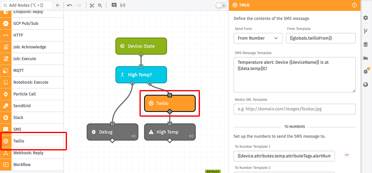

Next, configure the content of the SMS message ...
  • Send From: Choose whether to send the message from one of your Twilio phone numbers or from an SID.
  • From Template: Depending on the "Send From" choice, provide a string template that resolves to either a phone number or an SID in this field. This value must be associated with your Twilio account provided in the Twilio configuration.
  • SMS Message Template: Provide the body of the message. This should resolve to a short, plain-text message.
  • Media URL Template: Optionally, you may also provide a publicly available URL to a multimedia object to include as an attachment.
Either the SMS Message Template or the Media URL Template must be provided; you may also provide both.

Provide at least one phone number to send your message to. Multiple recipients can receive the same message, and those recipients can be provided through a combination of the following methods ...
  • One number per line.
  • Multiple numbers per line, separated by commas (,) or semicolons (;).
  • A string template referencing a phone number, a string of comma- or semicolon-separated numbers, or an array of phone numbers on the payload.
