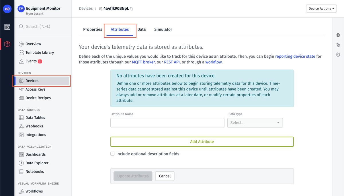

A device's attributes can be viewed, created, and modified by doing the following:
  1. Navigate to a Device page.
  2. Select the "Attributes" tab.

Each attribute requires two properties (except system devices and Blobs):
Attribute Name: Must contain only uppercase and lowercase letters, numbers, hyphens (-), and underscores (_).
Many applications will use the same attribute name (such as temperature) across multiple devices. You may perform aggregations on attributes of the same name across devices.
Data Type: Type of data that will be reported against the device. The default value is "Number".

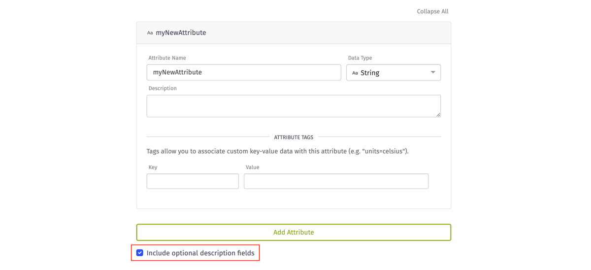

Including Optional Fields​
Optionally, you can choose "Include optional description fields" to include an attribute's description and tag fields when creating new attributes.
Device Attributes Include Optional Fields

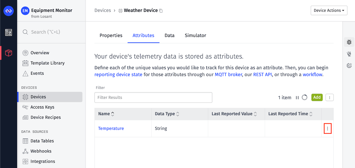

Viewing Device Attributes​
After creating an attribute, a device attributes table will be displayed showing the attribute name, data type, last reported value, and last reported time. The attributes last reported value and time will be refreshed every 30 seconds. You may also perform a manual refresh.
Depending on the data type of the attribute, the last reported value may be formatted differently. For example, a boolean attribute will be displayed as either True or False. A number attribute will be displayed as a number, and a string attribute will be displayed as a string. A blob attribute will be displayed as a link to the blob. A GPS attribute will be displayed as a link to Google Maps.
Attributes Table

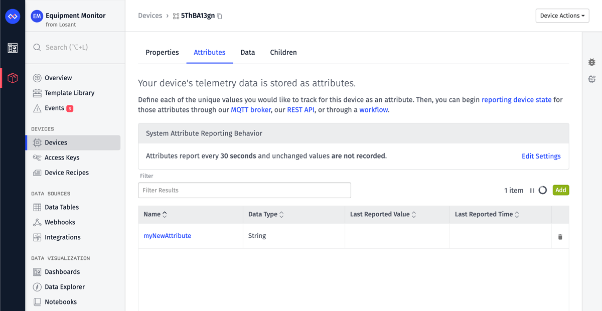

A System device also displays the current "System Attribute Reporting Behavior" setting shown below.
System Device Attributes Table

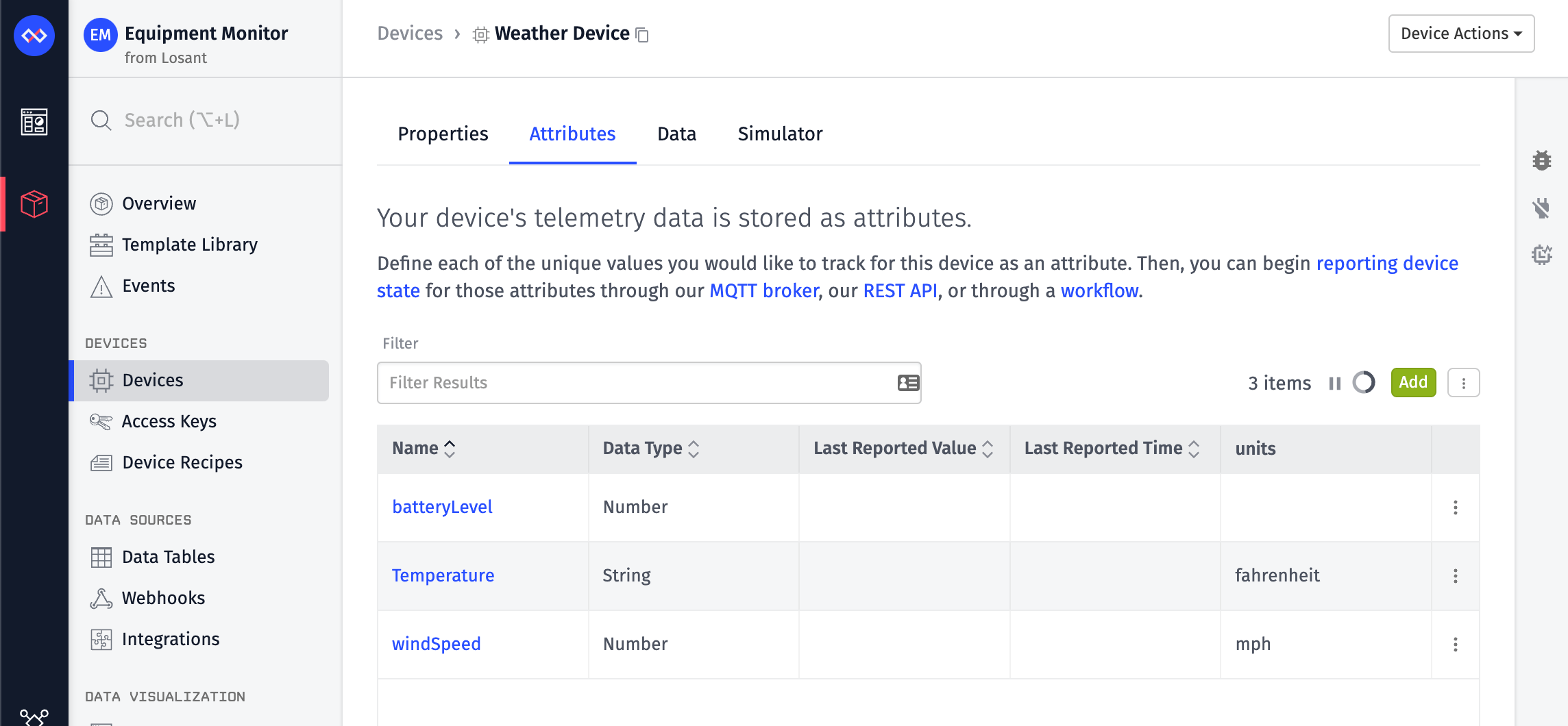

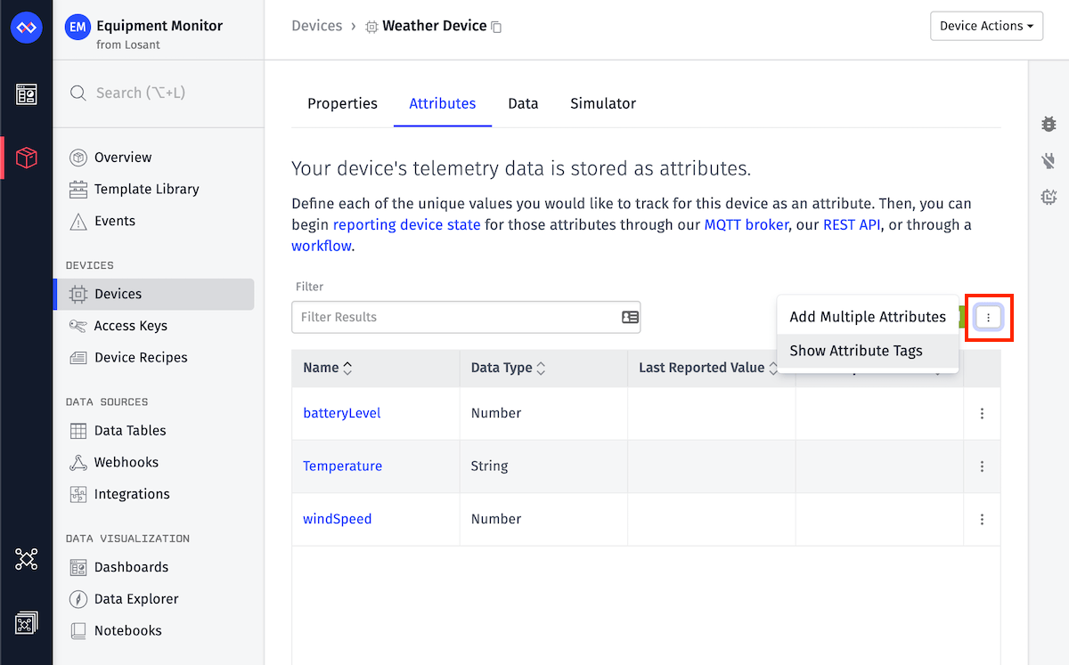

Viewing Attribute Tags​
Show Attribute Tags

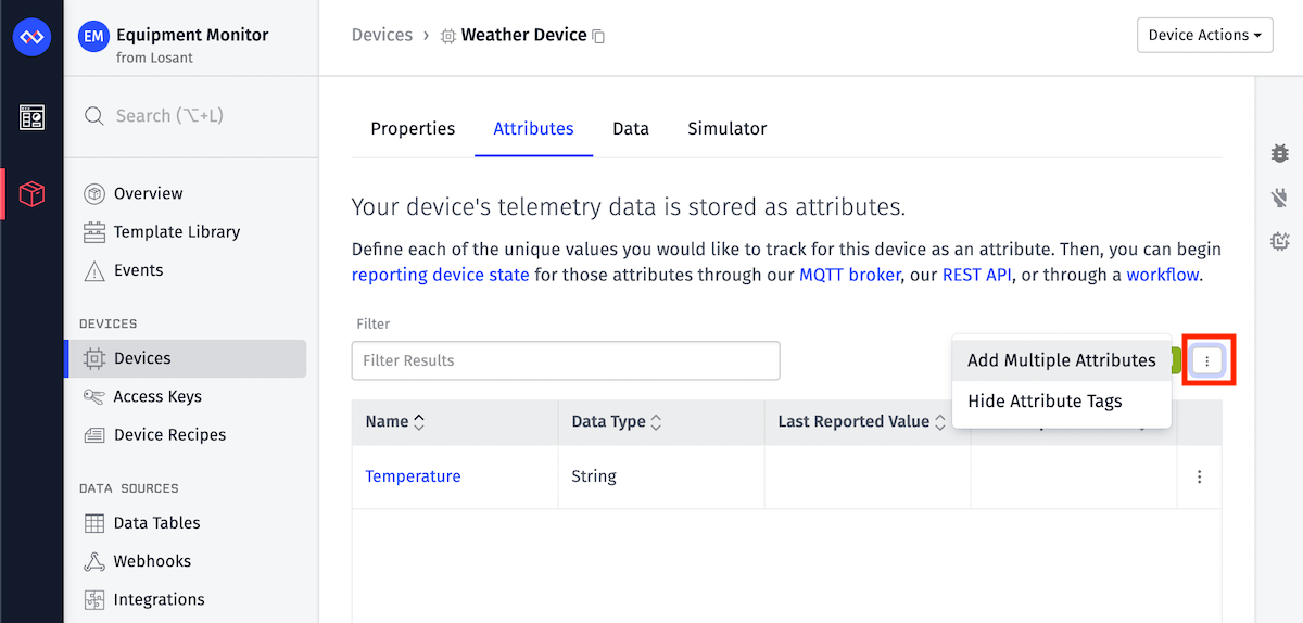

If you'd like to view all of your attribute tags at once, you can click the dropdown menu icon at the top right of the table and select "Show Attribute Tags".
Attribute Tag Columns
The table will now show columns for each attribute tag key that has been created. If an attribute has a value for a given key, it will show that value in its respective row.
To hide the tag columns, reopen the dropdown menu and select "Hide Attribute Tags".

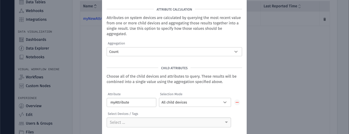

  • System Attribute Calculation: System device attributes allow for modifying the behavior for calculating an attribute's value, including its Aggregation Method and Child Attributes (the names of the child attributes and the child devices to pull the values from).

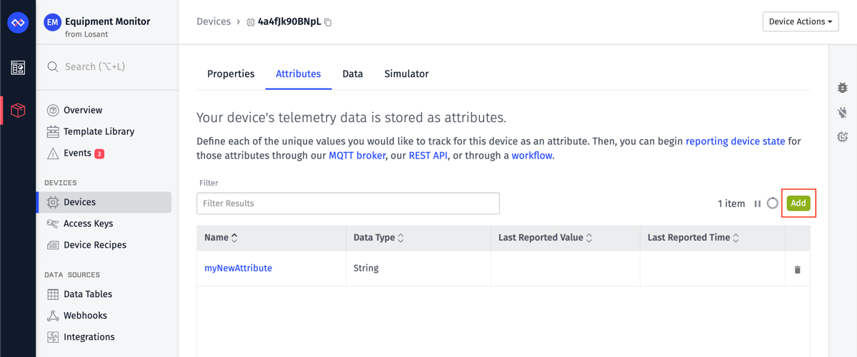

Adding Additional Attributes​

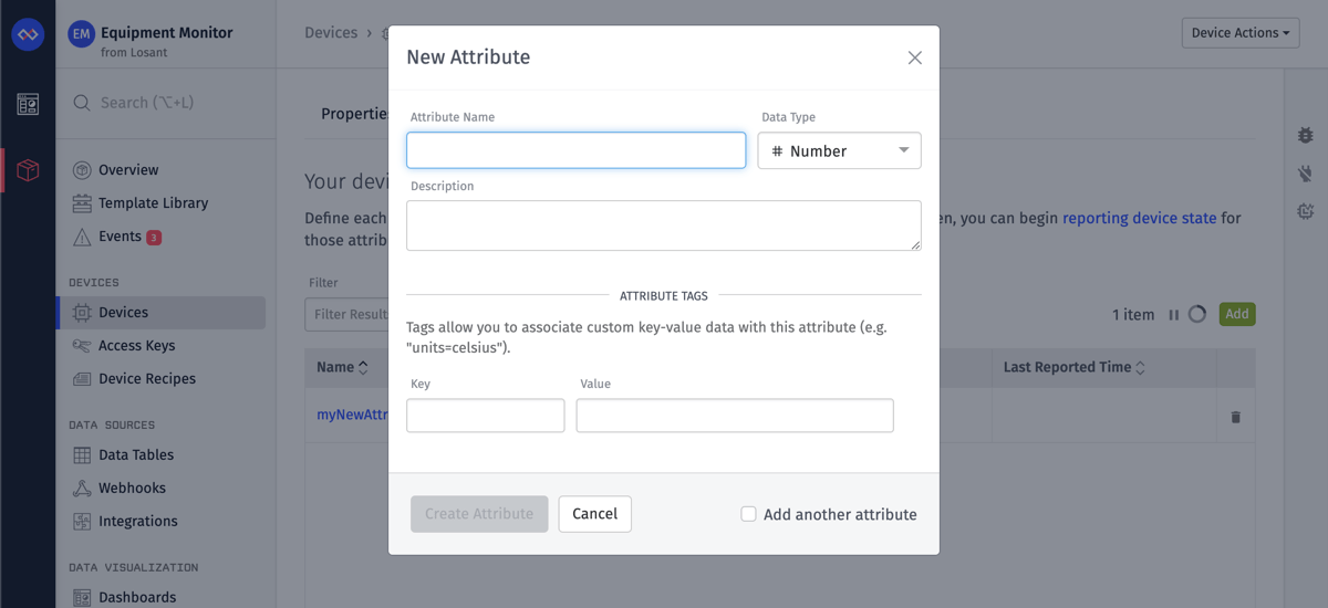

Click the "Add" button located above the attributes table over on the righthand side of the screen to add a new attribute.
Add Attribute
A new attribute form will be displayed where you can enter the attribute name, data type, description, and attribute tags. For system devices, you can select the aggregation method for the last reported value of each child device attributes. After selecting the aggregation method, you can to choose which child device attributes to include in that calculation.
Clicking on "Add another attribute" checkbox will allow you to add additional attributes without closing the modal after submission.

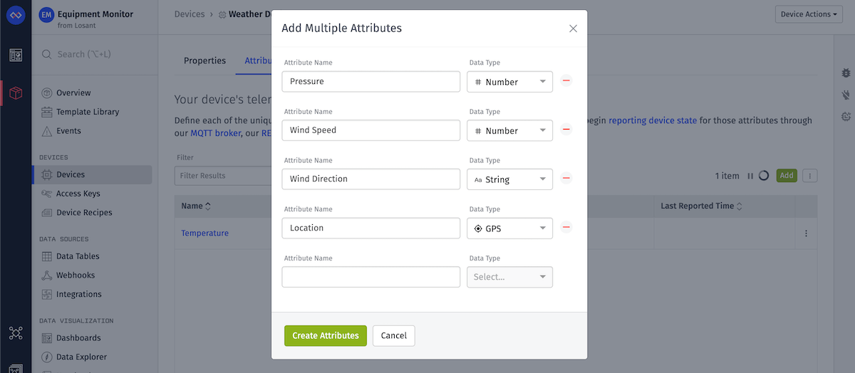

Adding Multiple Attributes​
Multiple Attributes Button
If you wish to quickly create multiple attributes at once, click the dropdown menu icon at the top right of the table and select "Add Multiple Attributes". This option is only available for non-system devices.
From here you may define the name and type of each attribute you are adding.
Note: You will not be able to define attribute descriptions or tags via this method; however, you may modify the attributes after submission to add these properties if necessary.

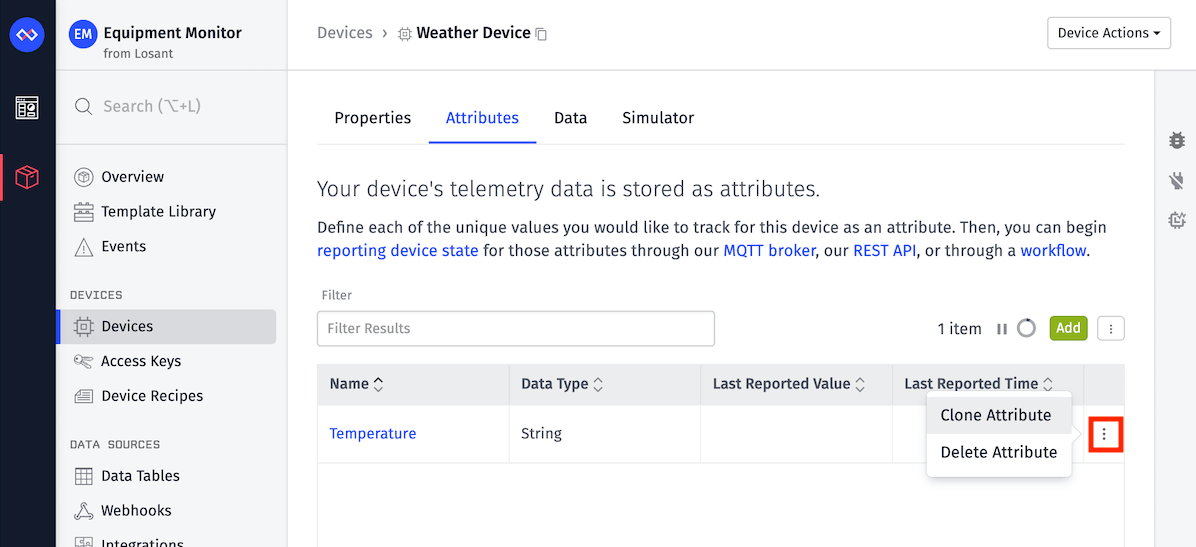

Cloning Attributes​
Clone Attribute
To clone an existing attribute, click the dropdown menu icon at the right edge of the attribute's row. From there you may click "Clone Attributes". This will open the "New Attribute" modal with all but the name field prepopulated.
