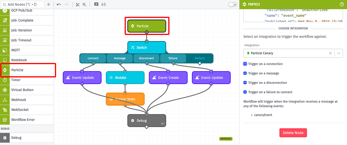

Particle Trigger
The Particle Trigger fires a workflow whenever an event is received on the selected Particle integration or the integration receives a connection event.
Particle Trigger
The Particle Trigger requires choosing a Particle integration, as well as at least one of the following events on which to fire the trigger:
  • Trigger on a connection
  • Trigger on a message (checked by default)
  • Trigger on a disconnection
  • Trigger on a failure to connect
After selecting a Particle integration, a summary of the event names that will cause the trigger to fire will appear beneath the selector.
