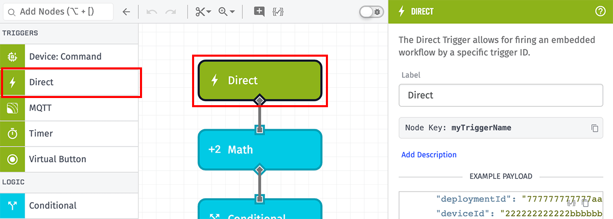

Direct Trigger
The Direct Trigger fires an Embedded Workflow whenever the eea_direct_trigger method is invoked within the Embedded Edge Agent.

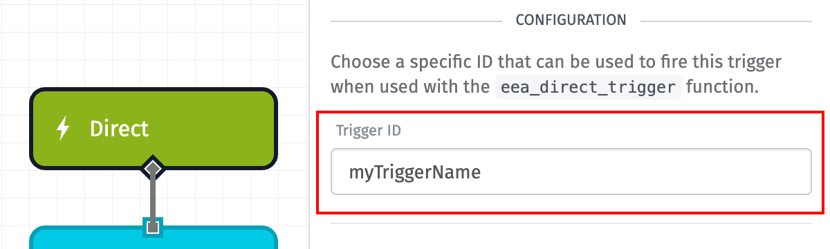

The trigger only takes one argument: an ID assigned to the specific instance of the Direct Trigger. Whenever eea_direct_trigger is invoked on your Embedded Device, this trigger will fire if the ID passed in as the first argument matches the ID provided within the trigger's configuration.
The ID does not need to be unique across multiple Direct Triggers in the same workflow, nor in Direct Triggers across other Embedded Workflows deployed to the device. Invoking eea_direct_trigger with an ID that is used in multiple places will fire each of the Direct Triggers targeting that ID.
Direct Trigger Configuration
