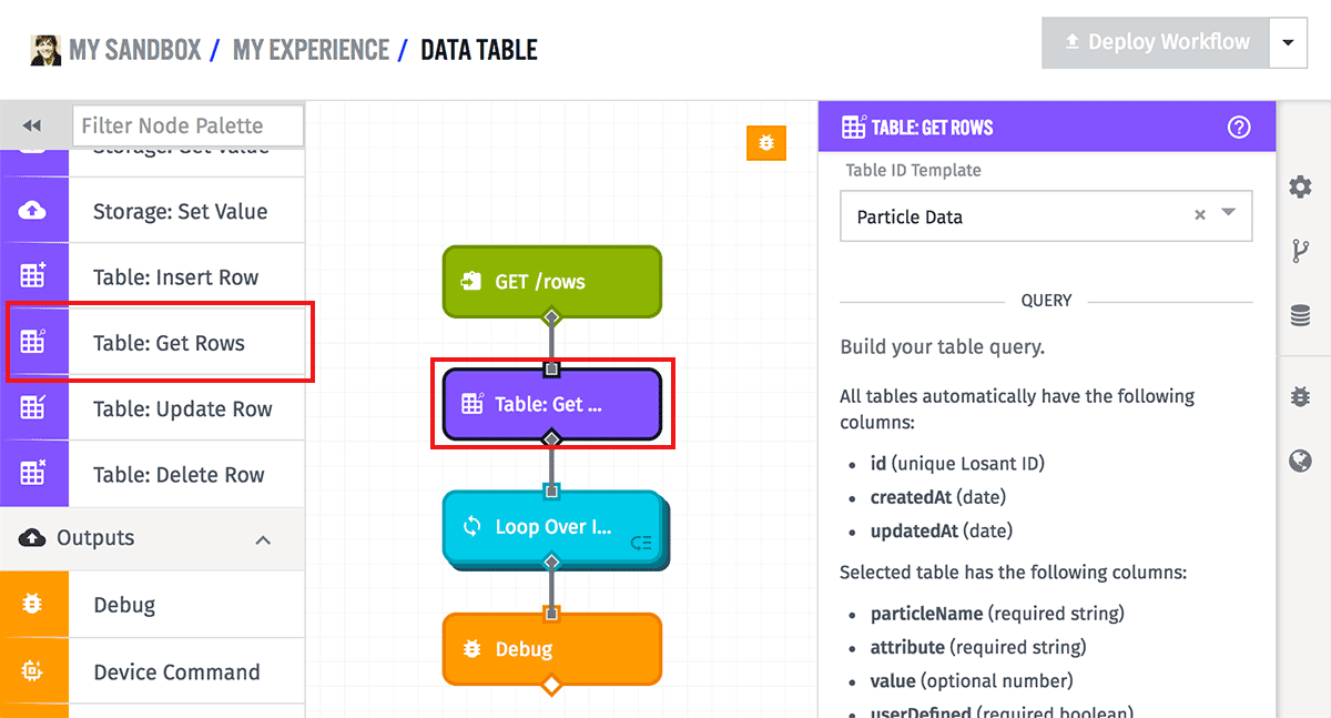

The Table: Get Rows Node takes a number of parameters, most of which are optional.
Required Fields​
  • Table ID Template: The table on which the query should be performed. You may select one of your application's tables or enter a string template, which should resolve to a valid table ID.
  • Result Path: A payload path defined at the bottom of the editor for where the result of the query will be stored. This result will include the query itself, the items returned, and additional metadata (count, total count, offset, limit, sort information); or, if an error occurs (e.g., the table is not found or the query is invalid), the result will include an error object.

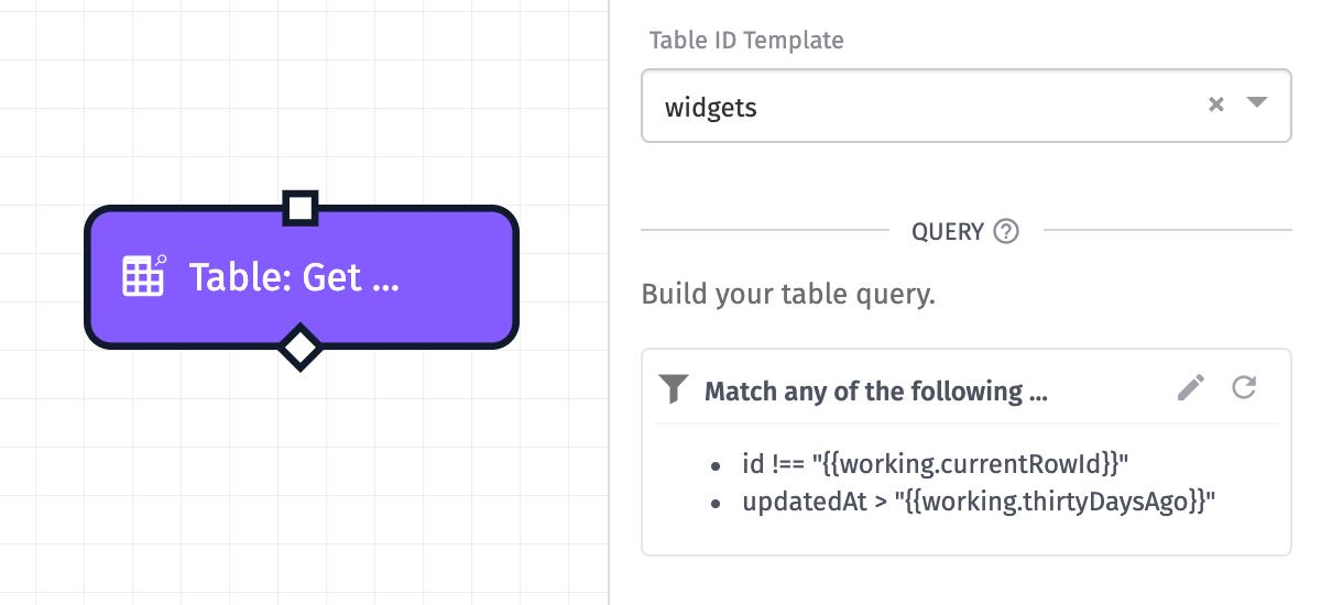

Query Fields​
Building your query within the node is nearly identical to building a query within the table browsing interface. The only difference is, when building a query within the node, you may use string templates for each property and value – or, if building in Advanced Mode, you may use a JSON template.
Get Rows Query
The query section is optional. If you do not include any queries, all rows will be returned and then limited by the filter fields defined below. However, if you do include any piece of a query (e.g. the Property), you must also include the other two pieces (the Operator and the Value).

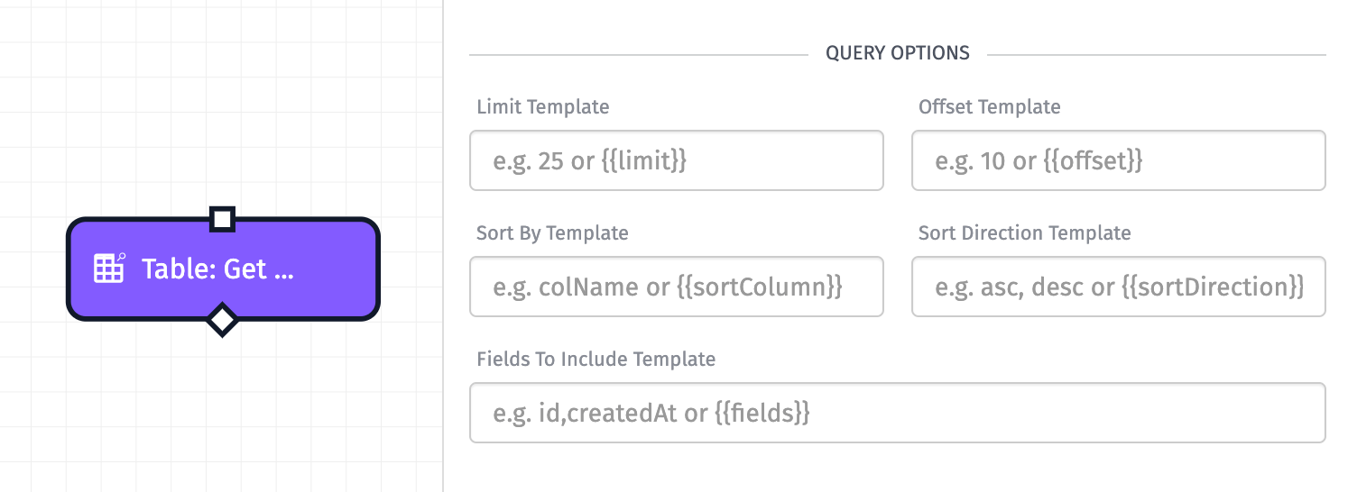

Optionally, you may also include some parameters for sorting, limiting and paginating the results of the query. All of these fields are templatable.
Get Rows Filter
  • Limit Template: must be a number between 0 and 10000, or a template that resolves to such a number. Default is 1000. A limit of 0 returns an empty items array while still reporting the number of rows matched by the query in totalCount.
  • Offset Template: must be a number greater than or equal to 0, or a template that resolves to such a number. This is similar to requesting a specific page of results, except you are defining the number of records to skip instead of a page to return. Default is 0.
  • Sort By Template: is the field by which the results should be sorted. If using a template, this should resolve to one of your table's column names or one of the default columns. Default is id.
  • Sort Direction Template: must be either asc, desc or a template that resolves to one of those values. Default is asc.
  • Fields To Include Template: allows you to control the exact columns returned for the resulting rows. By default, all columns are returned. You can restrict to specific columns by providing a comma delimited list of column names.
