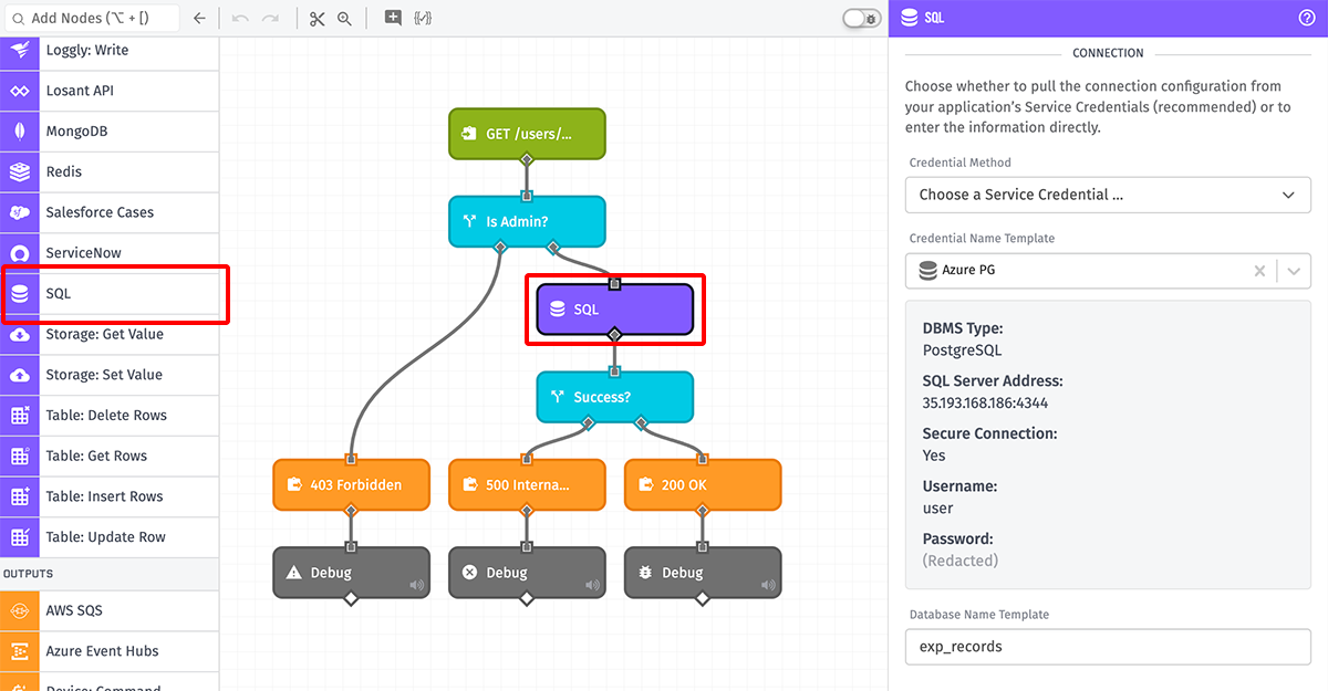

The SQL Node allows a workflow to query or update values in a SQL database and optionally store the result on the workflow payload.
Currently supported SQL database servers include:
SQL Node
The configuration of the SQL Node can be broken down into four major sections - configuring the connection, configuring connection encryption (optional), creating the SQL query, and choosing what to do with the result.
SQL Connection
SQL Node Connection Configuration
SQL connection configuration contains up to six fields:
  • Database Management System (DBMS): (Required) MSSQL, MySQL, PostgreSQL, or SQLite 3 (Edge only)
  • Server Address: (Required) String or template, e.g. 127.0.0.1
  • Port Number: (Optional) Number or template, integer between 1 and 65535
  • Username: (Optional) String or template.
  • Password: (Optional) String or template.
  • Database Name: (Required) String or template.
