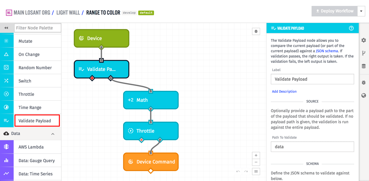

The Validate Payload Node allows a workflow to check part or all of the current payload against a JSON schema (draft-04) and branch depending on whether the payload passes validation.
The Validate Payload Node is configured using a JSON Schema definition that conforms to the draft-04 specification. A part of or all of the current payload of the workflow is validated against the given JSON schema, and if it passes validation the route on the right out of the node is taken. If it fails validation, the route on the left out of the node is taken.

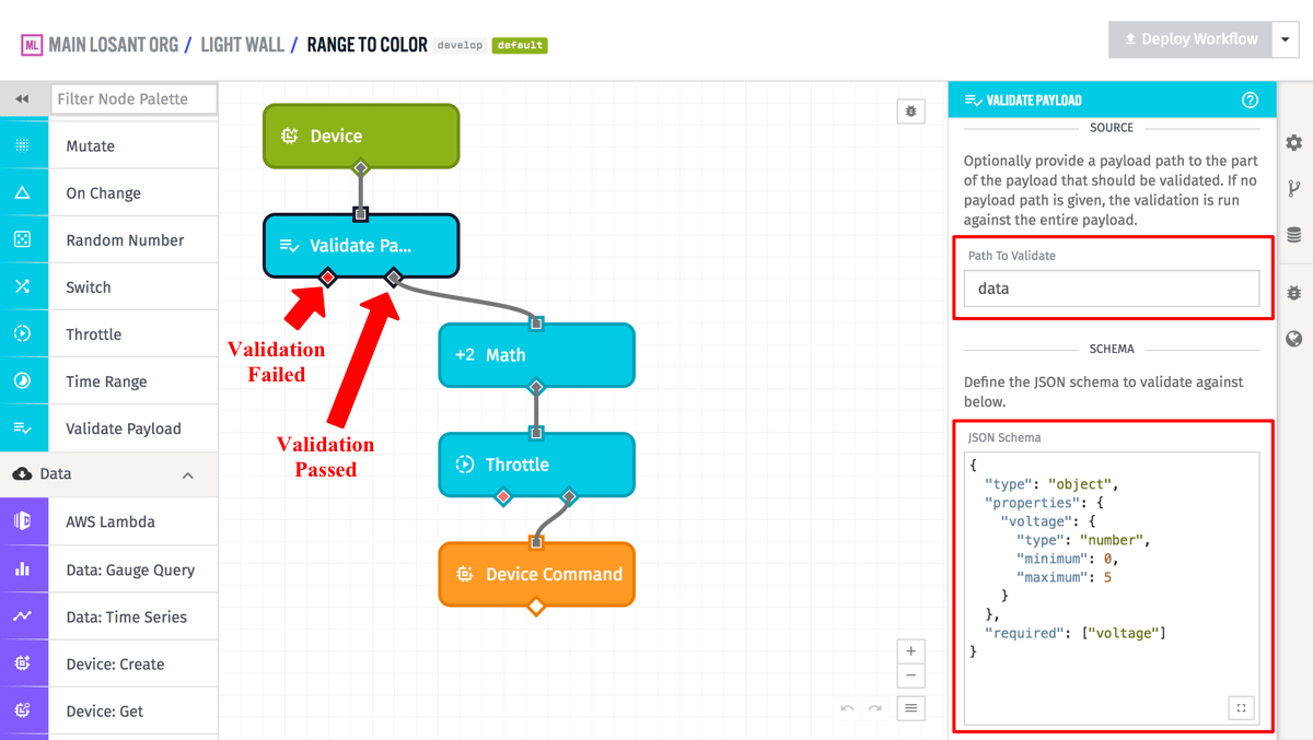

Validate Payload Example
In the above example, the node is validating the data property of the payload against a schema. Here is the full schema from the above screenshot in an easier to read form:
"type": "object",
"properties": {
"voltage": {
"type": "number",
"minimum": 0,
"maximum": 5
"required": ["voltage"]
The workflow will follow the route on the right out of the Validate Payload Node and proceed to the Math Node only if the payload has a data.voltage field whose value is a number between 0 and 5.
So the following payload would pass validation, and the workflow would take the route on the right and move on to the Math Node:
"voltage": 1.7
But this next payload would not pass validation, and so the workflow would take the route on the left - which in the example above goes nowhere, and so the current execution of the workflow would stop:
"voltage": "not a number"

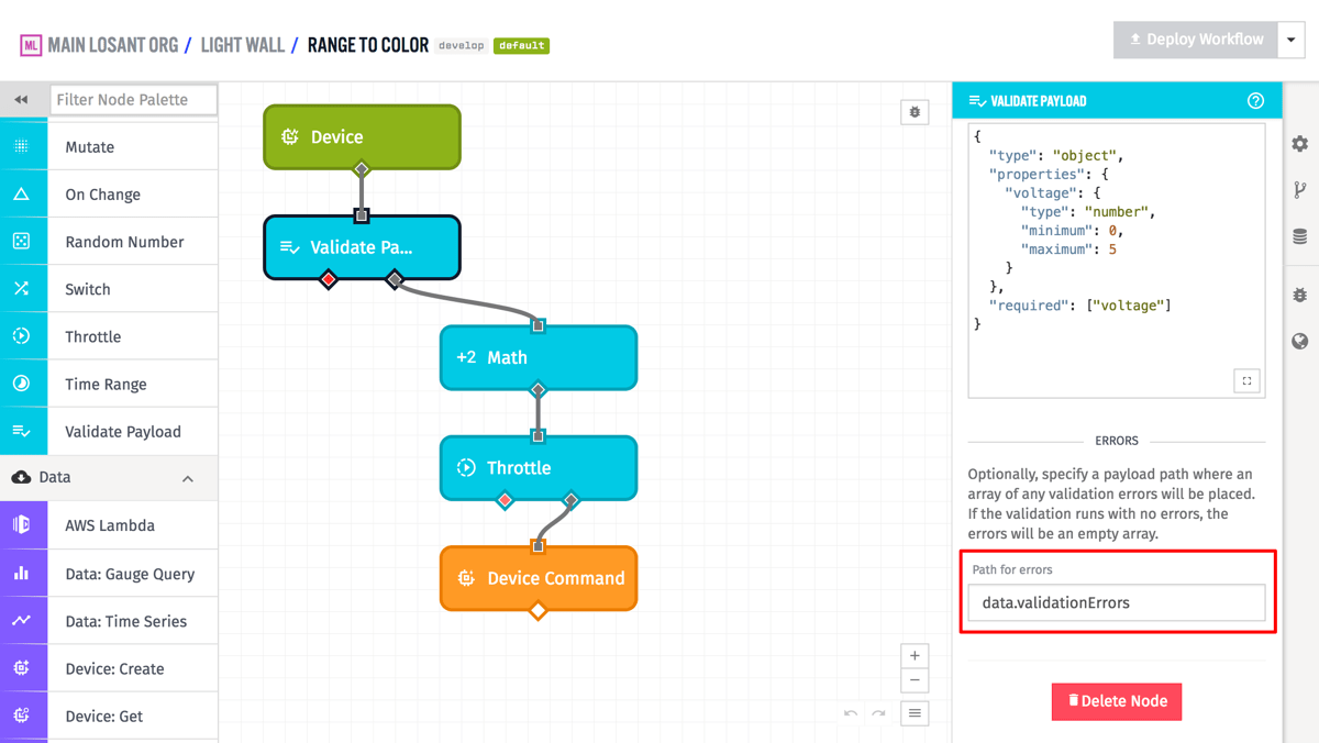

Validate Payload Errors
Optionally, any errors from validating the payload can be placed on the payload at a payload path. If this path is provided and there are no errors, the value at the path will be set as an empty array. If there are in fact errors, it will be an array of error objects. For example, in the "not a number" payload case above, if the error path was set to data.validationErrors, the payload after the Validate Payload Node would look like the following:
"voltage": "not a number",
"validationErrors": [
"field": "data.voltage",
"message": "is the wrong type"
