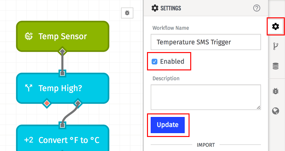

Enabled Status
Enable Workflow
Application workflows can be enabled or disabled with a simple toggle. Disabling a workflow stops any triggers from firing in any of its versions. This can be done either from your application's list of application workflows or within the "Properties" tab of the application workflow editor.

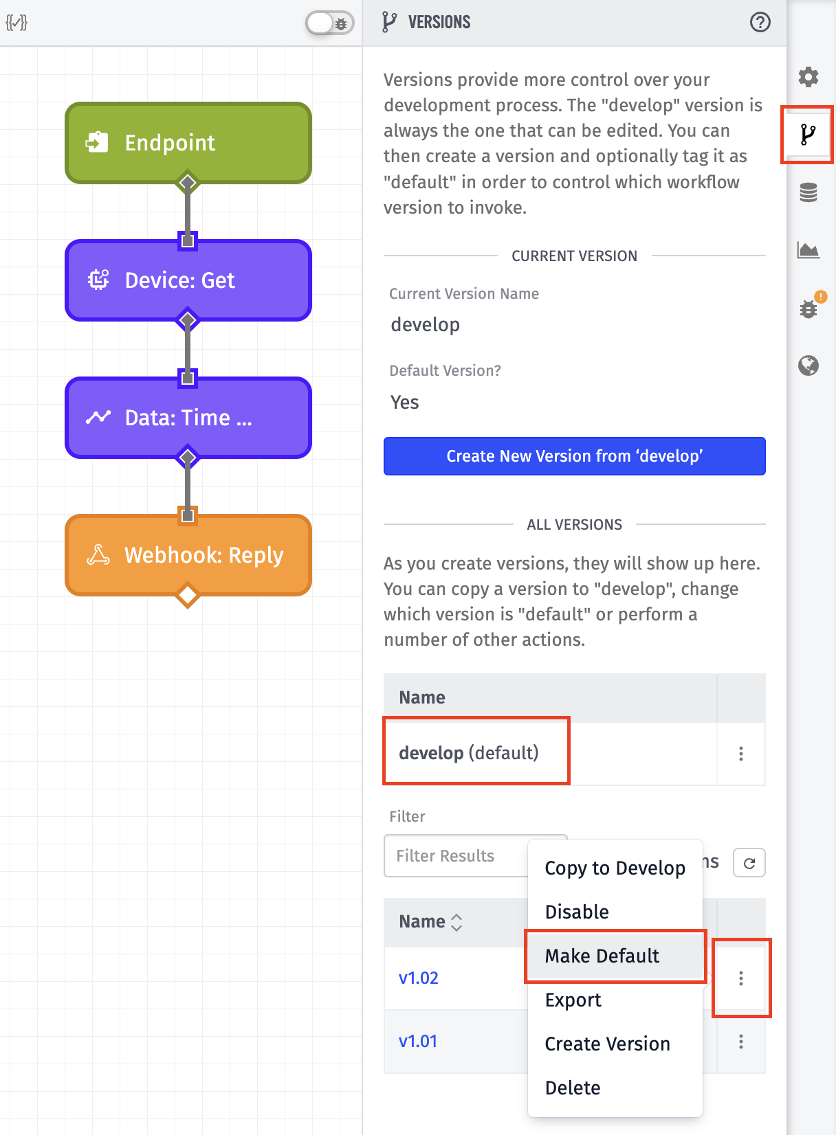

Default Version
Workflow Default Version
Application workflows have the concept of a "default version", which is the version of the workflow to run in the absence of the version being specified in the trigger event. Some triggers, such as the Endpoint Trigger, can target a specific version of your workflow. Conversely, other triggers, such as the Timer Trigger, will only ever fire on the default version.

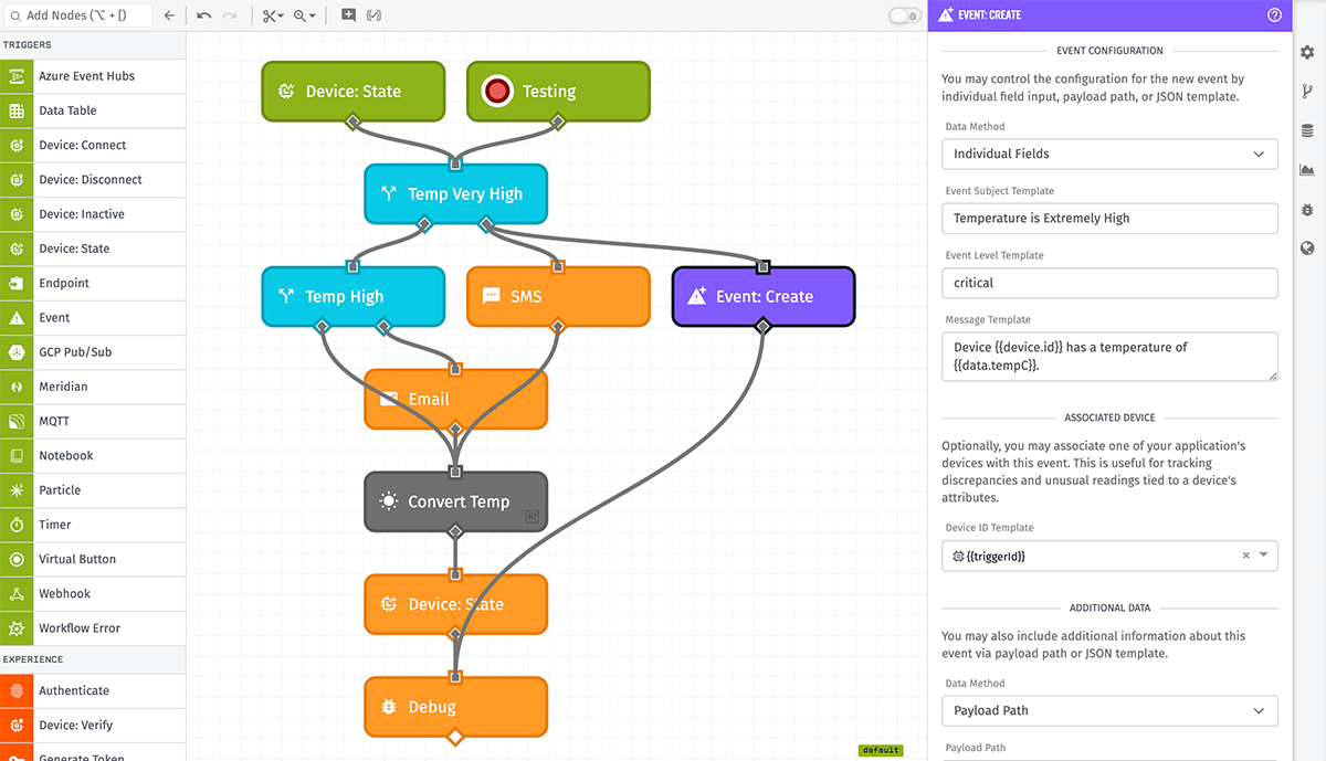

Saving and Deploying
Workflows are saved and deployed using the Save & Deploy button.
Deploy Workflow
The button will be green whenever there are changes that can be deployed. It will be gray when there are no changes. Once a workflow has been saved and deployed, its changes will take effect immediately.
If you are viewing a workflow version, the button will not allow the deployment of any changes; instead, it will allow you to return to the develop version.
