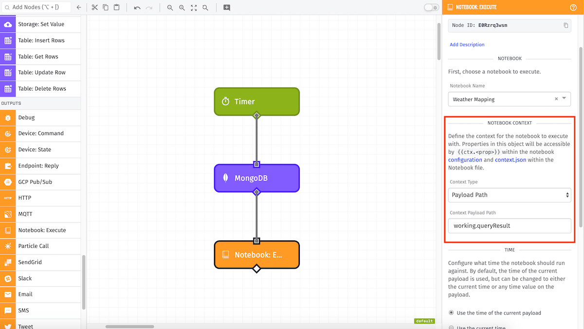

Notebook: Execute Node​
The Notebook: Execute Node allows a Workflow to pass in payload data as your notebook's context.
Execute Node Context
The example above uses the MongoDB Node to query a MongoDB database for additional data to provide as context to be used in notebook processing.

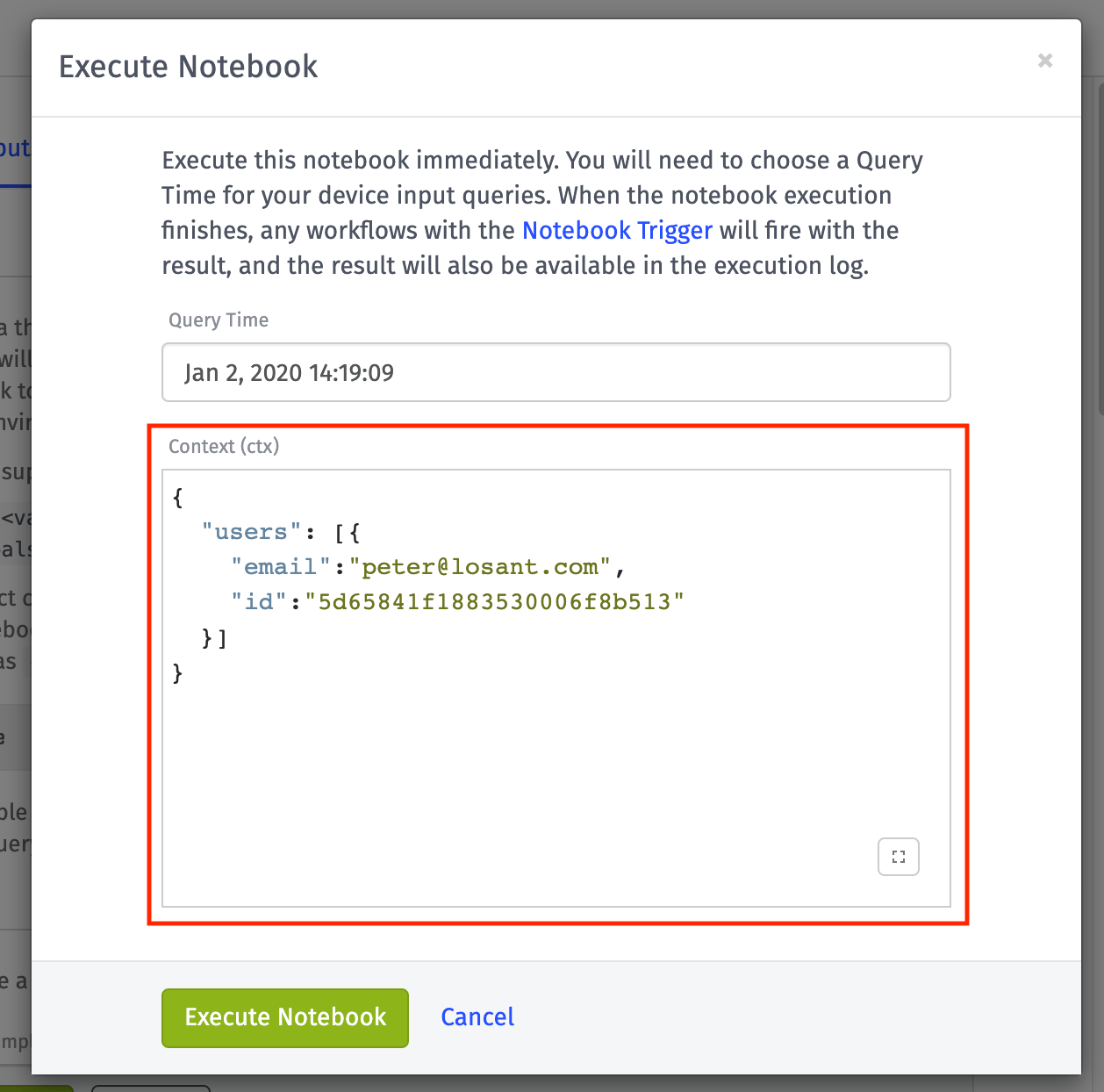

Manual Execution​
When manually executing a Notebook you will have the option to provide JSON to use as context:
Manual Execution Context

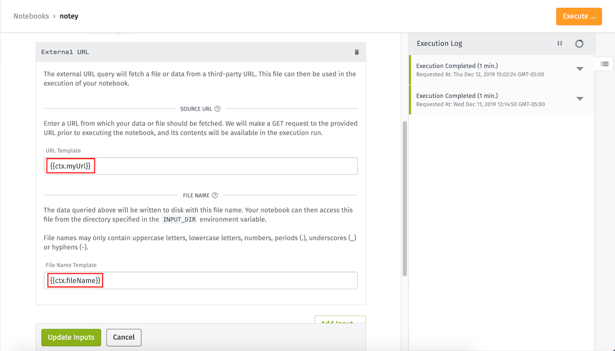

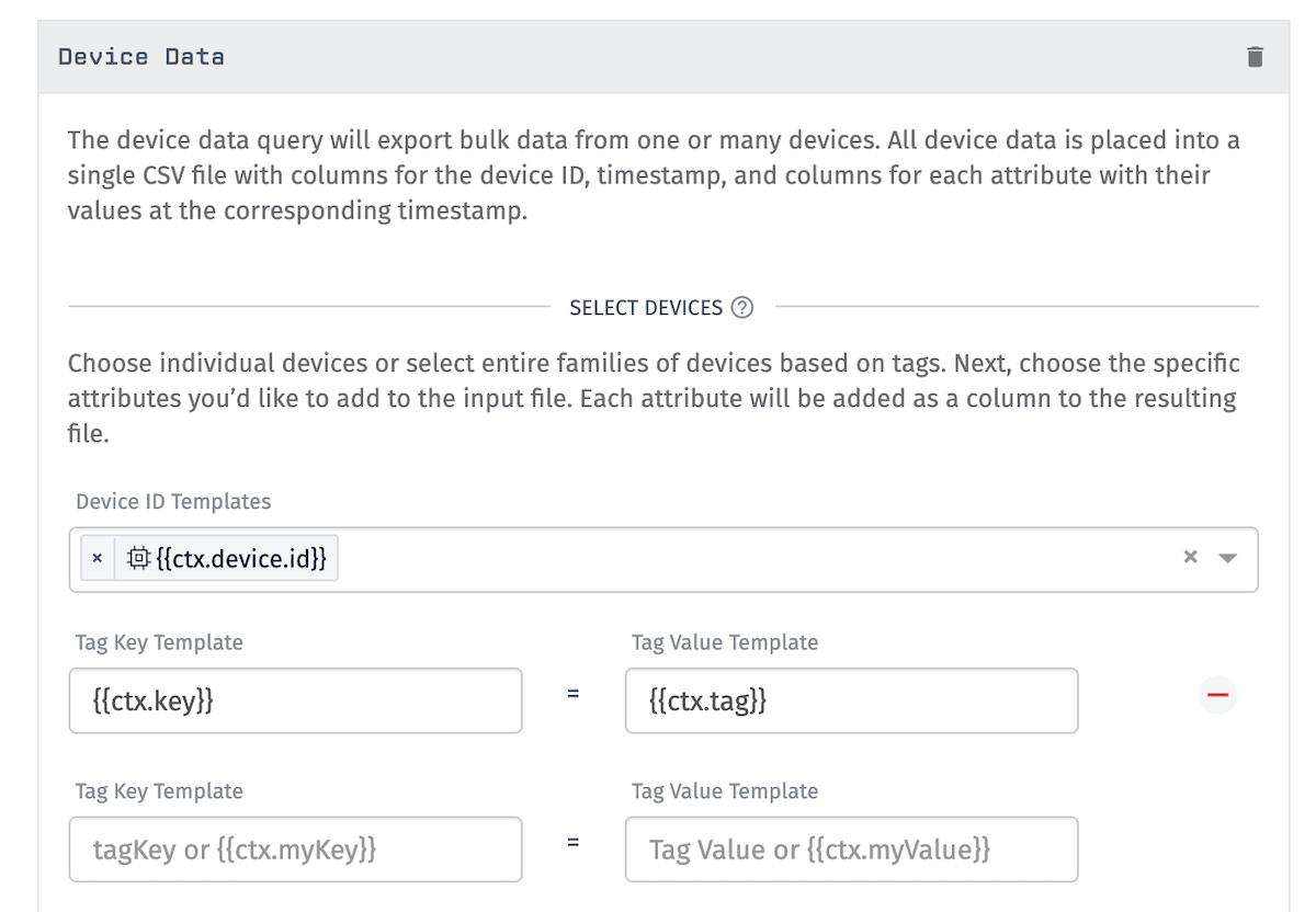

Configuration Template​
Context are accessible by using templates in the configuration for Notebook Inputs and Notebook Outputs:
Notebook Config Context
