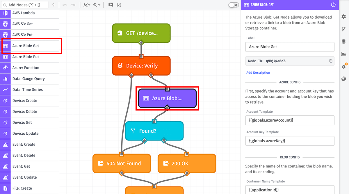

Azure Blob: Get Node
The Azure Blob: Get Node allows a workflow to download or retrieve a link to a blob in an Azure Blob Storage container.
There are four main configuration sections for the Azure Blob: Get Node …

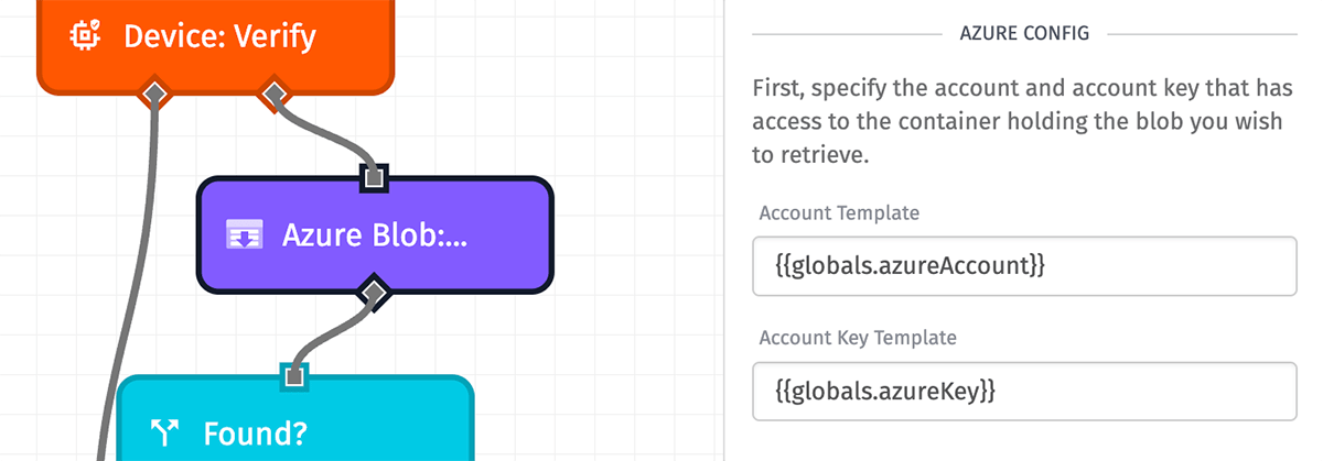

Credential Configuration
Azure Blob: Get Node Credentials
There are two parts to configuring credentials, and both of them are templatable:
We recommend that you create an account key specifically for use in Losant workflows (keys that only have access to the proper Azure Blob container).
We also recommend that you store these values as workflow globals.

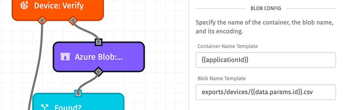

Blob Configuration
Azure Blob: Get Node Config
Next is to configure the fields required by Azure Blob Storage. All applicable fields are templatable:
  • Container Name: (Required) The name of the container within the configured storage account.
  • Blob Name: (Required) The name of the blob to download.

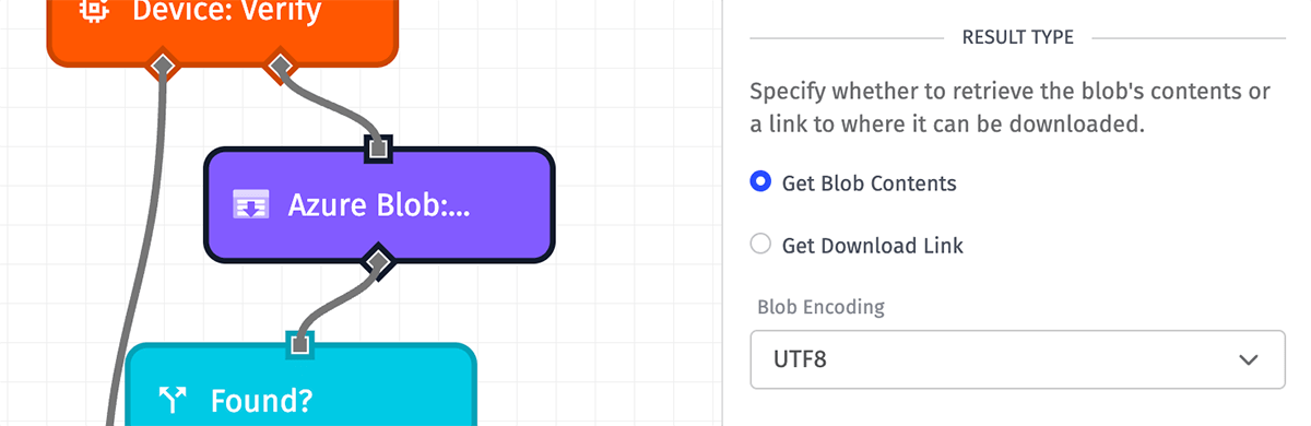

Result Type
Azure Blob: Get Node Result Type
Now, determine how you would like the blob returned:
  • Get Blob Content: Returns the actual content of the blob and places it on the workflow payload. If your file is especially large, it is recommended to not select this option. When opting to return the blob content, you must also specify the Blob Encoding (defaults to UTF8).
  • Get Download Link: Selecting this option places a signed URL on the workflow payload to where the blob can be downloaded.

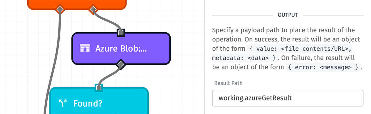

Output
Azure Blob: Get Node Output
Finally, specify a payload path for where to put the result of the Azure Blob: Get Node’s operation. Depending on the selected result type, the shape of the response may vary.
When the operation successfully executes, the result will contain two keys: the value retrieved from Azure Blob Storage, and some metadata about the blob. When the the operation encounters an error, the result will contain a single error key.
The Azure Blob: Get Node’s output varies with the selected result type:
  • When Get Blob Contents is selected, the result will look like the following:
    "value":
      "1, 2, 3, 4
      12,  340,  360,  417
      45,  318,  342,  391
      56,  362,  406,  419",
    "metadata": { "fileSize": 1890, "contentType": "text/plain", "etag": "\"0x8DA4A2A98327BB1\"" }
  • When Get Download Link is selected, the result will look like the following:
    "value": "https://<Account>.blob.core.windows.net/<Container>/<Blob>",
    "metadata": { "fileSize": 12720, "contentType": "application/json", "etag": "\"0x8DA4A2A98327BA1\"" }
In the case of an error, the resulting object will contain an error key instead of the normal value and metadata keys.
  "error": "Access Denied"
