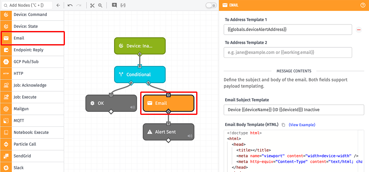

The Email Node has three main configuration sections:
Recipient Addresses
Email Node To Addresses
The Email Node supports up to 5 “To” addresses for the email. These address fields support string templates, to use emails on the current workflow payload. The above node is set to send the email to bob@losant.com and hello@losant.com.
Message Contents
Email Node Message Contents
Next, the contents of the email can be configured. There are three items to configure here, and they are all templatable.
  • From Address: (Optional) The email address that the email will be sent from. Defaults to <theWorkflowID>@workflows.losant.com.
  • Email Subject: (Required) The subject of the email.
  • Email Body: (Required) The email message to send.
Email Node Result
You may optionally store an indication of success or failure of the email operation at a path on the payload.
In the example above, the “From” address is set to alerts@example.com, the subject is set to Power Consumption Warning, and finally the body is set to Power level exceeded error threshold at {{data.power}}!.
If the result path has been configured, the success or failure of the operation will be placed at that path like so:
