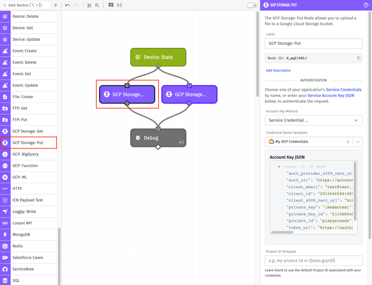

GCP Storage: Put Node
The GCP Storage: Put Node allows a workflow to upload a file into a Google Cloud Storage bucket.
There are several configuration parameters for the GCP Storage: Put Node ...

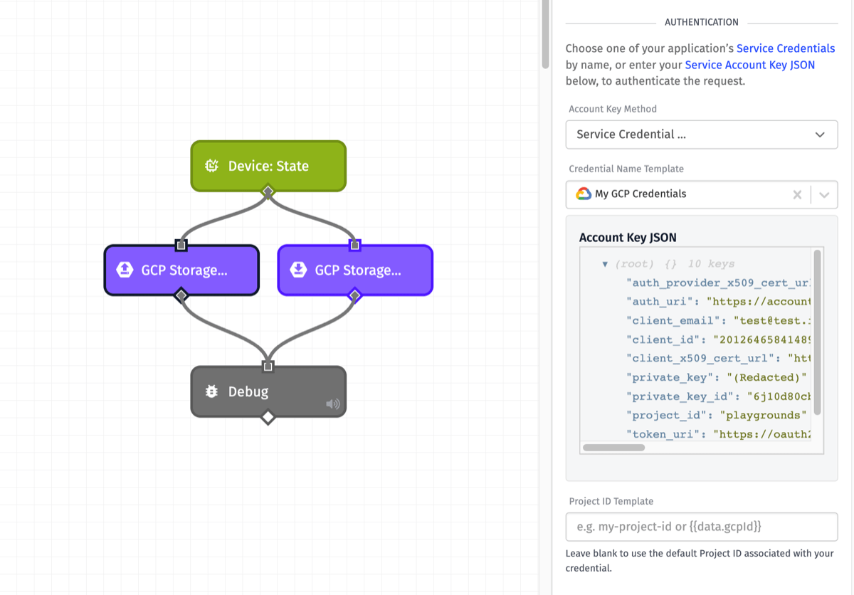

Authentication
First, we must enter our Google Cloud Storage credentials.
Note: We recommend that you create a service account key specifically for use in Losant workflows that has appropriate access to relevant storage buckets.
- Account Key Method: This may be supplied as either a Service Credential, a JSON template, or a payload path. Note: For Edge Workflows, only
Direct Input (JSON Template)andDirect Input (Payload Path)are available; theService Credentialoption is not supported.
The next configuration field will depend on the Account Key Method selected.
If you selected
Service Credentialas your Account Key Method, Credential Name Template can either be a string template that references your Service Credential name or you can select a Service Credential you have created for your application. -
If you selected
Direct Input (JSON Template)as your Account Key Method, Account Key JSON Template can either be a JSON template that references your Google Service Account JSON Key or you may enter it directly. -
If you selected
Direct Input (Payload Path)as your Account Key Method, Account Key Payload Path is a payload path that references a Google Service Account Key that has access to the bucket that will be receiving the upload.
The third configuration field appears for all Account Key Methods.
- Project ID Template: Can either be a string template that references your Project ID, or it can be left blank to use the default Project ID associated with your credential. This option is available for all Account Key Methods. Note: For Edge Workflows, this field is only available in GEA version 1.42.0 or higher.

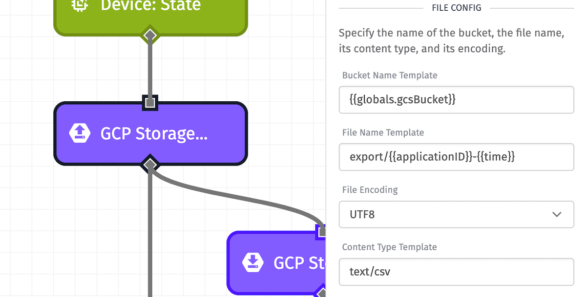

File Configuration
Next, we enter the basic details of the file we will be uploading. All applicable fields are templatable.
- Bucket Name Template: (Required) The name of the bucket that will receive the file upload.
- File Name Template: (Required) The name of the file to upload, including the extension. If you wish to upload the file to a subdirectory within the bucket, the path to the file should be included in this field. (e.g. "path/to/my/file.ext")
- File Encoding: The encoding of the data being uploaded. Defaults to UTF-8.
- Content Type Template: (Required) MIME type of the data being uploaded.

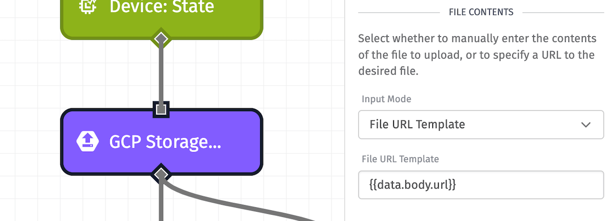

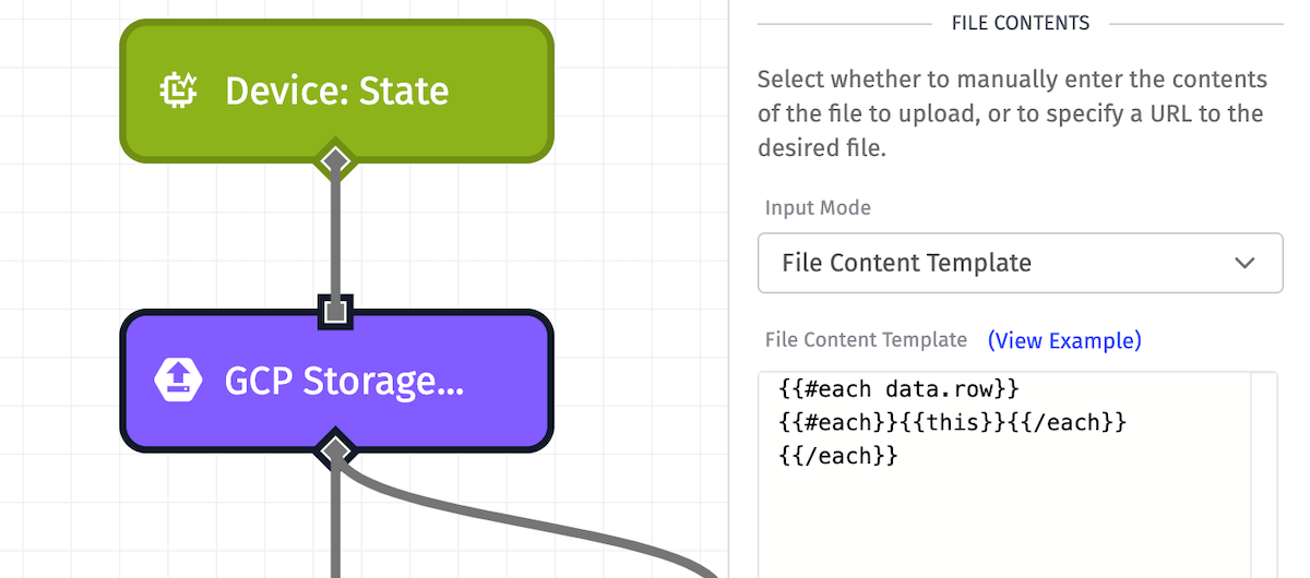

File Contents
Choose an Input Mode for how to provide the content to upload. There are multiple options, each of which supports string templates ...
- File Content Template: If selected, enter the file contents directly. If left blank, your configured file will be uploaded without any content.
- File URL Template: If selected, enter a URL to a resource that is publicly available via an HTTP GET request. Losant will download the file and upload its content to the storage bucket. This option is useful, for example, when using the Temporary URL Output option in a notebook.

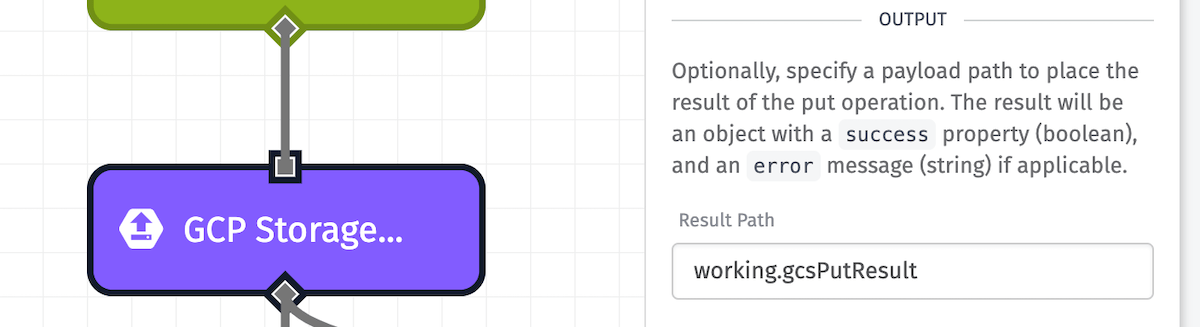

Output
The success or failure of the operation can optionally be placed at the specified payload path. The result is an object with a success property of true or false. In the false case, the result object will also contain an error key, whose value is a string describing the nature of the error.
The following is an example of a successful operation:
"success": true
"success": false,
"error": "Access Denied"
On a timeout, the error value is an object rather than a string:
"success": false,
"type": "NodeTimeout",
"message": "Timeout running Google Cloud Storage: Upload node"
