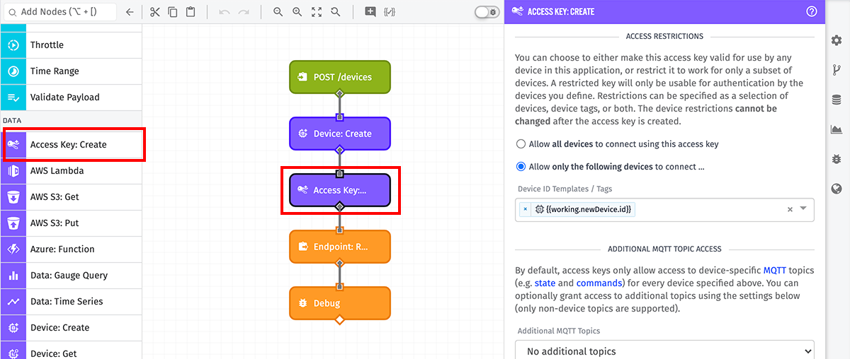

When choosing the "Individual Fields" option, there are a few fields that must be configured.
Key Configuration​
You may optionally provide a Name Template and Description Template for the new Access Key. Both fields support string templates for dynamic values. Neither field is required, and the values do not affect the Access Key's functionality.
You may also optionally set the Access Key's Status to either active (default) or inactive. An inactive Access Key cannot authenticate against the MQTT broker.

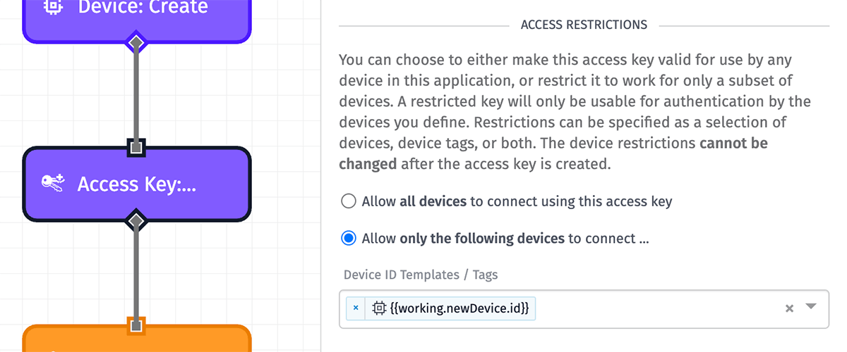

Device Restrictions​
Specify whether all devices may use the new Access Key to authenticate against the MQTT broker, or if only the following devices can use the Access Key (recommended). When selecting the latter option, you must also provide a device query targeting at least one device ID or device tag (or both). The query accepts string templates for defining specific device IDs.
Access Key: Create Node Access Restrictions
Note: An Access Key's access restrictions cannot be changed post-creation; however, if scoping the restrictions to a device tag, devices may gain or lose permission to use the Access Key as their tag values are modified.

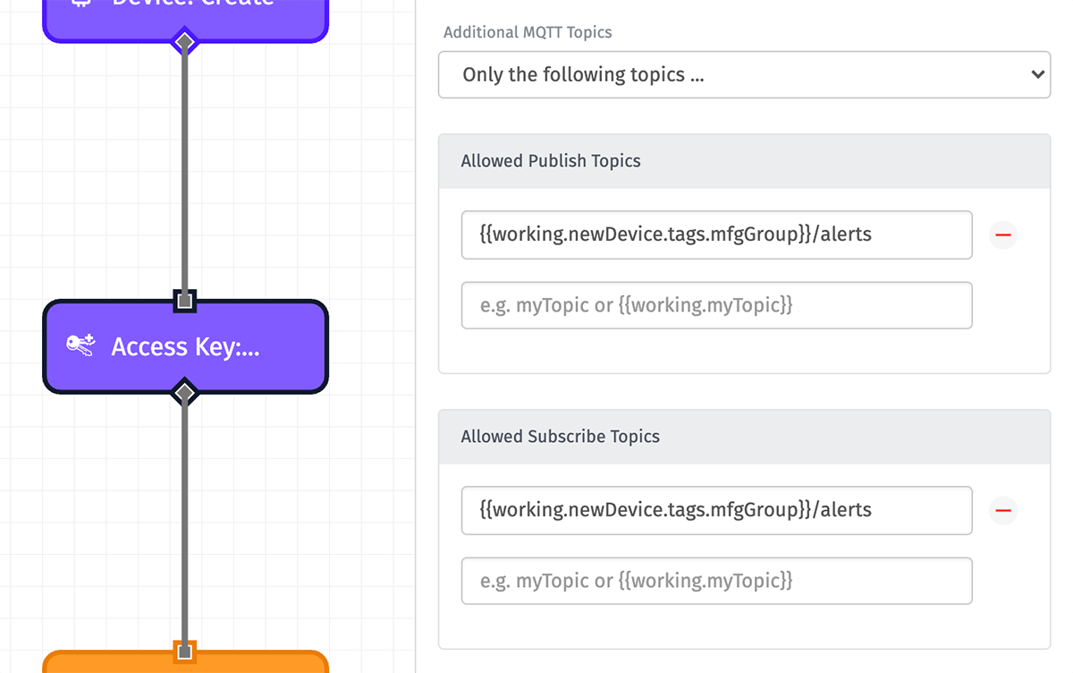

Additional MQTT Topic Access​
Optionally, you may also grant publish/subscribe permissions to additional custom topics for devices connecting to the MQTT broker with the new Access Key.
Access Key: Create Node Additional Topics
From the "Additional MQTT Topics" dropdown, select one of the following options:
  • Allow all additional topics: All devices using this Access Key to publish or subscribe to all custom topics within the application.
  • Do not allow any additional topics: Devices using this Access Key may only publish or subscribe to their own topics.
  • Allow only the following additional topics ...: When selecting this option, you must define at least one topic that devices using the Access Key may publish or subscribe to. You may define multiple topics for each operation, and the topic definitions support string templates.
  • Allow all except the following topics ...: Selecting this option is similar to "Allow only the following additional topics ...", except the listed topics are the only ones the Access Key does not provide access to.
Note: Unlike device restrictions, additional MQTT topic access may be changed post-creation.

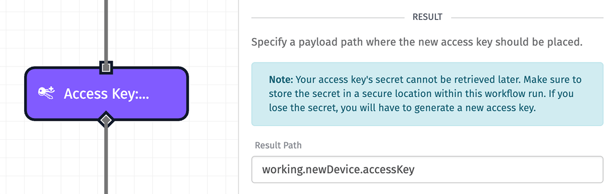

Result​
Finally, define a path on your payload where the new Access Key should be placed. This field is required because the Access Key's secret cannot be retrieved post-creation. Therefore, ensure that your workflow is making use of the Access Key later in its run.
For example, when allowing Experience Users to dynamically register new devices, it is common practice to first create a device using the Device: Create Node, and immediately create a new Access Key restricted to that new device. The Endpoint Reply Node responding to the request should include at least the new device's ID, along with the Access Key's key and secret properties.
Access Key: Create Node Result
If creation of the Access Key fails, the object placed at the specified payload path will instead be an object describing the error.
Given the node configuration in the screenshots above, and an input device with an ID of aaaabbbbccccddddeeeeffff and an mfgGroup tag value of "ABC123", successful Access Key creation placed on the path working.newDevice.accessKey will result in the following object placed at that path:
