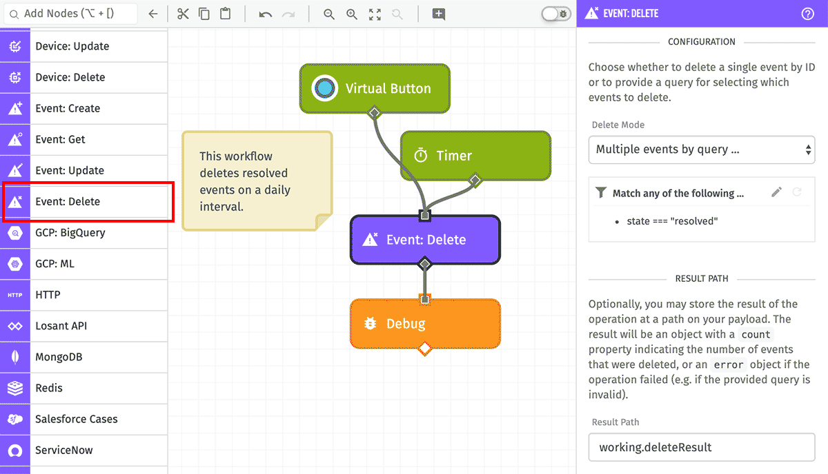

The configuration for the Event: Delete Node requires a query method and parameters to find the Event(s) to delete. First, choose if you would like to delete one event by ID, or multiple Events by query.
Delete One Event by ID​
When choosing "One event by ID ..." as the "Delete Mode", you must provide an ID of one of your application's Events, or more likely, a template that resolves to one of your application's event's IDs.
Delete One Event by Query​
When choosing "One event by query..." you must provide a valid event query to select which Event to delete.
By default, this query returns the most recently created event in a "resolved" state.
Delete Multiple Events By Query​
When choosing "Multiple events by query ...", you must provide a valid event query for selecting which Events to delete. By default, this query returns all Events in a "resolved" state.
Result Path​
Optionally, you may store the result of the operation at a path on your payload.
If the node executed successfully and you set a Result Path in the node's configuration, the following object will be added to your payload at the defined path:
"count": 42, // the number of Events that were deleted
"success": true // always set
