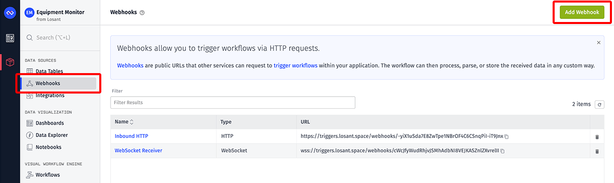

Viewing Webhooks​
You can view your application's webhooks by clicking the Webhooks menu in the main application navigation.
Add Webhook
Click a webhook's name in the list to view its configuration, make edits, or view workflows associated with the webhook.

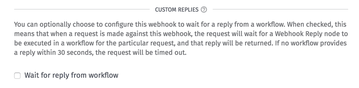

Custom Replies​
By default, Losant automatically replies to HTTP webhook requests with the body { "success" : true } and the status code specified in the Verification section.
If your use case requires a custom reply, this can be done by enabling the Wait for reply from workflow checkbox. When this option is enabled, you must use a Webhook Reply Node within your workflow to provide the desired body, status code, and any reply headers.
Custom Replies
If this option is enabled and your workflow(s) never replies, the request will time out after 60 seconds and Losant will automatically reply with a 504 status code and the following body:
{ "error": "Time out waiting for workflow reply" }
If your workflow(s) reply to the same HTTP webhook request multiple times, the first reply will be used and all subsequent replies are ignored.

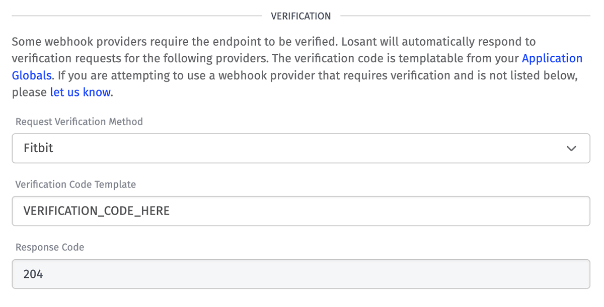

Webhook Verification​
For HTTP webhooks, Losant has built-in request verification for the services described below. These services require a verification process that involves a handshake where the webhook must respond with a specific value in a specific format. If your service requires webhook verification and is not directly supported by Losant, it is possible to implement nearly any verification process in your workflow.
Verification codes are templatable from your application globals.
Fitbit Webhook Verification
In the example above, the webhook is configured for Fitbit verification with the verification code set to VERIFICATION_CODE_HERE. The 204 response code cannot be changed since that's the required code for the verification process.

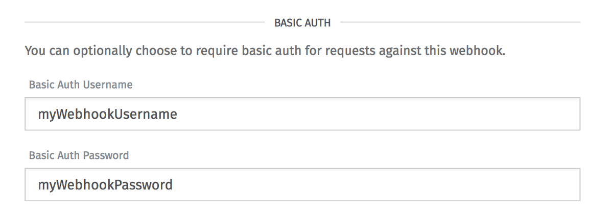

Basic Authentication​
For both HTTP and WebSocket webhooks, you may optionally choose to require HTTP basic authentication. For non-verified webhooks, adding basic authentication is the recommended way for securing access.
The username and password fields support templating from your application globals.
Webhook Basic Auth
When the basic authentication fields are left blank, no authentication is required to invoke this webhook. If either a username or password value is provided, then a standard basic Authorization HTTP header must be set on all incoming webhook requests. Configuring only a username or only a password is supported, in which case Losant expects the other field to be an empty string on incoming requests.

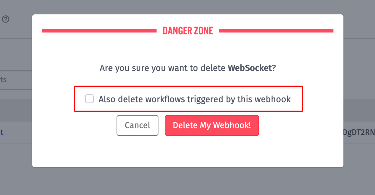

Deleting a Webhook​
Webhooks can be deleted by clicking the Delete icon on the webhook list or by clicking the Delete Webhook button on the details screen.
Delete Webhook
When deleting a webhook, you also have the option to delete any workflows triggered by the webhook. This action deletes any workflow with a Webhook Trigger matching this webhook. If you wish to save your workflows and change out their triggers, or if the workflows are triggered by multiple conditions and you wish to retain them, you should leave this option unchecked.
