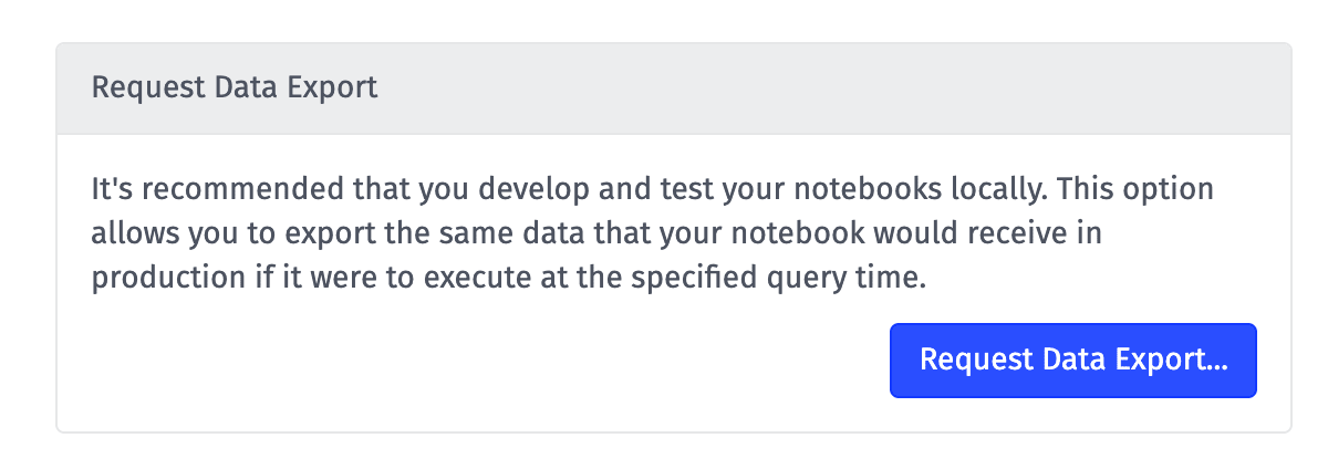

Data Export
Once you have configured your inputs, the next step is to export a set of sample data from those inputs.
Links to these files will be emailed to an address of your choosing; then, you can download the sample data for use when building your notebook.

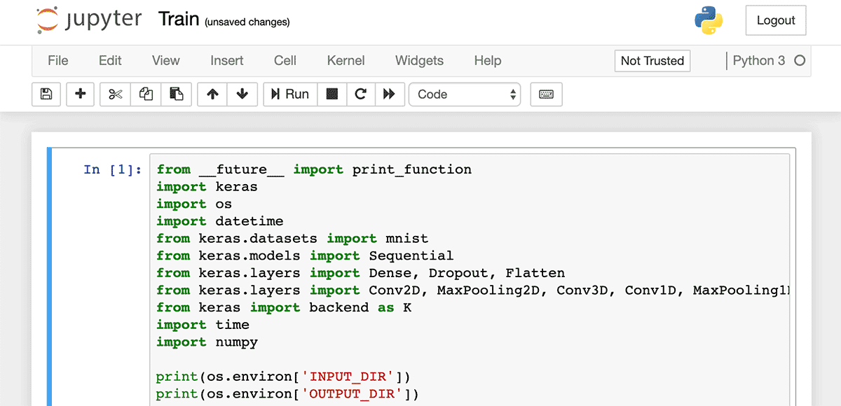

Develop Locally
Next, given your sample data, you can write your notebook’s code in your local environment.
Once you are happy with the results, you can replace the references to the sample data with references to the input files as they’ll be written to disk during a notebook execution.

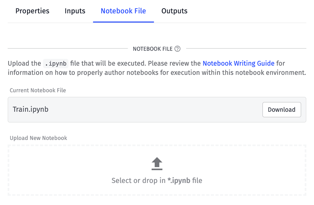

Notebook File
Take your completed .ipynb
file and upload it to your application’s notebook.
This is the file that will run in the cloud environment against your input data. From this tab you can always download your current file, make changes and upload a new version.

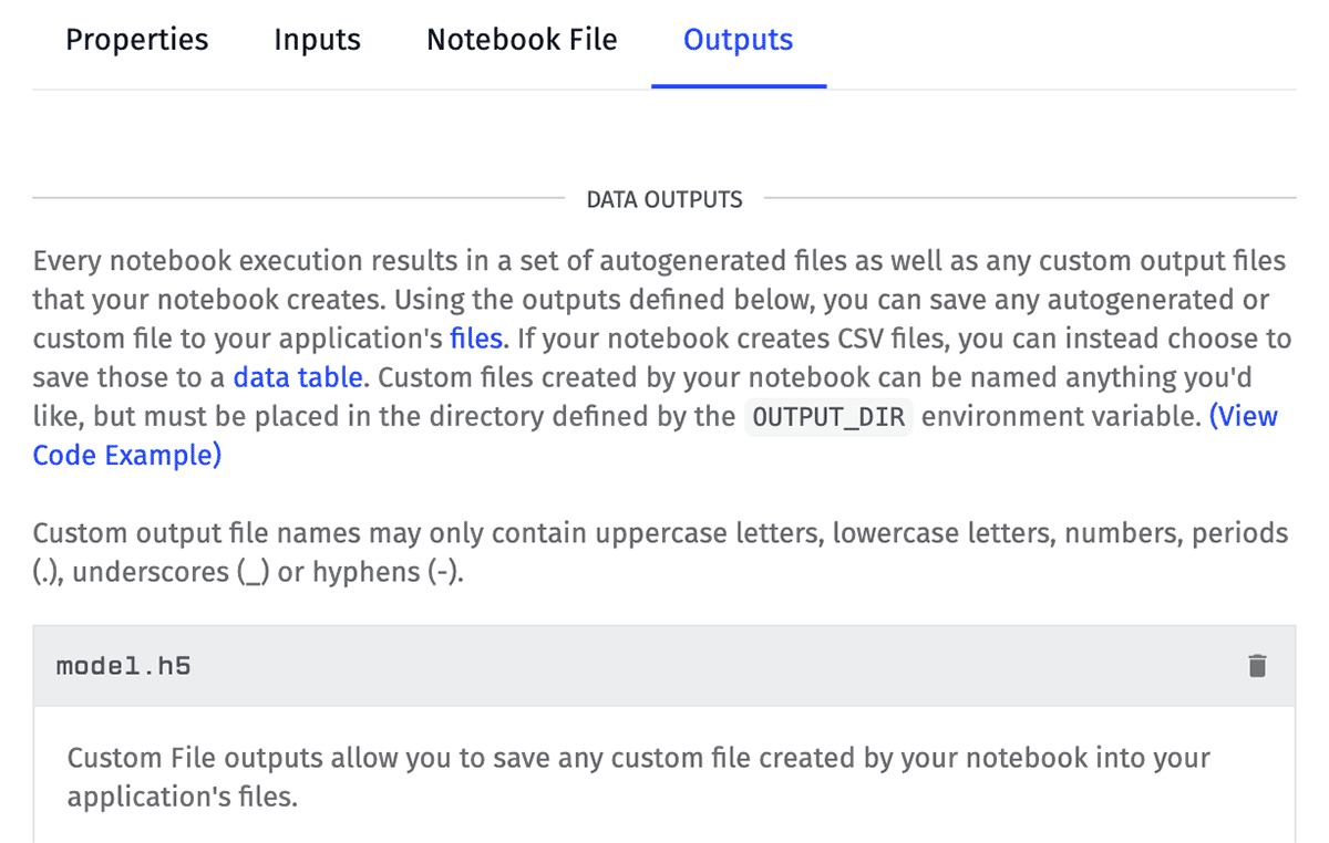

Output
Finally, decide what to do with the output of your notebook execution. All notebook runs generate a handful of output files automatically, and depending on the content of your notebook file, they may generate many more in a variety of file formats.
Decide what to do with these files (if anything) by directing them to your application’s file storage or into a data table.

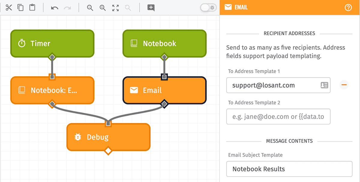

Notebook: Execute Node
To automate the running of notebooks against your application data, you can use the Notebook: Execute Node to start a notebook execution via a workflow. In most cases, this node will be connected to a Timer Trigger configured with a cron string to run the notebook on a regular schedule (e.g. “every Monday at 9:00am”).
The workflow will not await the execution of the notebook before proceeding to the next node(s) connected to the Notebook: Execute Node. Instead, the node will queue the notebook for execution and will fire any Notebook Triggers configured to run when executions of the chosen notebook have completed or errored. Most users will use the Email Node in conjunction with this trigger to send the execution’s outputs to an address of their choosing.

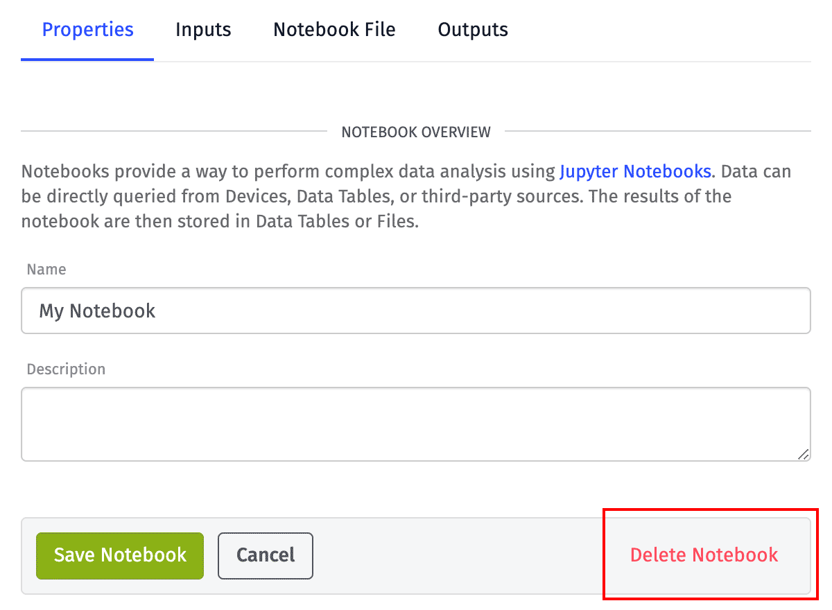

Deleting a Notebook
To delete a notebook, click the “Delete Notebook” link at the bottom of the notebook’s “Properties” tab.
Deleting a notebook will cause any executions of the notebook (via workflows) to fail. The execution logs — along with links to any output files within those execution logs — will no longer be accessible.
However, deleting a notebook will not delete any files that were generated by that notebook and saved to your application files, nor will it affect any data tables or rows generated by the notebook’s previous executions.
