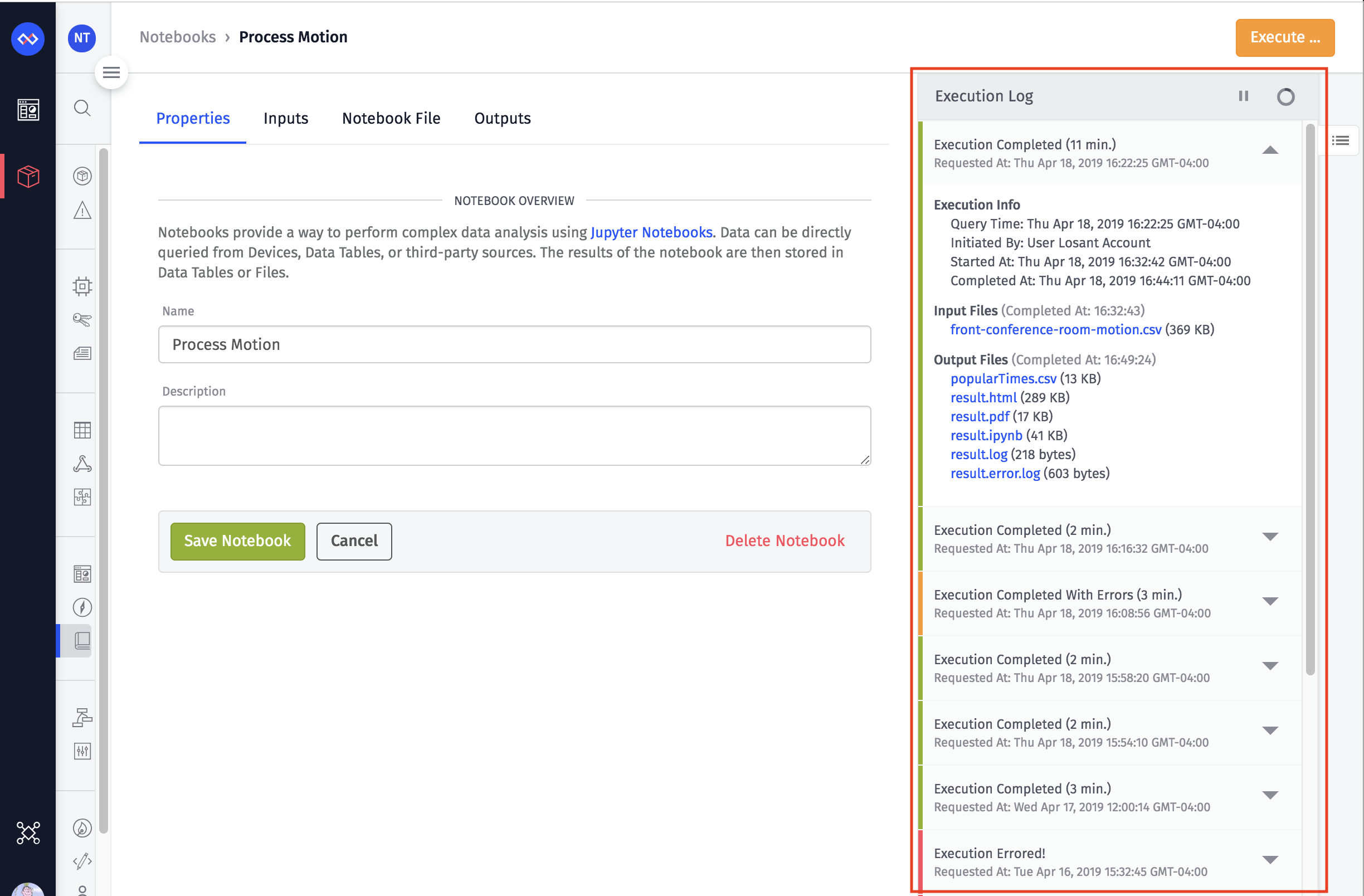

Notebook Execution Log
Unlike the Application Log or Device Log which only display data while the user is on the page, a notebook’s Execution Log collects and persists data related to each time the notebook is run even while the user is not on the page. The Execution Log will display the last 25 entries that are no older than 30 days.

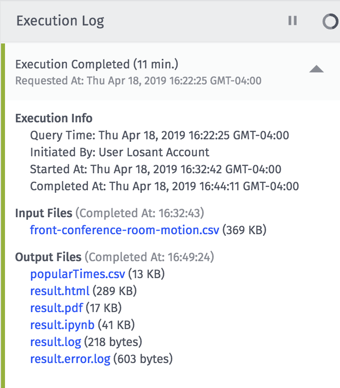

Execution Success
If your notebook is successfully executed, you’ll see a “Execution Completed” message that looks like so:
Successful Execution Log
On successful execution, the following fields are reported:
  • Query Time: The anchor point against which any device data datasets are built.
  • Initiated By: The user or workflow that started the notebook’s execution.
  • Started At: The time the notebook started executing.
  • Completed At: The time the notebook finished processing.
  • Input Files: Any external inputs included in the notebook’s execution.
  • Output Files: The output files created from the notebook’s execution. Directory output files will be packaged as a single Tar File. The files will remain accessible for up to 7 days after the execution has completed.

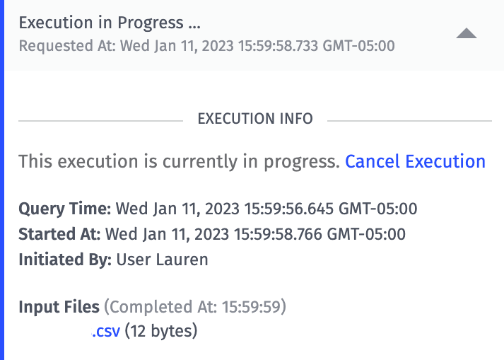

Execution Processing
If a notebook is executing, it will be displayed in the execution log along with the requested time, query time, and user or workflow that initiated its execution.

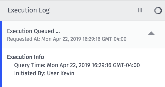

Execution Queued
If a notebook is queued for execution, it will display it’s status as “Execution Queued”.
