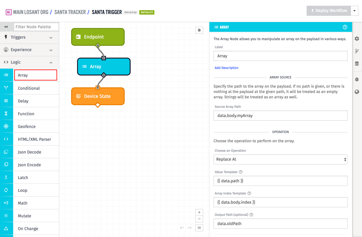

Array Node
The Array Node allows a workflow to perform operations against an Array on the payload.
Array Node

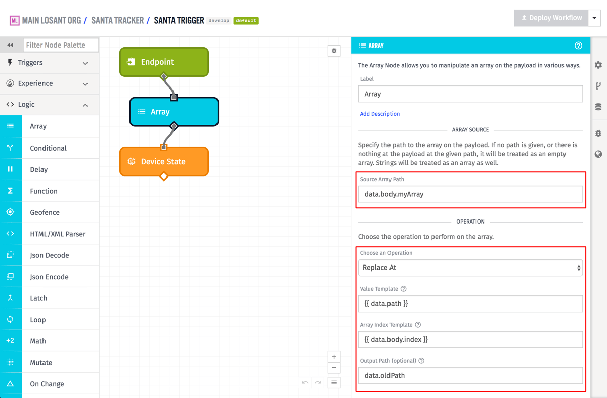

Array Source
The Source Array Path is the location on the payload at which the node will look for an array. If there is not an array at the given payload path, an empty one will be created at that path. If the given payload path is a string, the string will be treated as an array of characters for the array operation, but will remain a string on the payload.
If the operation modifies the original array, you can specify a destination path where the altered array will be stored.
Array Node Configuration
Operation
Once you have configured the array that the node will operate on, then you can choose and configure one of the following operations to perform.
