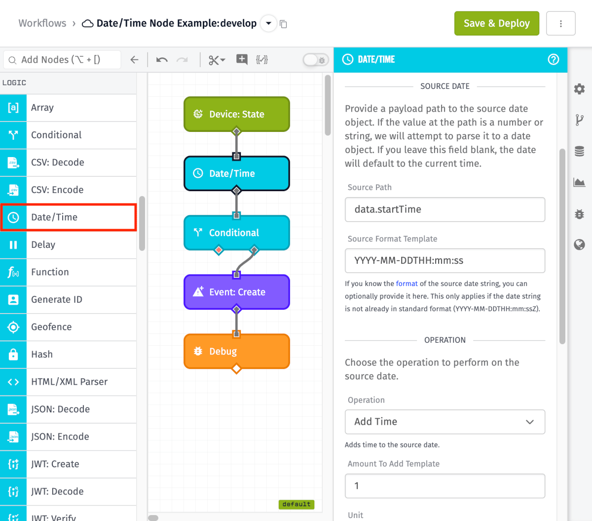

In order to use the Date/Time Node, you'll need to provide an optional source date, specify an operation to perform on that date, and then determine where on the payload you'd like to store the result.

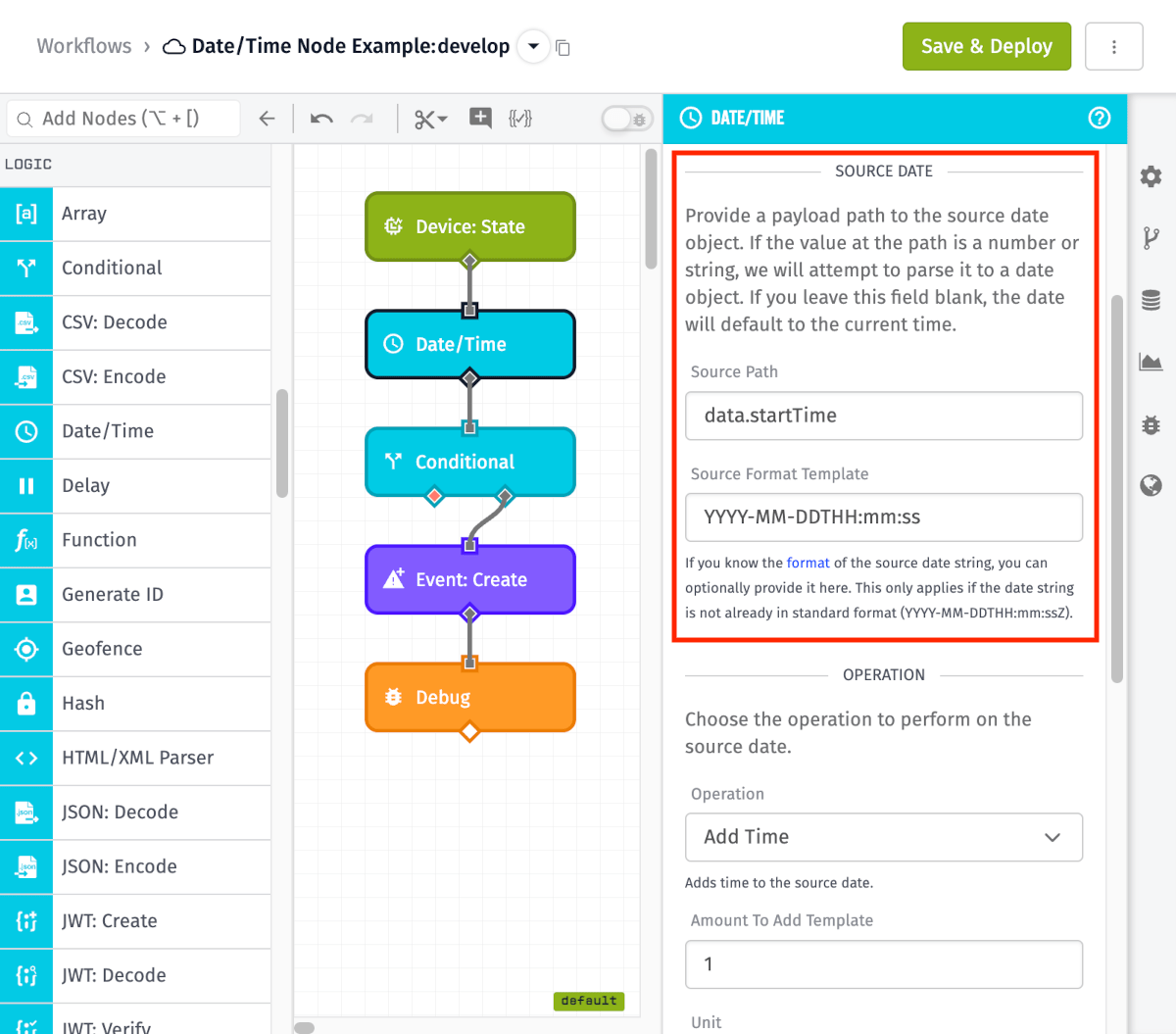

Source Date​
The Source Date section of the Date/Time Node includes fields that allow you to retrieve the data from the current payload for the date or time you'd like to manipulate.
Date/Time Node Source Date
  • Source Path: You may optionally include a payload path that points to a valid date object on the current payload. If you leave this field empty, the source time will default to the current time.
  • Source Format Template - If you know the format of the source date, you may optionally provide that here as well (unless the date is in standard format - YYYY-MM-DDTHH:mm:ssZ - in which case this step is not necessary). This may also be a string template that references the format you are specifying. If you leave "Source Path" empty, you do not need to fill out this field.

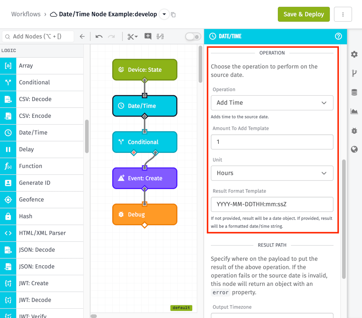

Operation​
The operation section provides varying fields that depend on the operation you choose from the dropdown. The available operations you are able to perform are outlined in the Operations section below.
Date/Time Node Operation

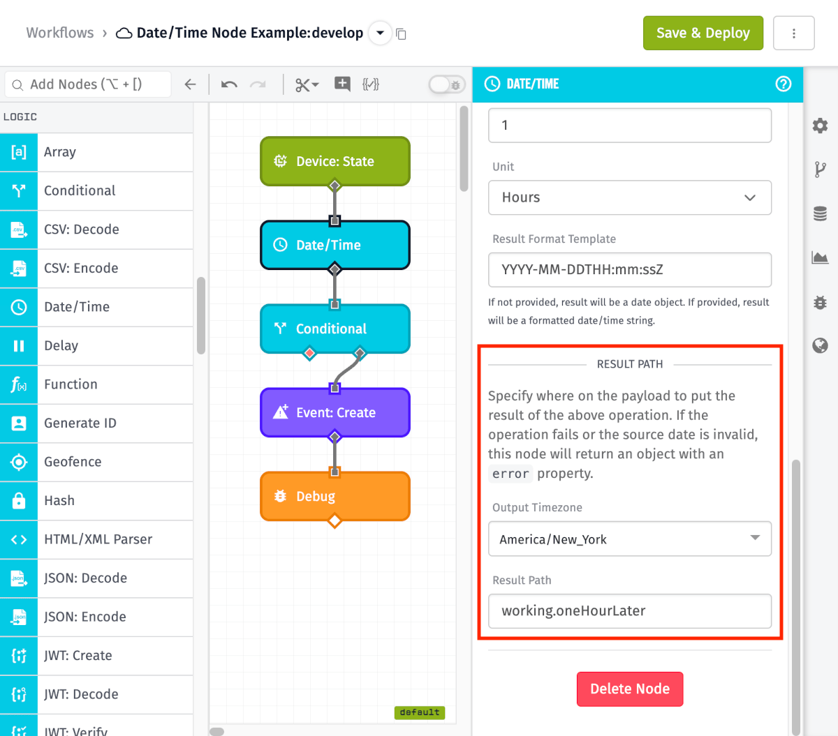

Result Path​
The Result Path section defines where you'd like to store the result of the operation.
Date/Time Node Result Path
  • Output Timezone: This field will convert the result of the above operation into the selected timezone. The default selection is based on the timezone set in your browser settings. Note that if the source time doesn't specify a timezone or GMT offset, or if the Source Path field was left blank, it will be considered GMT (UTC) time before evaluating this field.
  • Result Path: You must include a payload path on which to store your result.

Add Time​
Adds time to the source date.
  • Amount To Add Template: The numerical value to add to the source date object, or a valid string template that references it.
  • Unit: The unit of time to describe the value passed above.1
