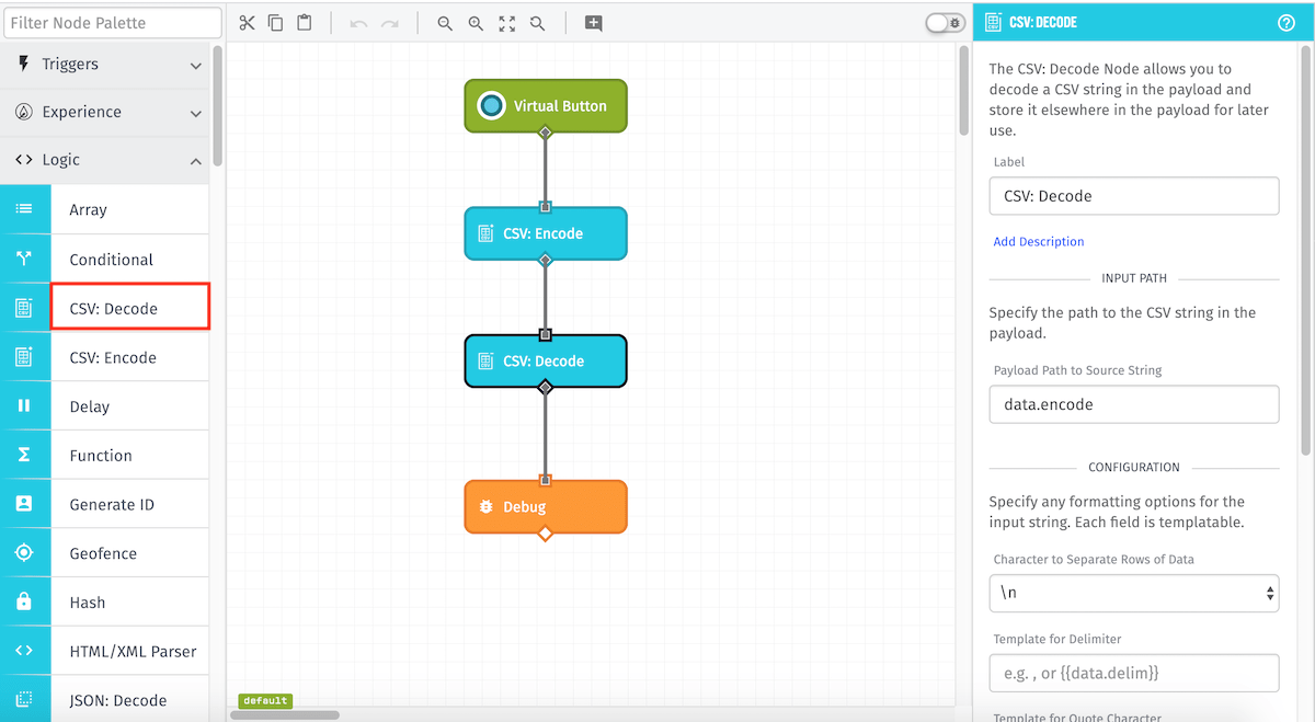

The CSV Decode Node allows a workflow to decode a CSV string on the payload into an object array.
CSV Decode Node
There are three main parts to the configuration of this node…

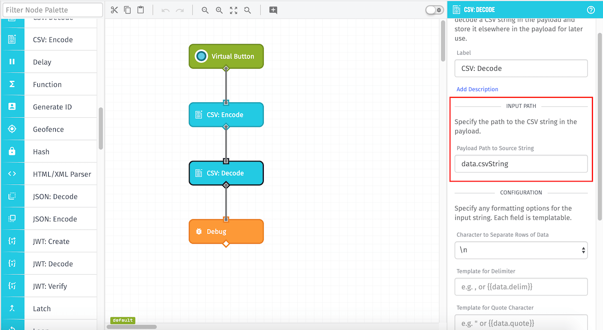

Input Path
This required field specifies the payload path where the CSV string to be decoded is located.
CSV Decode Node Input

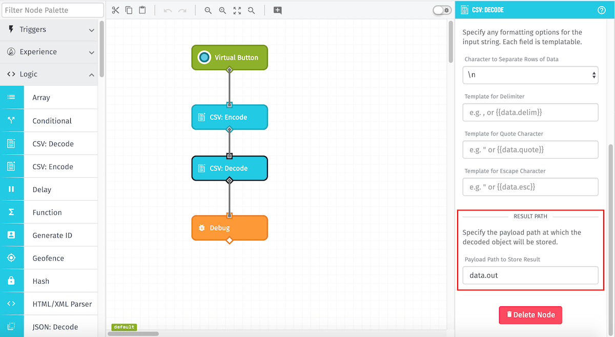

This required field specifies the payload path where the decoded object array will be placed.
CSV Decode Node Result
In this particular instance, the workflow will decode the CSV string at the data.csvString path and place the resulting array of objects at data.out.

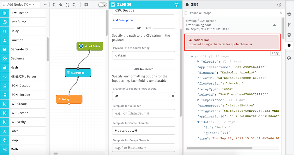

    "message": "Invalid opening quote at line 1"
Templates and paths which evaluate to invalid input will still error the workflow like so:
CSV Decode Node Error
