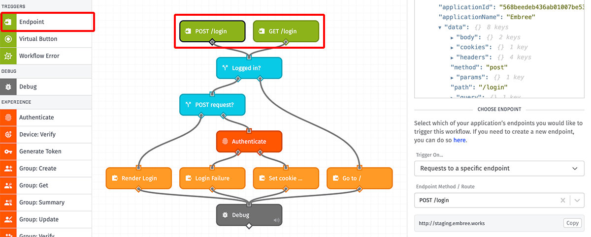

In Experience Workflows, first choose the circumstances under which this trigger should fire. Two options are available ...
Requests to a specific endpoint​
For most uses of the trigger, this is the preferred option as it allows for processing data in expected formats and issuing replies to the requests. When selected, you must provide an Endpoint Method / Route, which is the Experience Endpoint whose received requests should fire the trigger.
The trigger will only fire on a request to an endpoint in the same Experience Version as the workflow. This means that a request to your 'develop' domain's POST /login endpoint will only fire the develop version of the workflow, not an experience version that also contains a POST /login endpoint and a workflow version containing this trigger.
In the above example, the workflow will be triggered whenever the "POST /login" endpoint receives a request.
