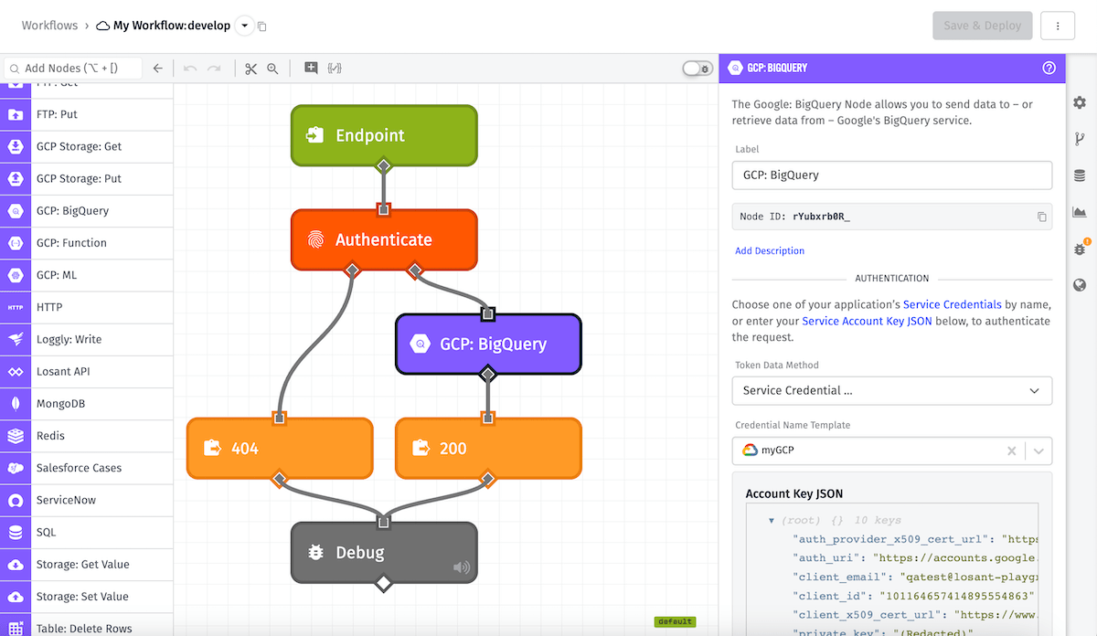

Configuration for the node is broken up into four sections.
Service Account Auth Token
A service account auth token is required for the workflow to authenticate with Google BigQuery. You may enter this token one of two ways:

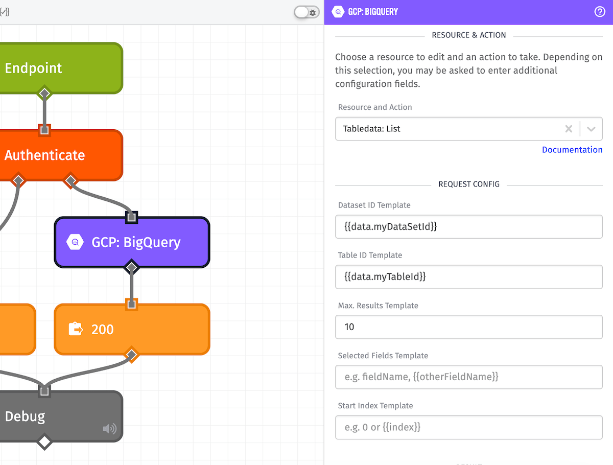

Request Config
The available options here will change depending on the selected resource and action. For example, if the selected action creates or updates a resource then a request body is required that contains the new or updated resource. Some actions require a dataset ID, some require both a dataset ID and a table ID, and some require neither. There are also some options that are only relevant to a specific resource and action, such as the “include hidden datasets” option when “Datasets: List” is selected.
Example request config
In the example above, the selected resource and action value is “Tabledata: List” and the relevant configuration is being shown.
