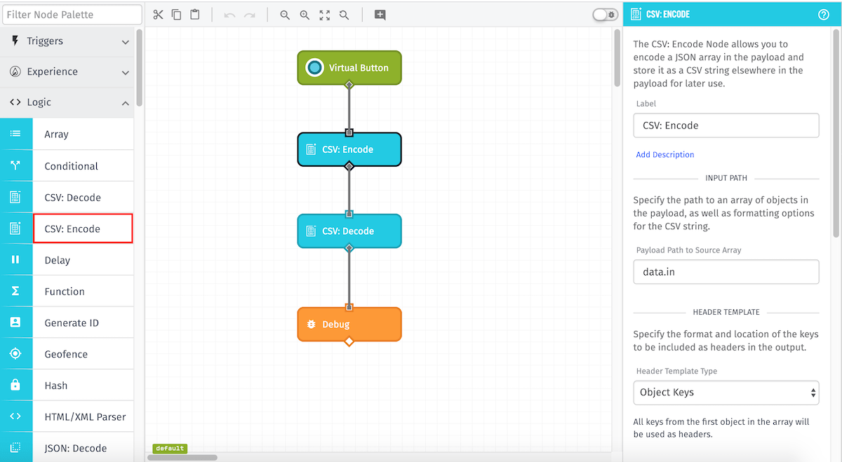

The CSV Encode Node allows a workflow to encode an object array on the payload into a CSV string.
There are four main parts to the configuration of this node…

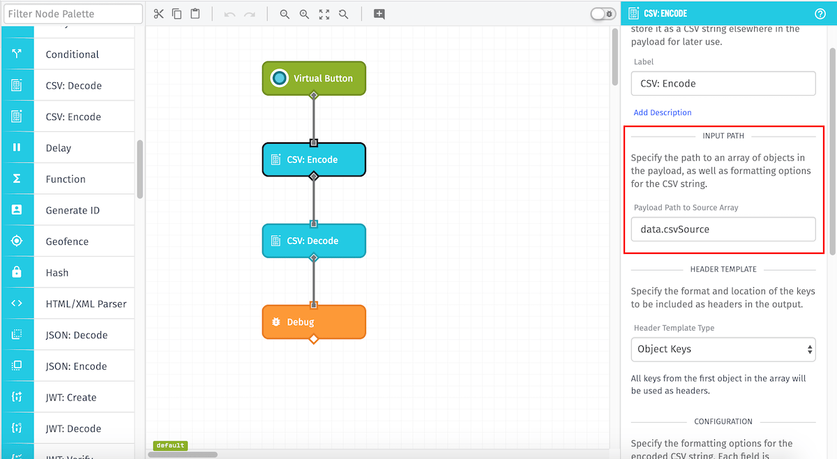

Input Path
This required field specifies the payload path where the object array to be encoded is located.

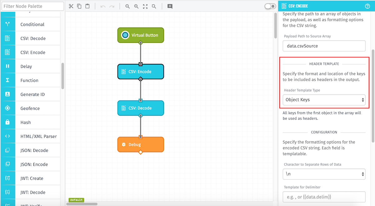

CSV Headers
There are three different ways to control the headers of the encoded CSV string - “Object Keys”, “Individual Fields”, and “Payload Path”. The last two settings allow you to customize what headers will appear in the output CSV string, while the first setting is a simpler default.
Note: This setting will only exclude or repeat headers. It will not replace or rename any headers from the input objects.
- Object Keys: The default option. The CSV Encode Node will read all the keys of the first given object and include all of them as headers for the encoded CSV string.
- Individual Fields: Provide up to 10 string templates that will each be included as a header. Any object keys not included here will be excluded from the output.
- Payload Path: Specify a payload path that contains an array of headers to include. Any object keys not included in the array will be excluded from the output.

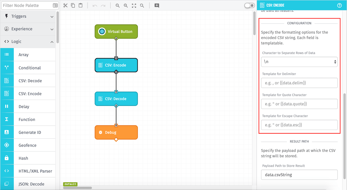

Format Configuration
This section contains four fields that specify the format for the encoded CSV string:
- Record Delimiter: (Optional) This is the character used to separate rows of data. Default \n.
- Delimiter: (Optional) A string template to override the delimiter. This character is used to separate columns of data. Must be a single character. Leave blank to default to comma (,).

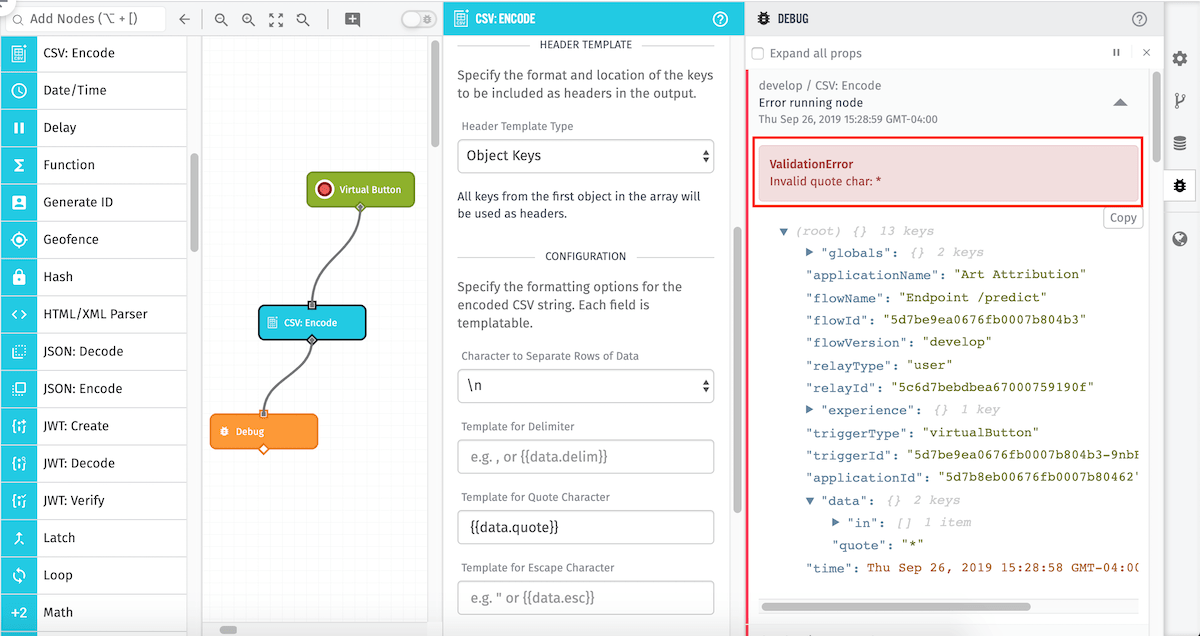

- Quote: (Optional) A string template to override the quote character. Must be a single character. Leave blank to default to double-quote (”).
- Escape: (Optional) A string template to override the escape character. Must be a single character. Leave blank to default to double-quote (”).

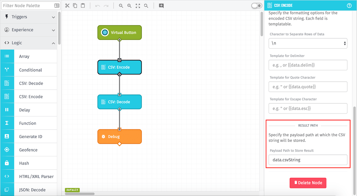

This required field specifies the payload path where the encoded CSV string will be placed.
In this particular instance, the workflow will encode the object array at the data.in
path and place the resulting CSV string at data.csvString

Templates and paths which evaluate to invalid input will still error the workflow like so:
